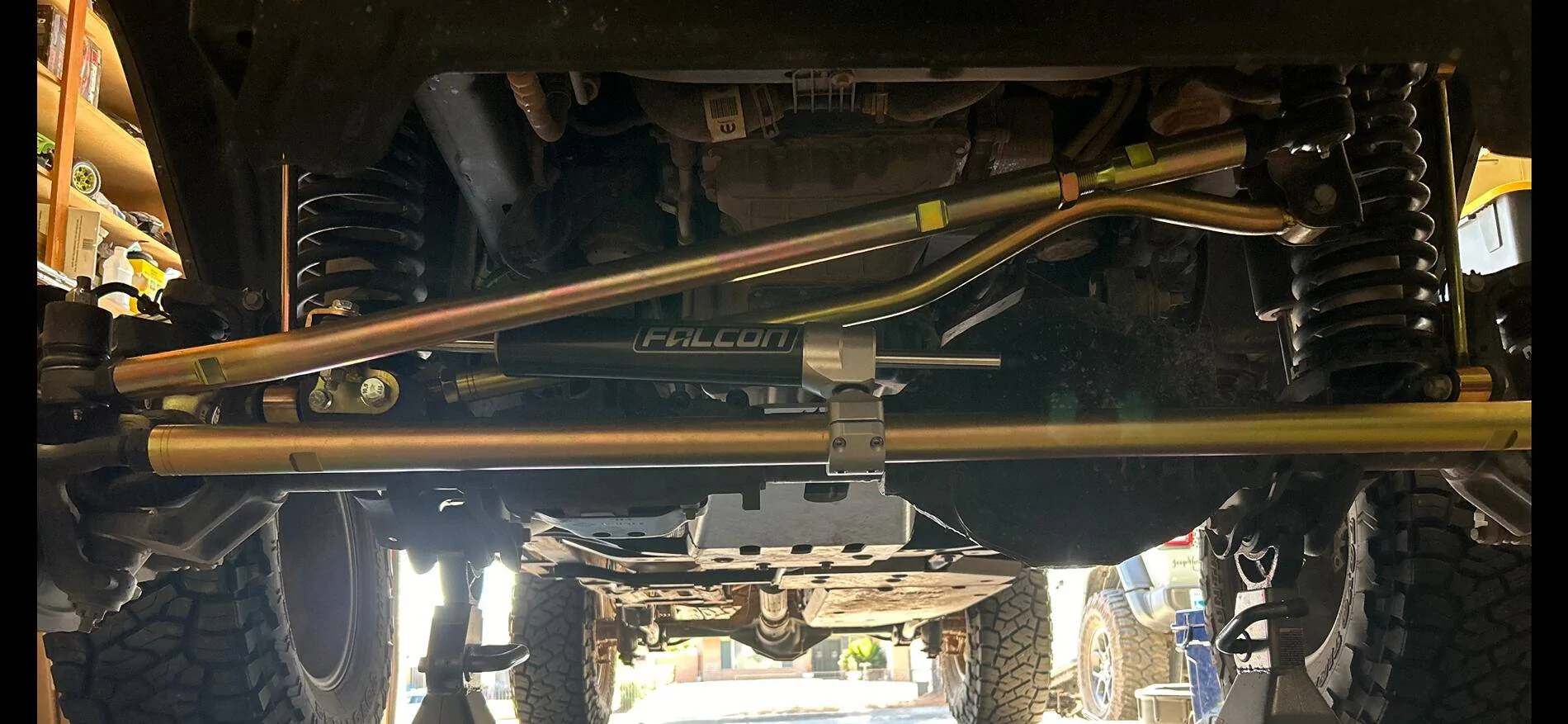

Try a different mounting bracket. I’m sure someone makes one. There are several options for the Falcon including other companies. I have Metalcloak on one end, and Teraflex on the other end. I would not change a thing.

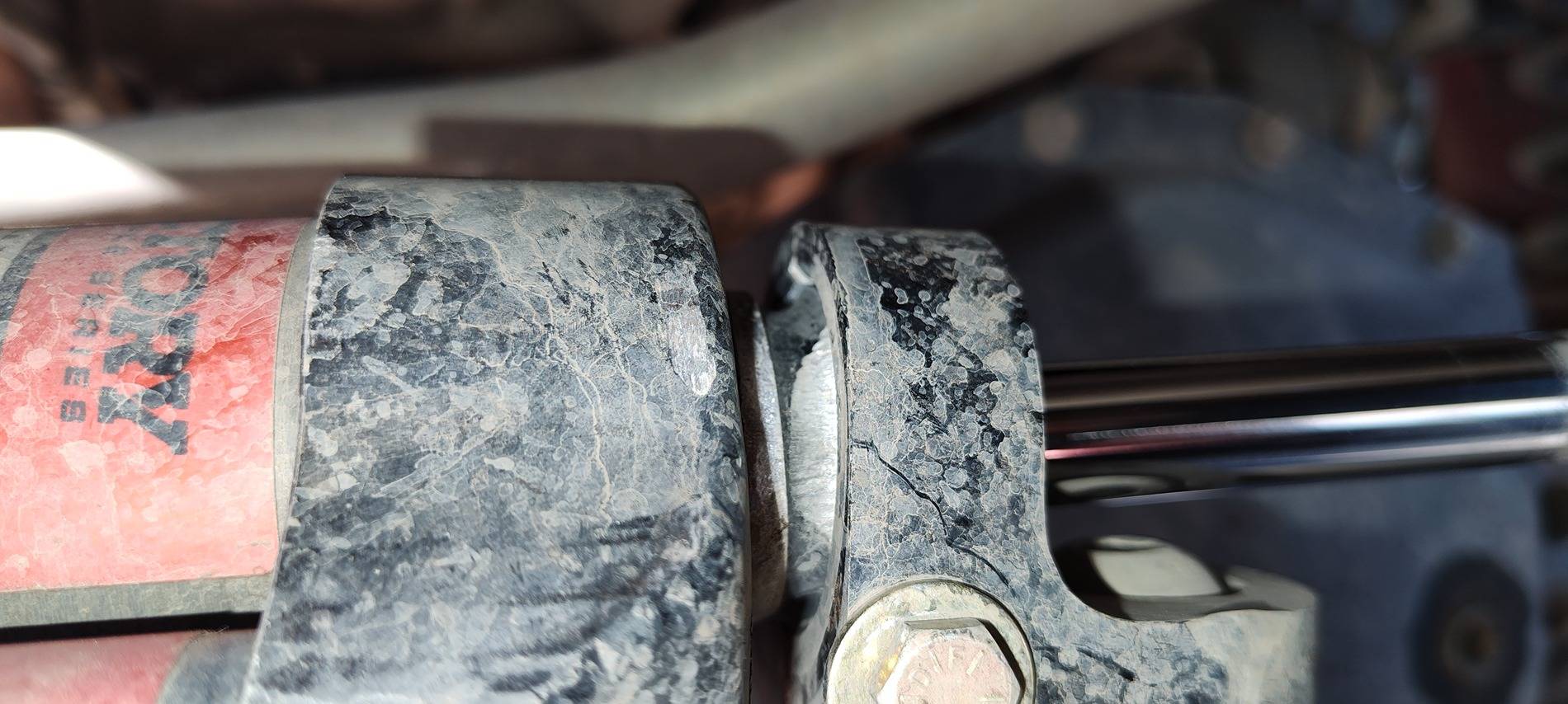

Here is a pic of the issue. The bracket that mounts to the steering shaft is shot where it clamps onto the steering stabilizer. I'm looking for different options because I can't see spending $450 for another fox stabilizer when I'm sure tis will happen again in a few years.

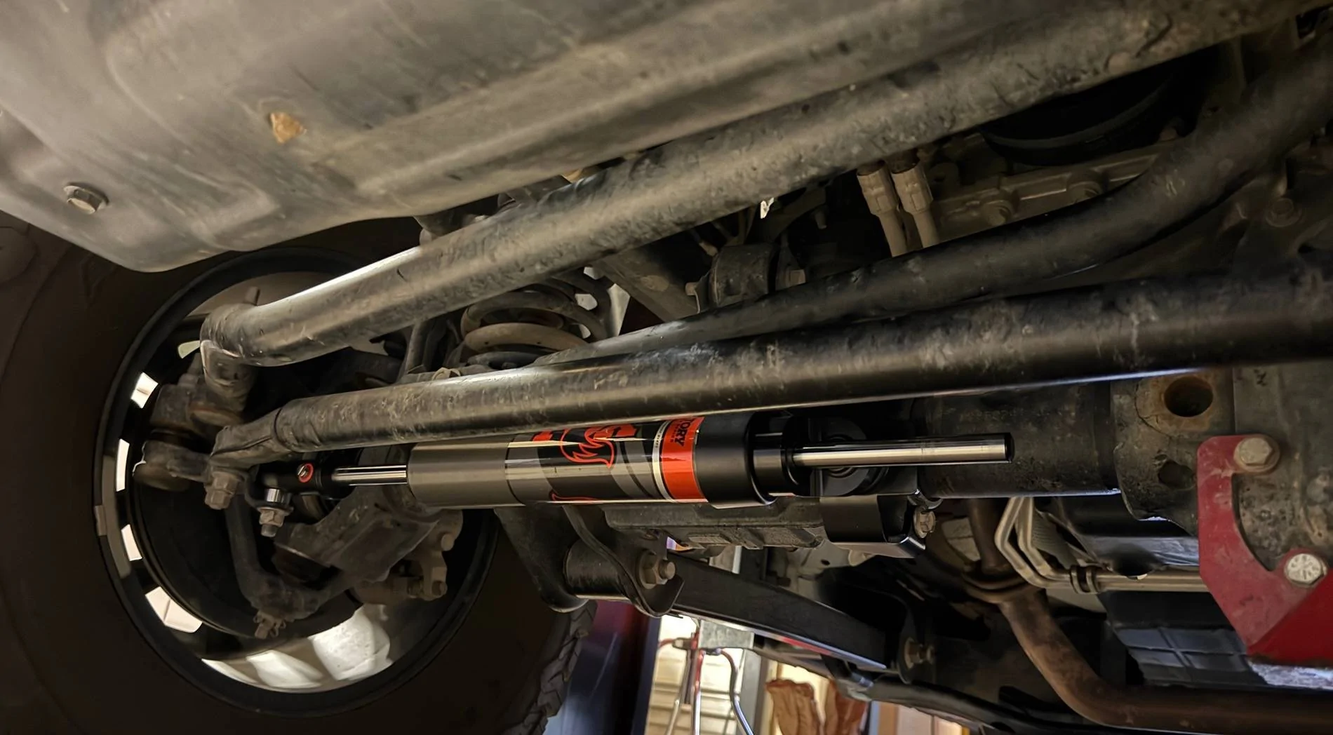

Installed the fox ats and can already tell a difference. Feels more stable when going over bumps.
Been using it on the 12 clicks setting. The manual says 5 clicks is stock. It feels firmer steering. Will see how it holds up at hot springs off-road park next week.
Not sure how op stripped out the little hex bolt head. That pitch clamp is only used to keep the reservoir from rotating. Shouldn’t need to be super tight.
