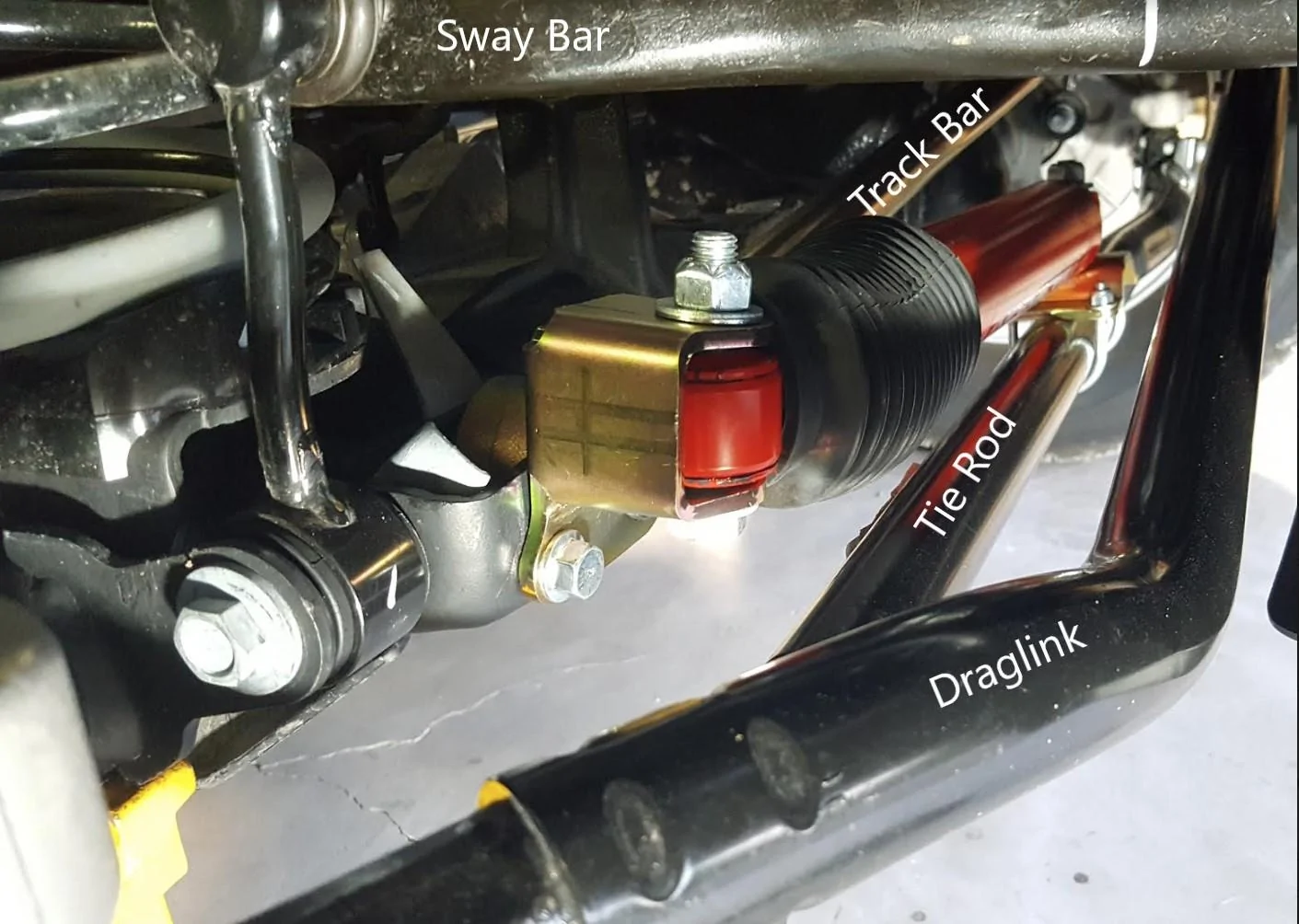

If your gonna go off road you need to get one you can relocate. That means the Falcons are a no go for me until they can be relocated and even then I wouldn't spend more than $200 including relocation bracket.
I'm not all that off road experienced yet. Can you expand on this?
gpurp
Dave
Aug 18, 2019
82
73
North Texas
19' JL Sport 2dr
The stock mounts put the stabilizer lower than it should be. Take a look and you'll see that it's at the same level as your tie rod. I have the Metal Cloak relocation bracket that bolts to the axle trackbar mount. My stabilizer now sits above the tie rod where it's less likely to be damaged.
STLYoungblood
May 21, 2018
131
171
St. Louis, MO
2018 Wrangler JLU Sport S Ocean Blue
Thanks. That being said, if we're at the same height as tie rod, which feels pretty low anyway, the stabilizer may be more likely to be damaged than if relocated, but if you were damaging the stabilizer, even if it wasn't there, you'd be hitting your tie rod, right? Am I missing something, or is it more about mitigating as much damage as possible?
gpurp
Dave
Aug 18, 2019
82
73
North Texas
19' JL Sport 2dr
There's a lot of linkage under the front end no doubt that can snag on obstructions. I'd say the best way to mitigate damage is increasing the tire size for added height, Installing skid plates, and not going too fast. There's a lot of emphasis in the forums on rock crawling but in my neck of the woods I'm much more likely to hit a tree stump hidden by tall grass. So back to the stabilizer... Being that's it a mostly hollow thin walled metal tube I say moving it up lessens the likelihood of damage. This pic is from the passenger side.
