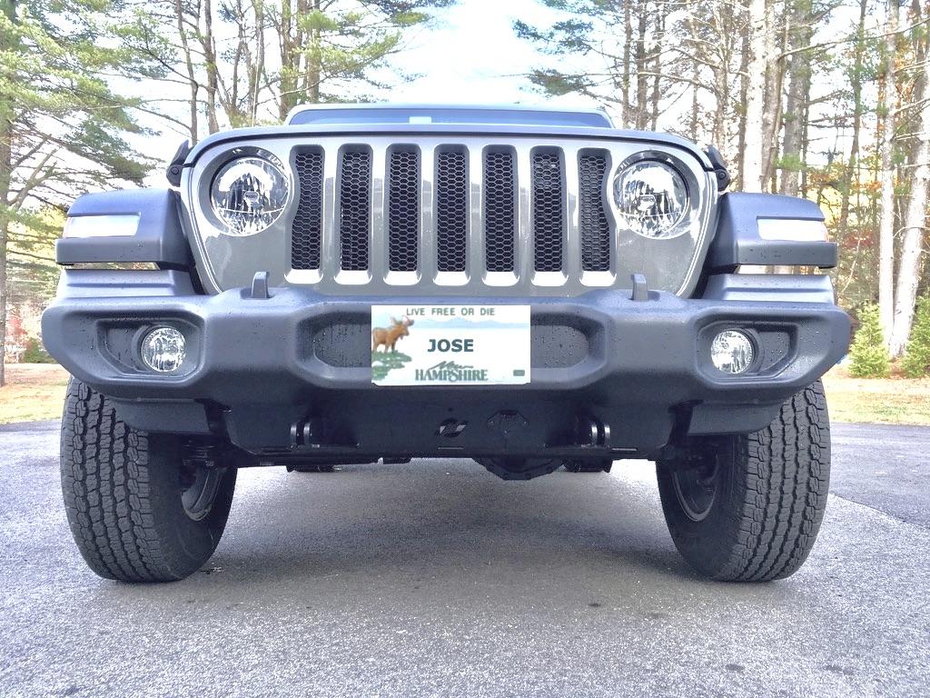

I wonder what it looks like from the front? Does it sit below the bumper and thus is exposed to getting bashed on rocks if/when you hit the trail?

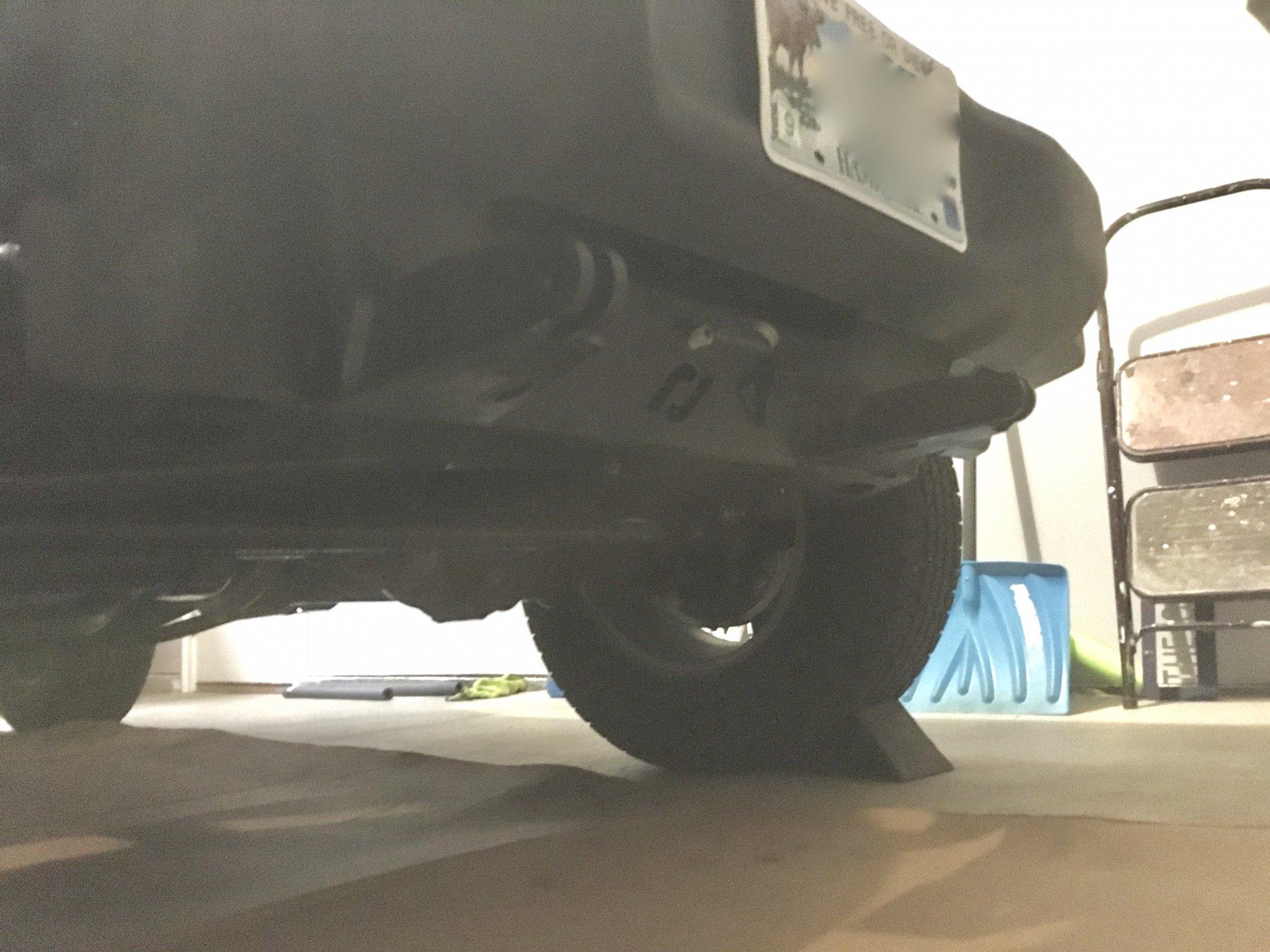

Just installed last week. I had a Rockjock on my JK and it worked great. It's a lot easier to install on the JL. You do need to remove the bumper but that's not really a big deal, just a lot of nuts to take off. The towplate attaches to the back of the bumper first with two existing bolts in the bumper then it's put back against the frame. 8 bolts hold the towplate to the frame of the JL with the 4 additional bolts on the lower part of the horns. I think all they really do is keep the bottom of the towplate from torquing forward under tension. The steel plate part of the towplate is really thick, (I didn't measure it but I'll guesstimate 3/16 or 1/4" thick) and that by itself gives a lot of lateral support. Rockjock builds suspension components for off road use, they built the towplate to the same standard. One of the things I didn't like about the Maximus loops is that there's nothing in between the frame horns like on the Rockjock so I'd be worried about lateral forces causing a problem without adding some type of crosspiece to stiffen the whole thing.
Jeep Wrangler JL Best Setup for RV Flat Tow IMG_8220
Look at my post above replying to Ken, it's a head on photo. The attachment points sit flush with the front of the bumper. Here's an angled photo - terrible photo but you'll get the idea.
