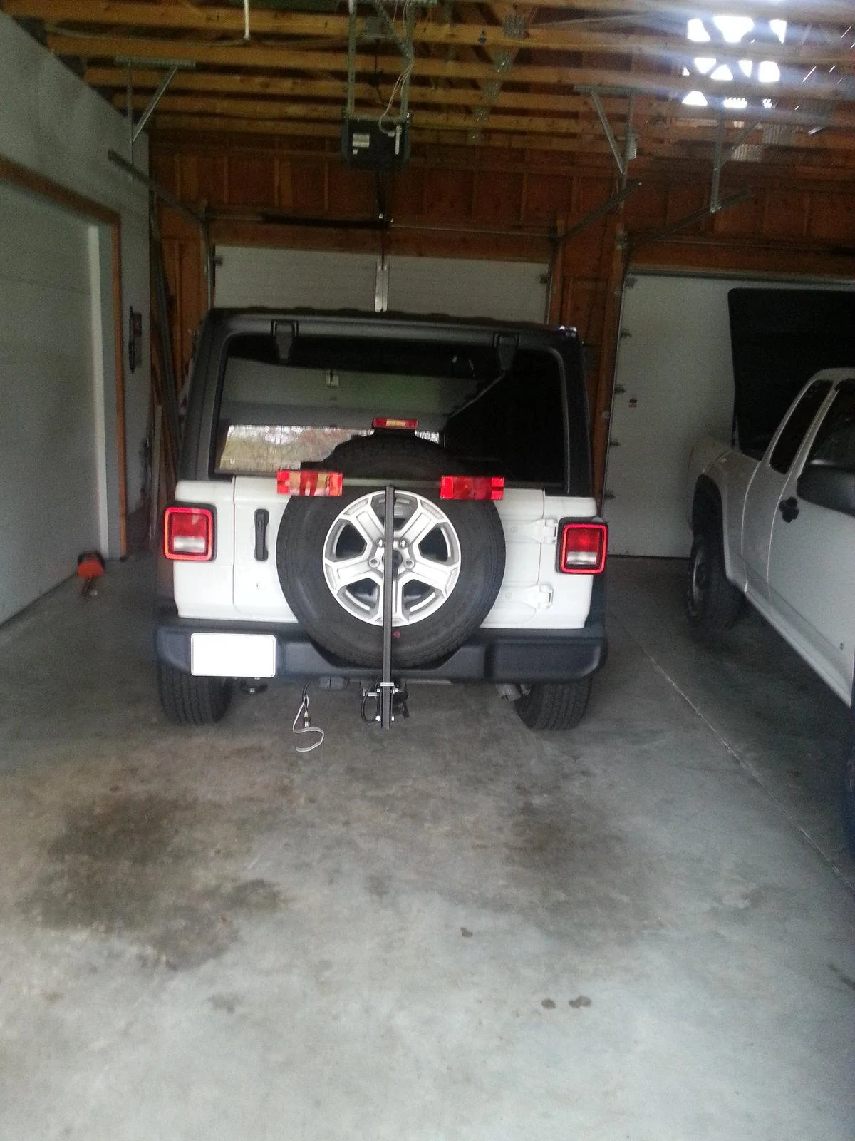

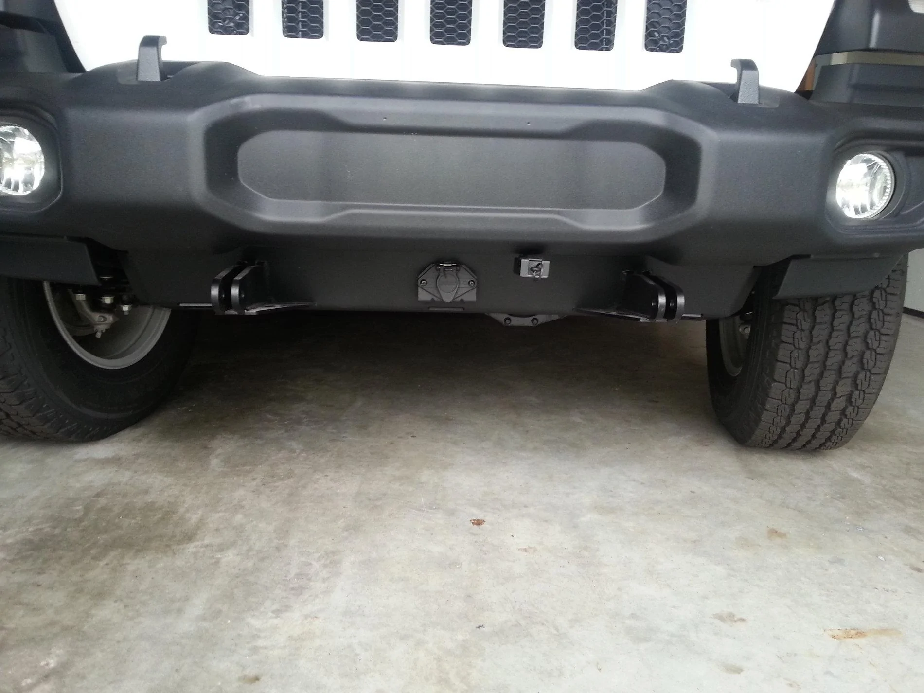

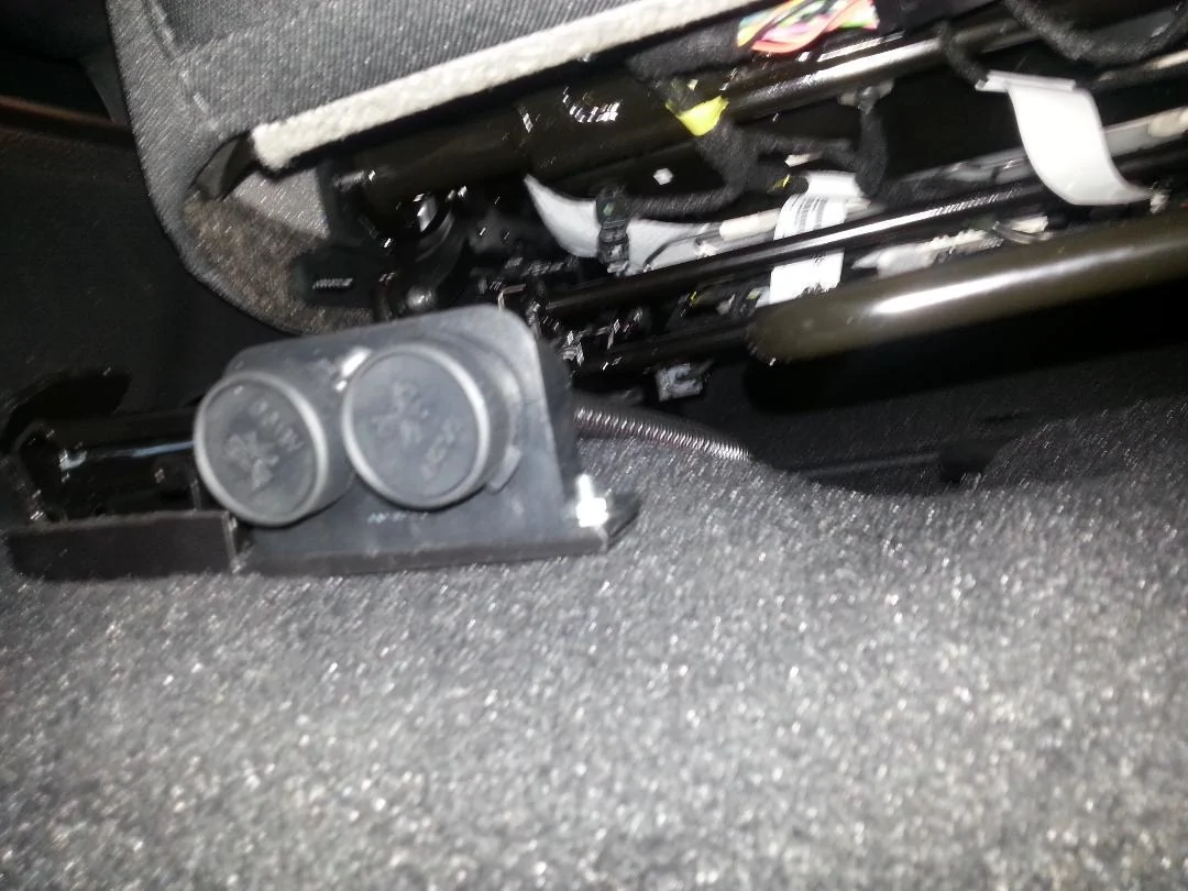

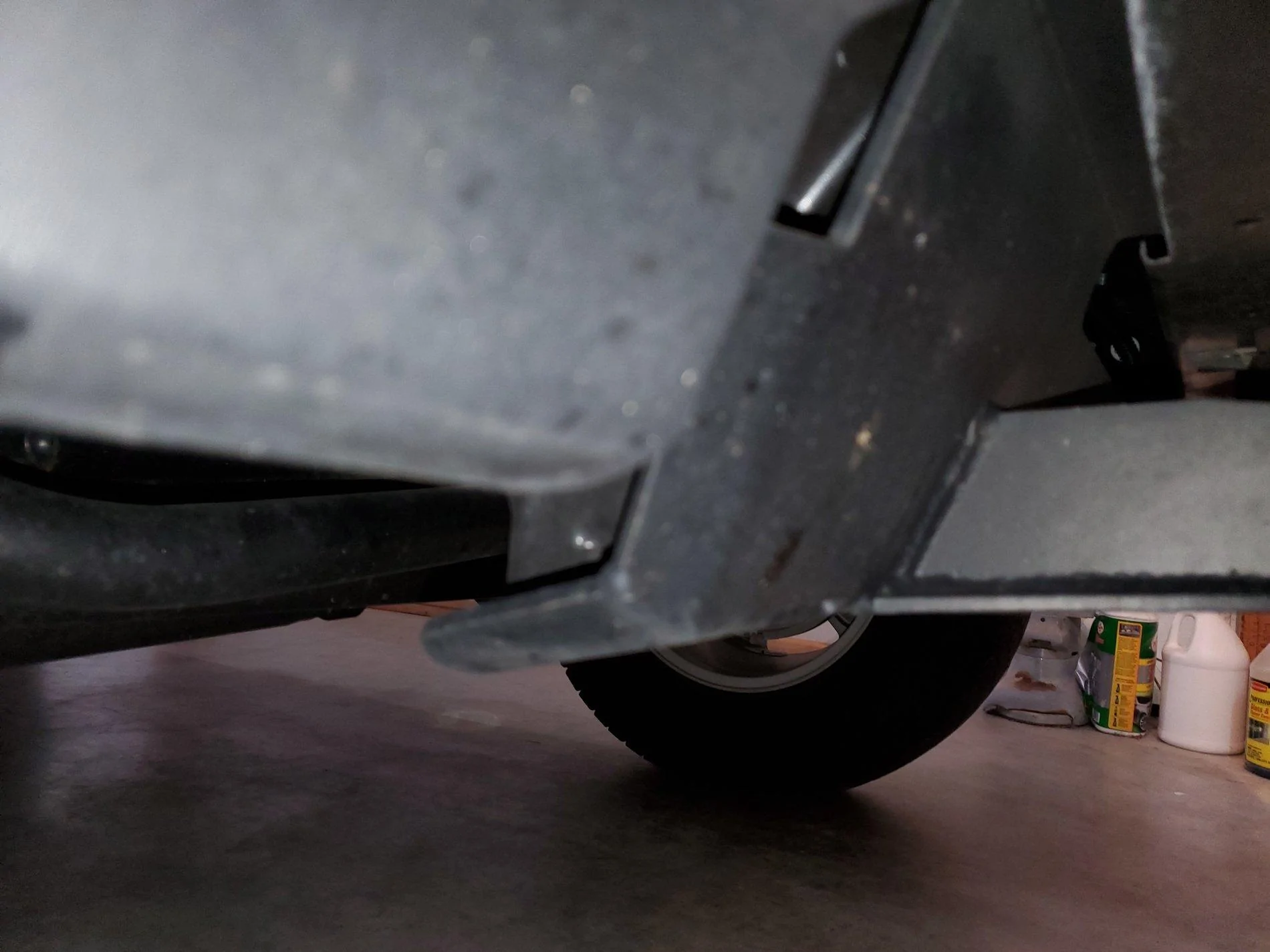

Mine is a Sport S with a plastic bumper since that was my only choice. RJ makes a model for both. I am using a older Brake Buddy since that is what I had from my previous toad and it has worked for me. Installed a outlet under the seat for it. Mount is a piece of aluminum angle using the seat bolt to fasten and the front of the track to stabilize. Angle on that leg cut to clear seat movement and so to have clear access to outlet. Note the factory outlet from the factory is key energized. Initially used a stand alone light system (pictured) but install a Hopkins 56210 Plug and Play once they became available as the stand alone was a bit inconvenient in use. Blue Ox appears to now be offering that system also. Took a pic so you can see the angle of the plate a little better.
