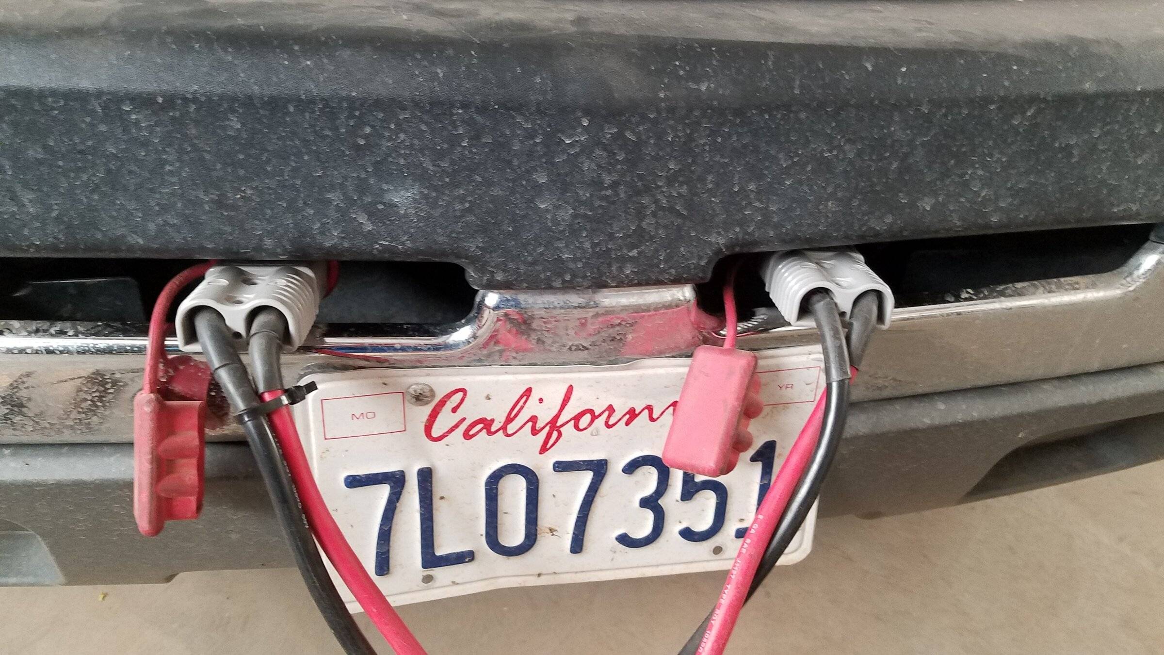

My battery tender solution for a dual battery system on a diesel that keeps both batteries charged and ready to start (2004 Chevy, not a Jeep but the idea is the same):
Jeep Wrangler JL Battery maintainer question 20220303_105043[1]
Jeep Wrangler JL Battery maintainer question 20220303_105052[1]
