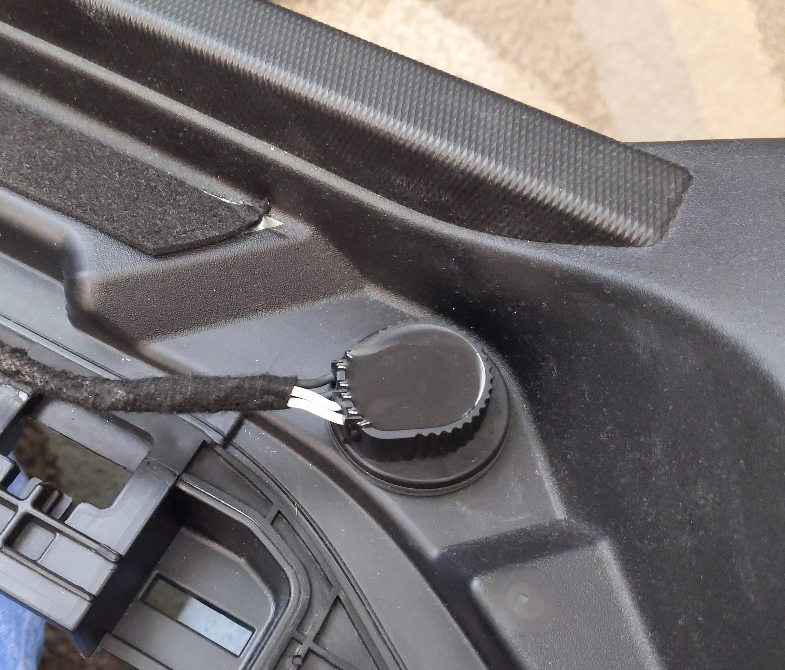

To address the mid range harshness, I decided to try lower impedance tweeters in the upper dash that would use more of the power that is shared between the upper dash and lower dash speaker pair, leaving less power for the lower dash speakers. This worked, installing some Infinity Reference REF-375TX 3 ohm tweeters in the upper dash eliminated the mid range harshness.
With the combination of getting all the speakers wired in phase and adding the new upper dash tweeters, the system so far has been able to play any music accurately at full volume with no distortion or harshness.
