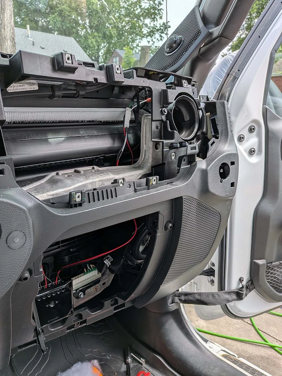

I finally upgraded the knee speakers using Infinity Reference REF607CF speakers. I went with component speakers to avoid having to use a coax speaker and adding an additional tweeter in the knee position.
Jeep Wrangler JL Base System Speaker Upgrade speakers kn
I surface mounted the tweeter to the dash grill. You can see the crossover in the glove box opening, I used velcro to attach it to the side of the speaker pod.
I did find that the Metra speaker pods need to be lined with sound deadening material. Once that's done, this upgrade sounds great and is the best sounding upgrade yet.

Will the factory wiring work with component speakers like the setup shown in this example photo?

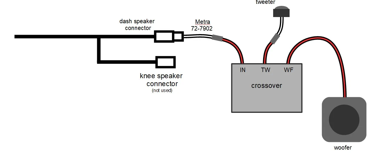

Everything is wired through the dash speaker connection.
Jeep Wrangler JL Base System Speaker Upgrade speaker front wiring

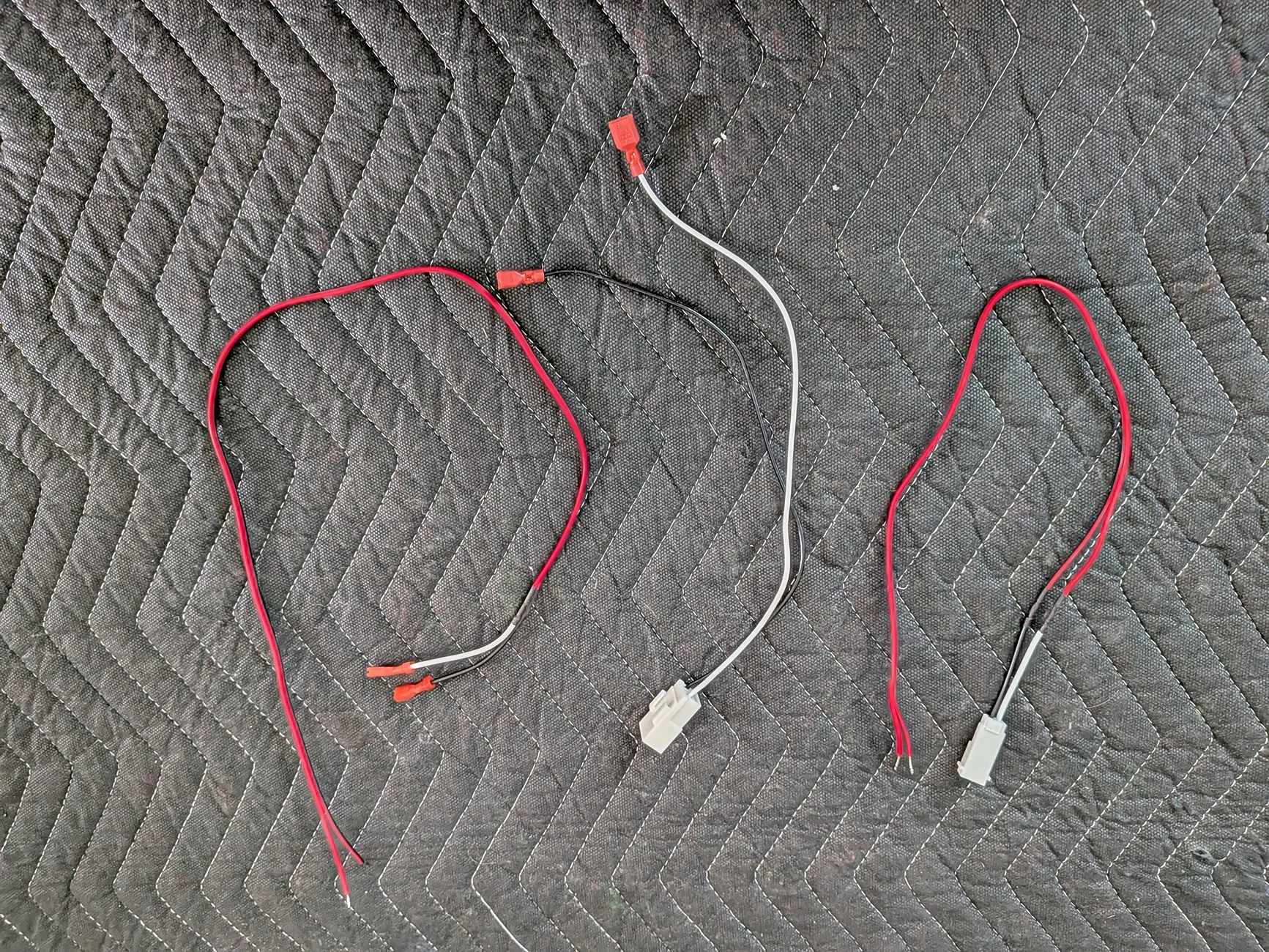

I cut and extended the Metra adapter wires, using the plug ends to connect to the factory harness and speaker ends connect to the tweeters. I used speaker wire I already had to connect the woofers to the crossover.
Here's a picture of the modified Metra adapter.

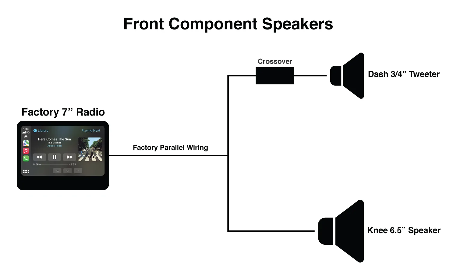

And what about my diagram?
Is it the wrong way to connect component speakers using the factory parallel wiring?
Yes, it is the wrong way. The component system is designed for both speakers to plug into the crossover. With the crossover placement next to the woofer, it's easier to use a plain speaker wire to connect the woofer to the crossover compared to using 2 adapters (factory and Metra) to connect the woofer to the factory harness.
Also, the Infinity rating of 3 ohms for the component system would not be valid with the woofer connected to the factory harness. My guess is it would be around 1.5 ohms (3 ohms in parallel with 3 ohms).

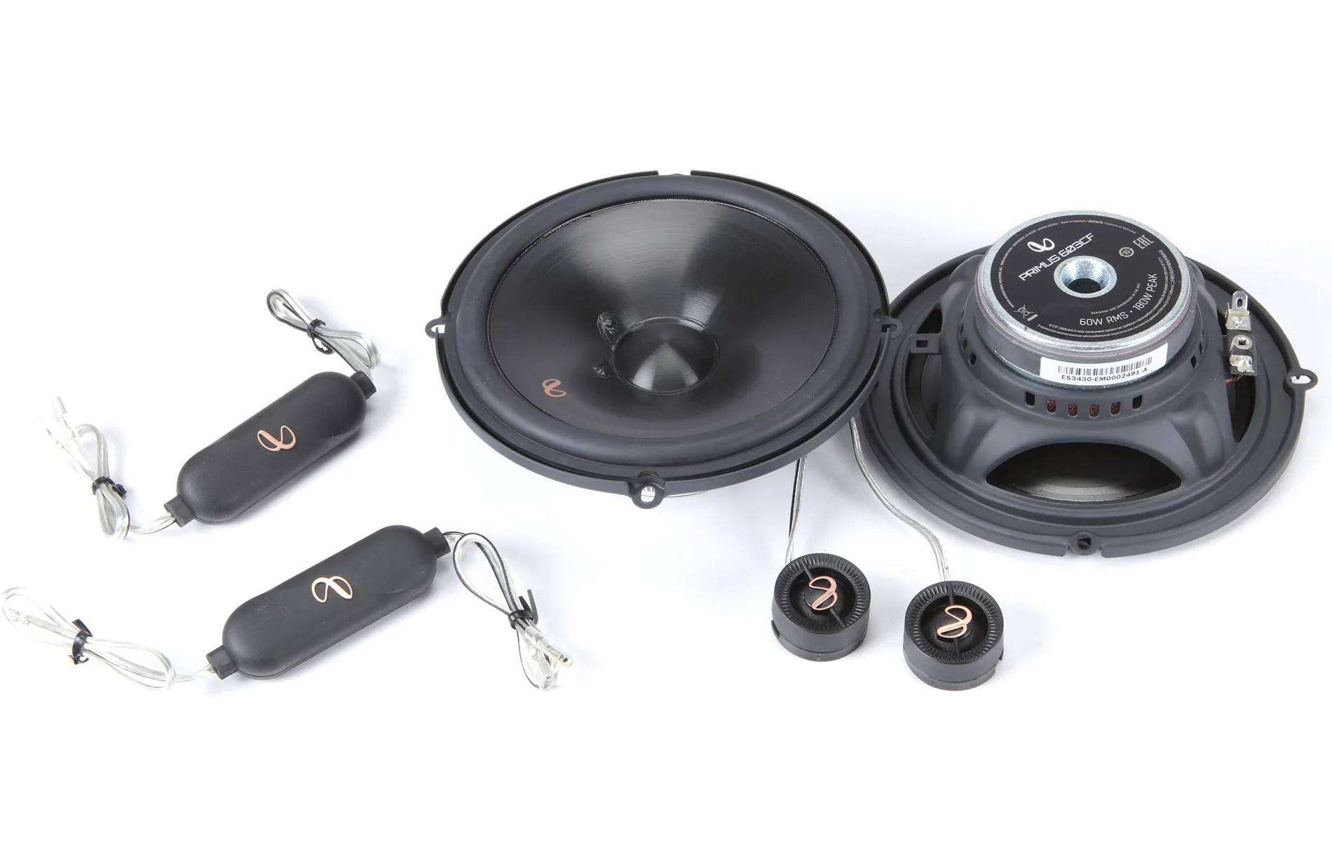

I think Component Speakers that use an In-Line Crossover are okay to use with the factory wiring, like Infinity Primus 603CF:
That's the first component system I've seen that only has crossovers for the tweeters, that will work with the factory wiring as you diagramed.

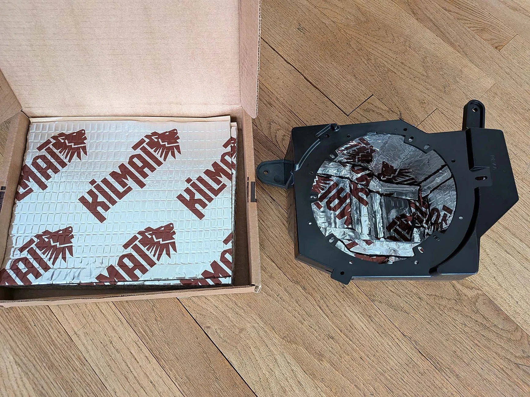

You'll want to cover the inside of the 6.5" speakers pods with sound deadening material. I tried installing mine without doing that and it sounded terrible. Without the sound deadening, the sound goes through the pods into the dash, distorting the sound and causing lots of rattles.
