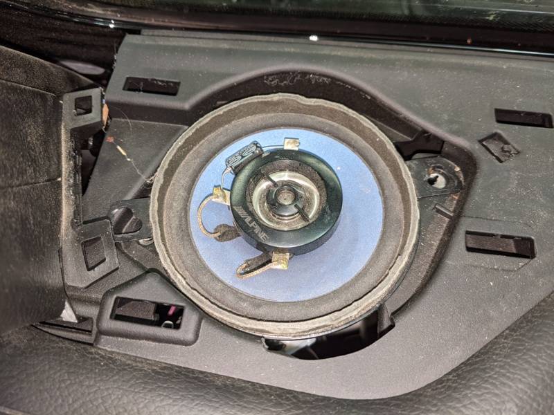

My speaker upgrade journey started right after taking possession of my new 2018 JLU with the 5" base system. My goal was to get a quality sounding system without adding an amp or sub woofer. I avoided modifying the sound bar as long as possible, but success was finally achieved with Infinity Kappa 62ix 6.5" speakers in the sound bar and JL Audio C1-075ct tweeters in the upper dash. Following is some of what I learned along the way.
Unlike the amplified system that powers each speaker individually, the base system powers each corner's 3.5" and 4" speakers as a pair, in parallel. Changing one of the pair can affect the other. For example, Infinity 3032s have lower impedance than the factory 4" speakers and when paired, a larger percentage of their shared power will go to the 3032s. But with the 3032's base blocking capacitors blocking the lower frequencies, all the low frequency power will go to the factory 4" speakers.
I found that with all four 3.5" speakers replaced with base blocked 3032's, there is a noticeable lower frequency contribution from the factory 4" speakers. But the system still needed more bass. After running this setup for a couple years, I finally did the 6.5" speaker sound bar modification using Infinity Kappa 62ix 6.5" speakers. The 62ix sound great, especially after adjusting the fader +2 to the rear to get more sound out of them.
With 62ixs in the sound bar now providing the majority of the sound output, the last change was to swap out the dash 3032s that tend to over power the lower dash 4" speakers. I replaced them with JL Audio C1-075ct tweeters. The tweeter's higher impedance and higher frequency range allow more lower frequency power to get to the factory 4" speakers and there is a very good balance between the pair, and this front pair is well balanced with the sound bar.

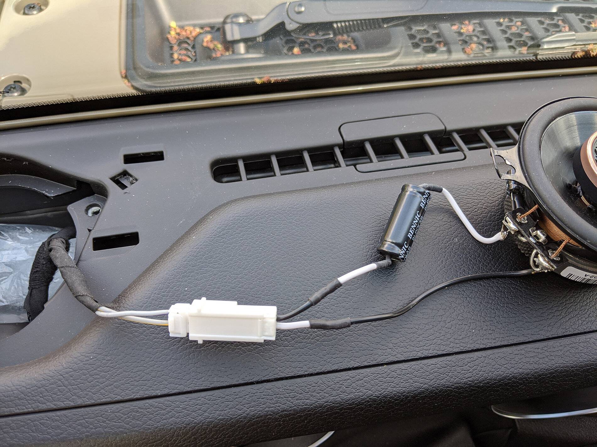

Swap the Metra adapter wires so they don't reverse the polarity of the speakers.
When the upper dash speakers are upgraded, they will very likely overpower the rest of the system and setting the fader +2 to the rear helps rebalance the system.
Stuffing poly fill under the upper dash speaker improves sound and helps with left - right speaker isolation.
