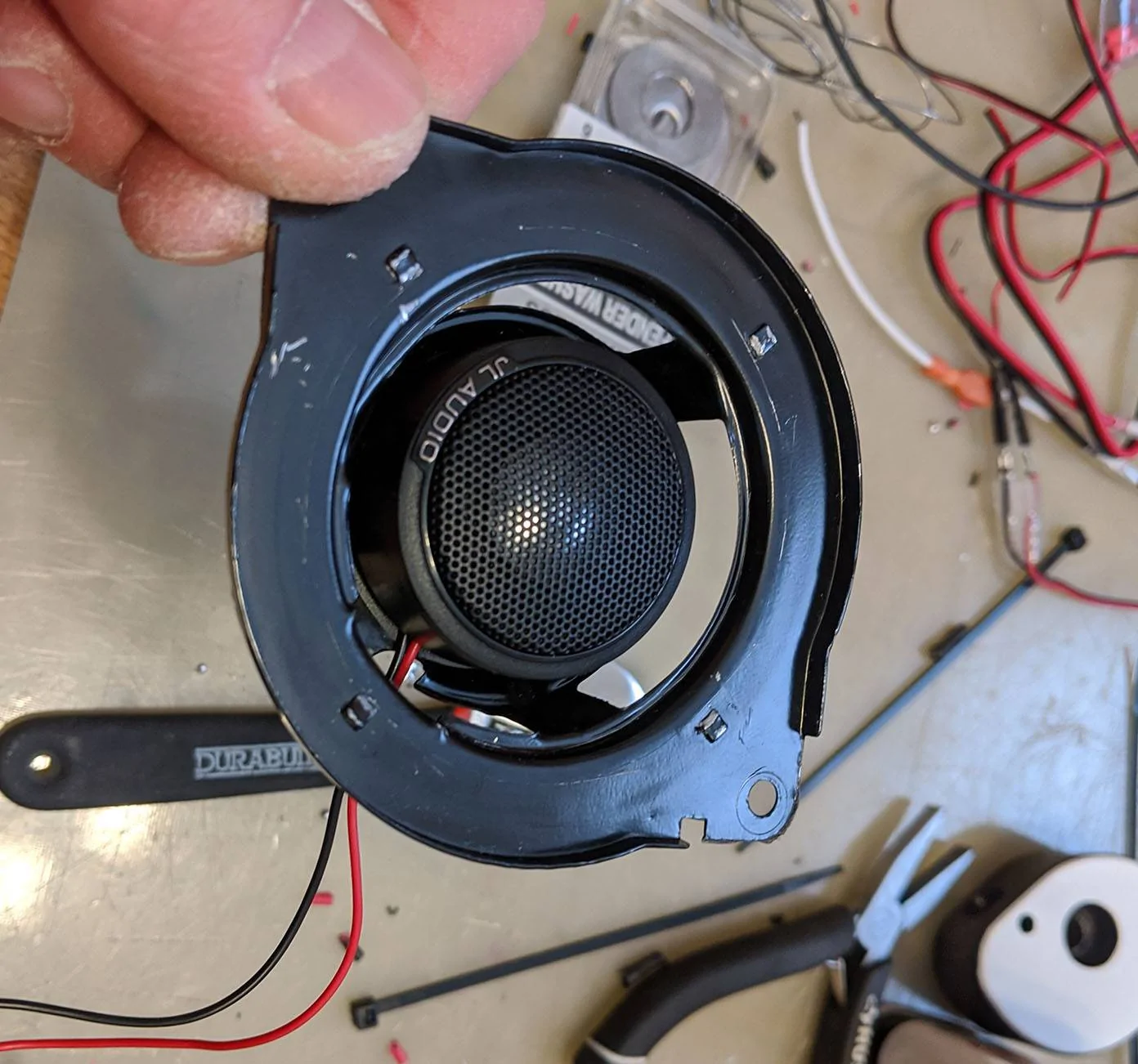

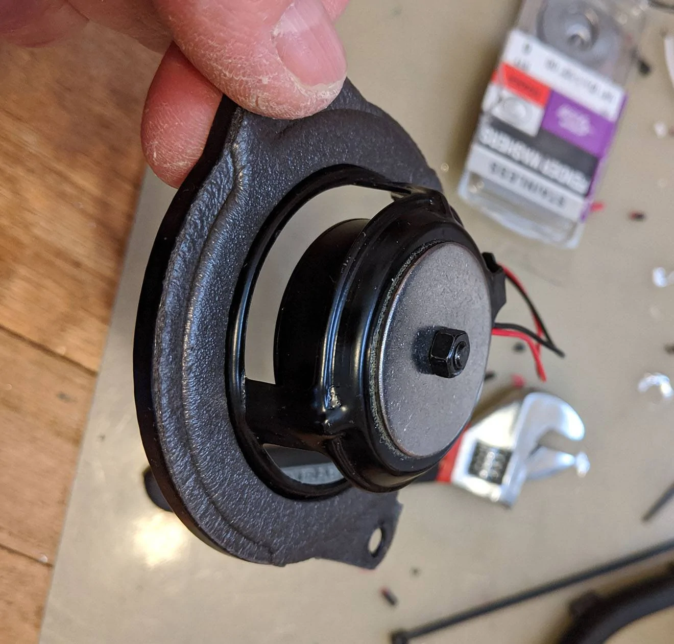

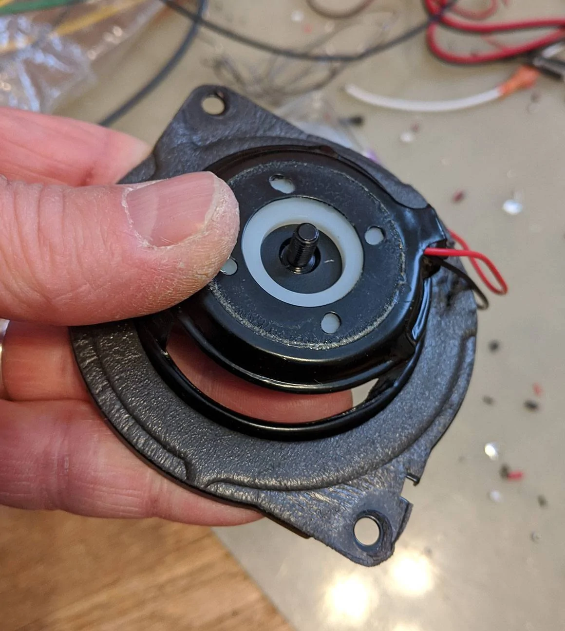

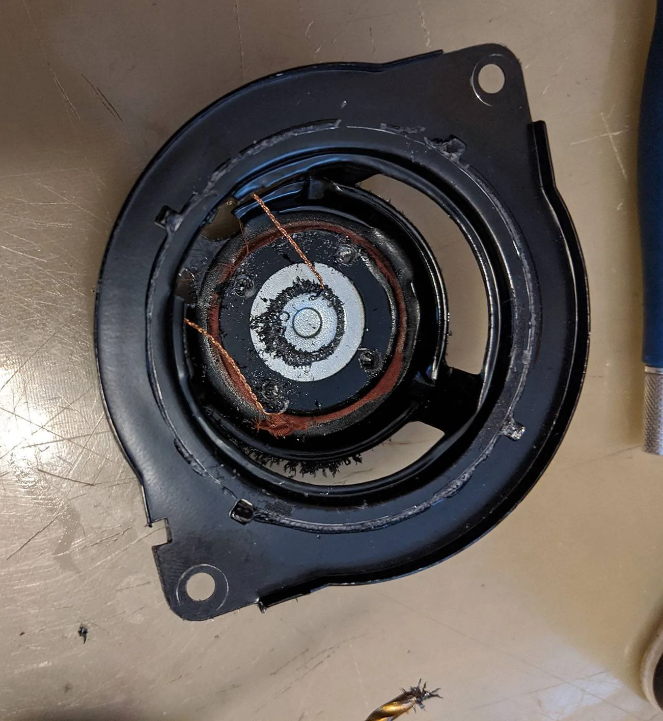

That's also a lot of work and at least 2 trips to the hardware store. One for the nylon spacer under the speaker and another for the fender washer on the bottom. I suppose now everyone else can do it in one trip. It's a slick solution, but I'll probably use a strap next time.
