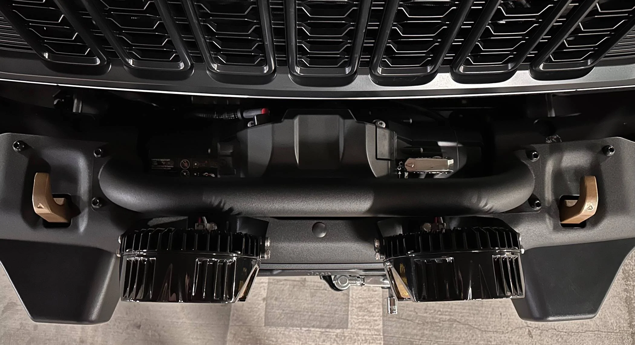

This is all I have at the moment but can take whatever you like later.
Jeep Wrangler JL Baja Designs LP6 IMG_0562

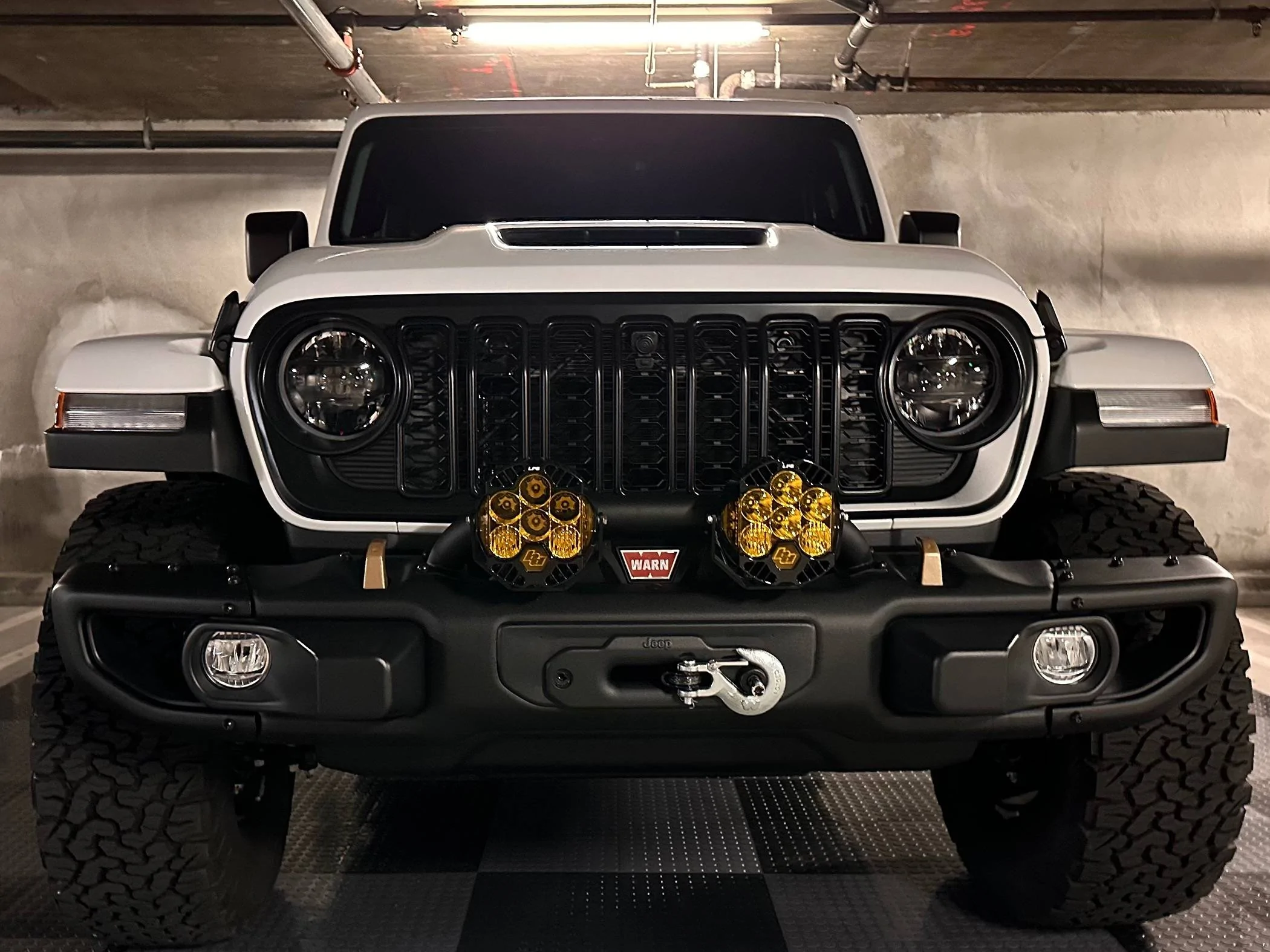

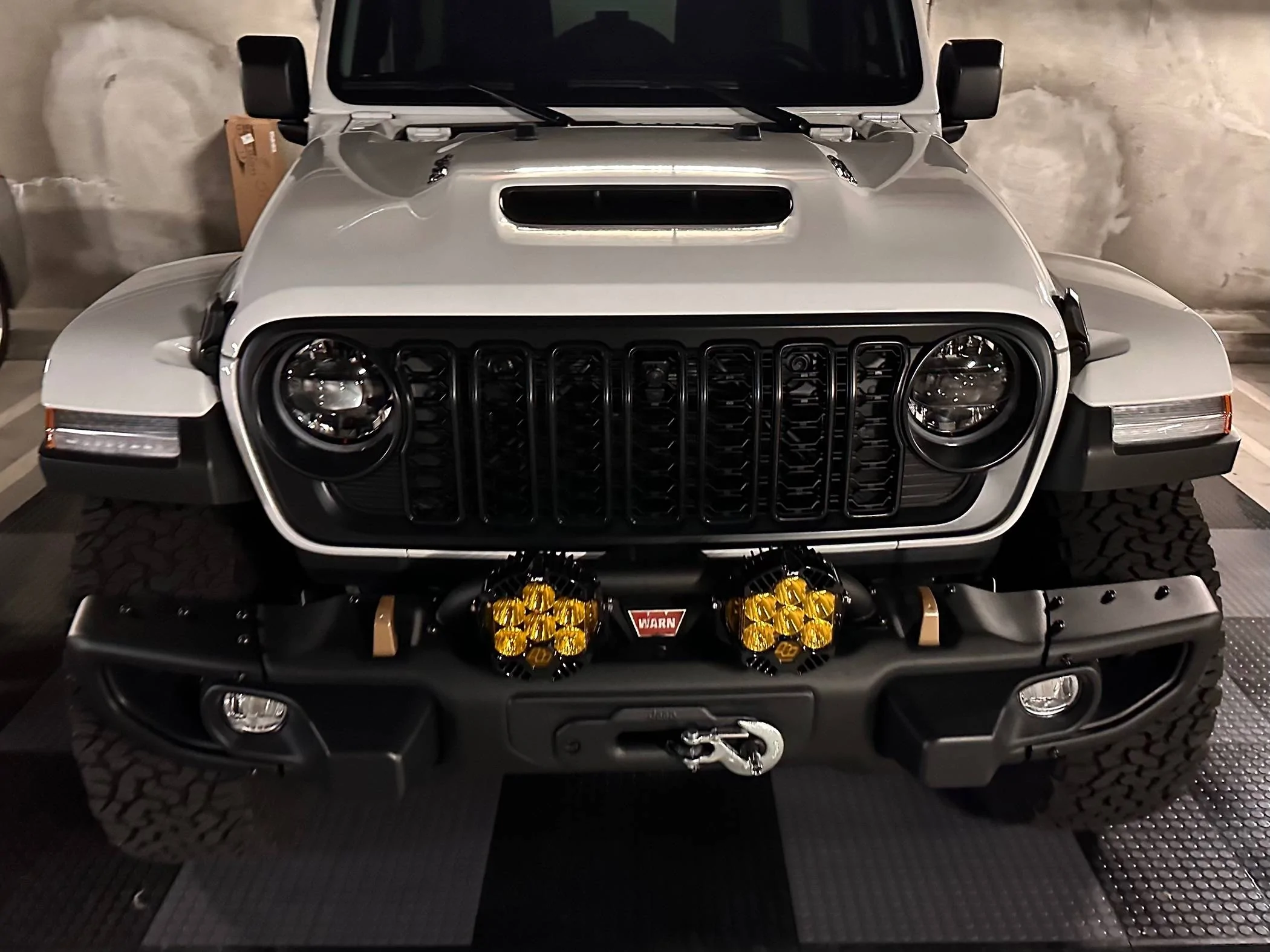

Do you have a view from the front? I have the same winch bar and was thinking of mounting up there but kinda like this better.
I looked at mounting them on the bolt to the outside of the hooks but thought this looked better.
I’ll take a dead straight on this evening. Anything special you want to see?

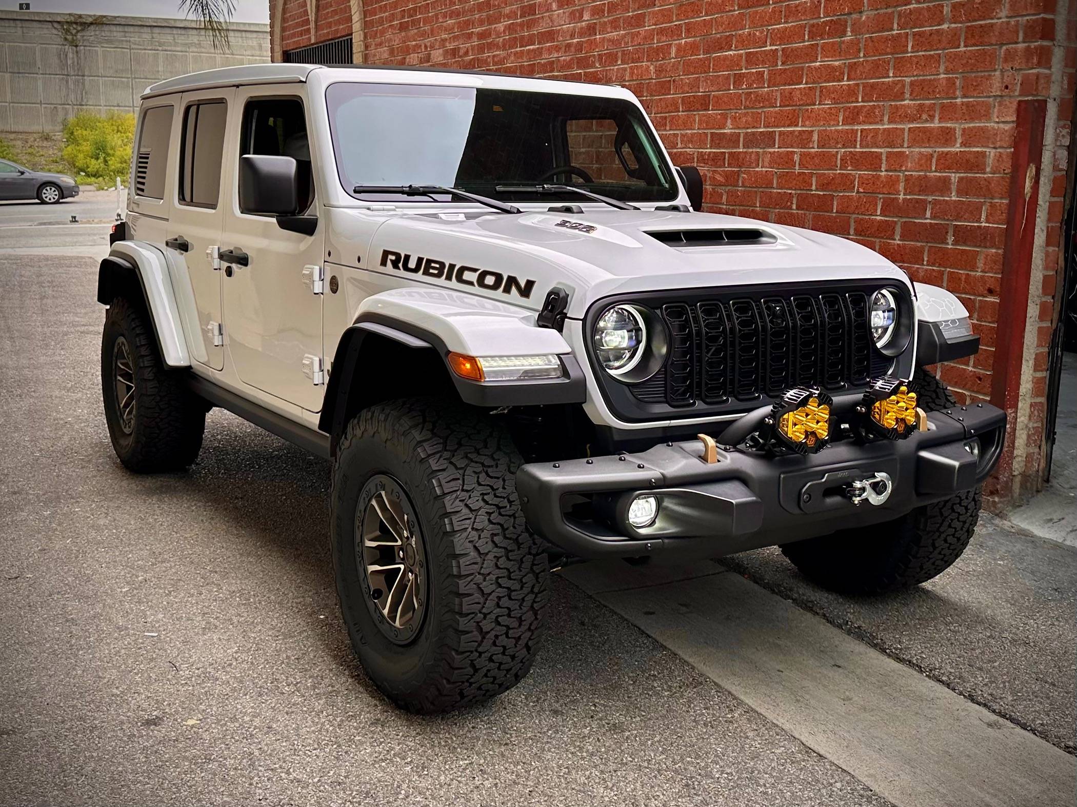

Here is an alternative way to mount on a stock bumper (2nd photo). This is the BD mount for a stock plastic bumper. 1st photo is after a deer strike.
Jeep Wrangler JL Baja Designs LP6 PXL_20230118_190452788
Jeep Wrangler JL Baja Designs LP6 PXL_20221023_155800095.MP
