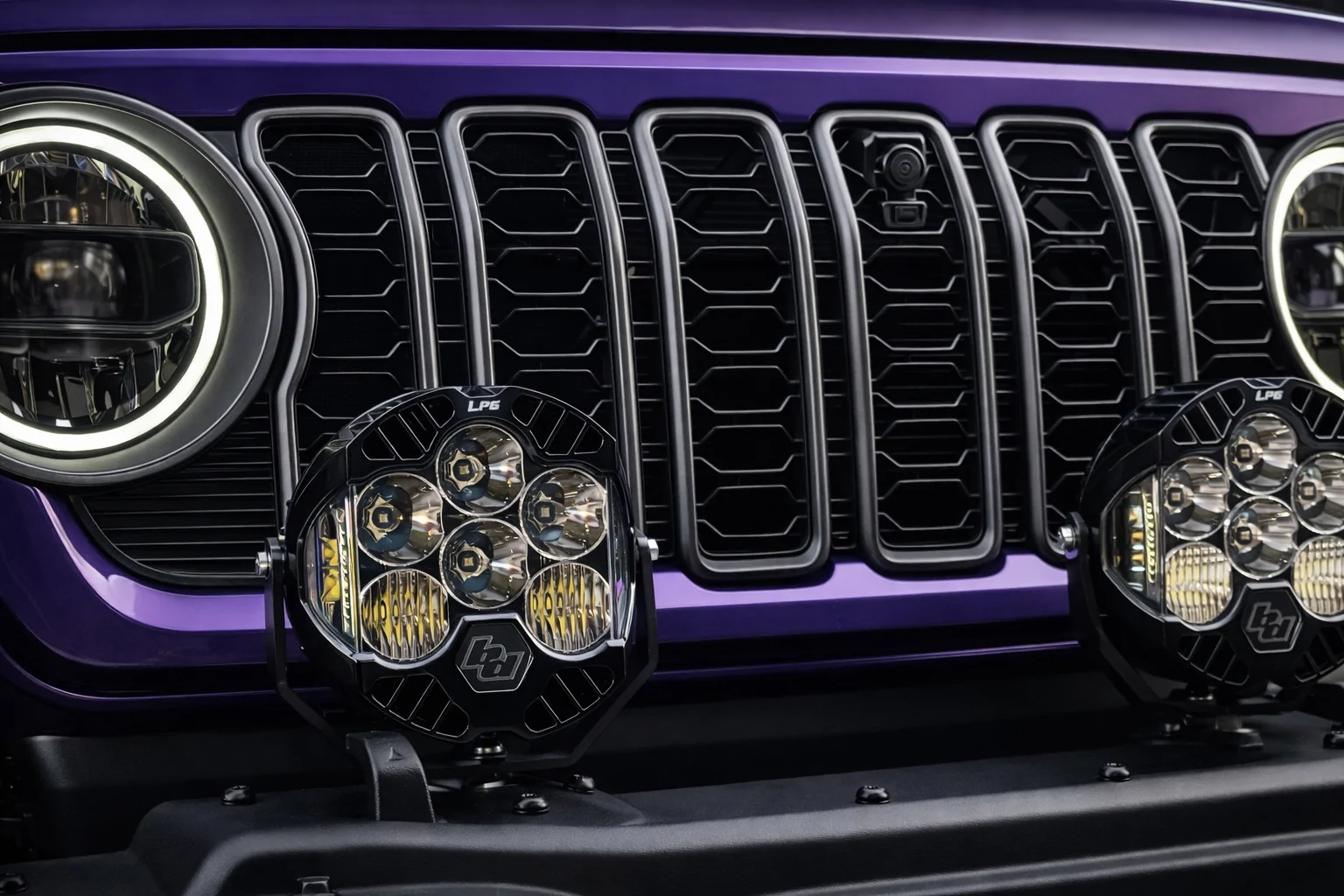

I installed the LP6 Pro lights on the front bumper on my 2026 Moab 392. I connected the high beam to the AUX 1 switch and the amber backlight to the AUX 3 switch. I did not connect the low beam circuit because I would never use the low beams. I did a short drive last night and the these LP6 lights are much brighter than the Mopar 7" LEDs that I had on my 2021 Rubicon. The LP6 lights also have a peritheral beam to see the sides of the trail. The quality seems very good.

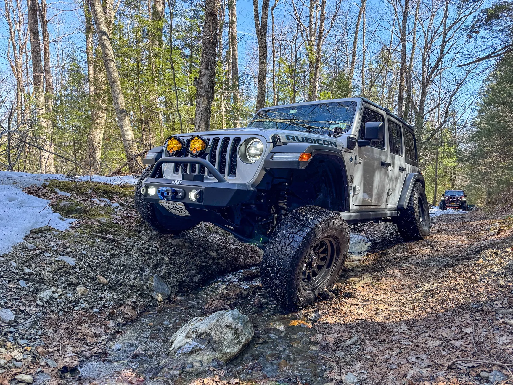

I use the amber version on my Jeep and I absolutely love them. They throw a ton of light, and the beam offers a great blend between the spot and flood so it just lights up everything in front of you pretty evenly. Like you I wired the high beams to AUX 1, and didn’t bother to wire the low beam yet. The only thing I did different then you was I wired my backlights to a acc circuit so they come on every time the Jeep starts I didn’t want to tie up an AUX circuit with that function
