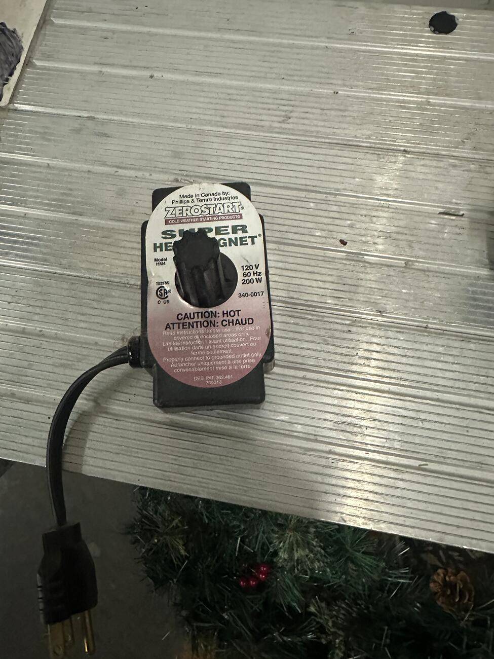

So as I recently learned there is no block heater I learned even more recently its about to get really cold... around -27F (-33C) and not enough time to get one installed.
Should I be worried about extra wear on a cold start? If so, can I just use one of those magnet oil pan heaters? Should I use something else? is the oil pan even metal or is it some crazy plastic material?

oil pan is steel on my 18' 3.6L. i dont see why a low temp magnet heater wouldnt help

The 3.6 has a steel oil pan. If I lived up there, I'd install heat pads on the engine, trans, and TXcase.

If you need it, let it warm up good before leaving, also take it easy as the drive line does not heat up at idle. The oil pan heater is a good idea alternatively if you have a wood stove it woul be to use the firebrand in a bucket that you slip under the jeep.

As I suggested earlier a pad heater takes minutes to install. Not magnetic but permanently glued on. I installed one on a 12L diesel (500 watt) and it did the trick.

I used to use these on my oil pan and tranny pan on my Ford F250. My buddy worked on the slope and he said they would build tents around vehicles and use propane heaters to thaw vehicles out.
