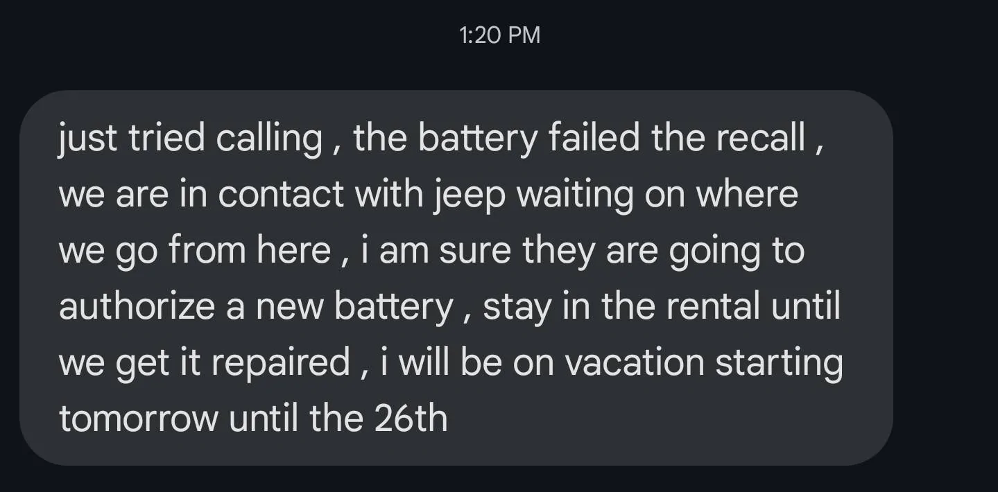

Just got an update from the dealership today. It was dropped of Wednesday morning with 0 charge. Here the is message from my service advisor. Not good ? what do you guys think???

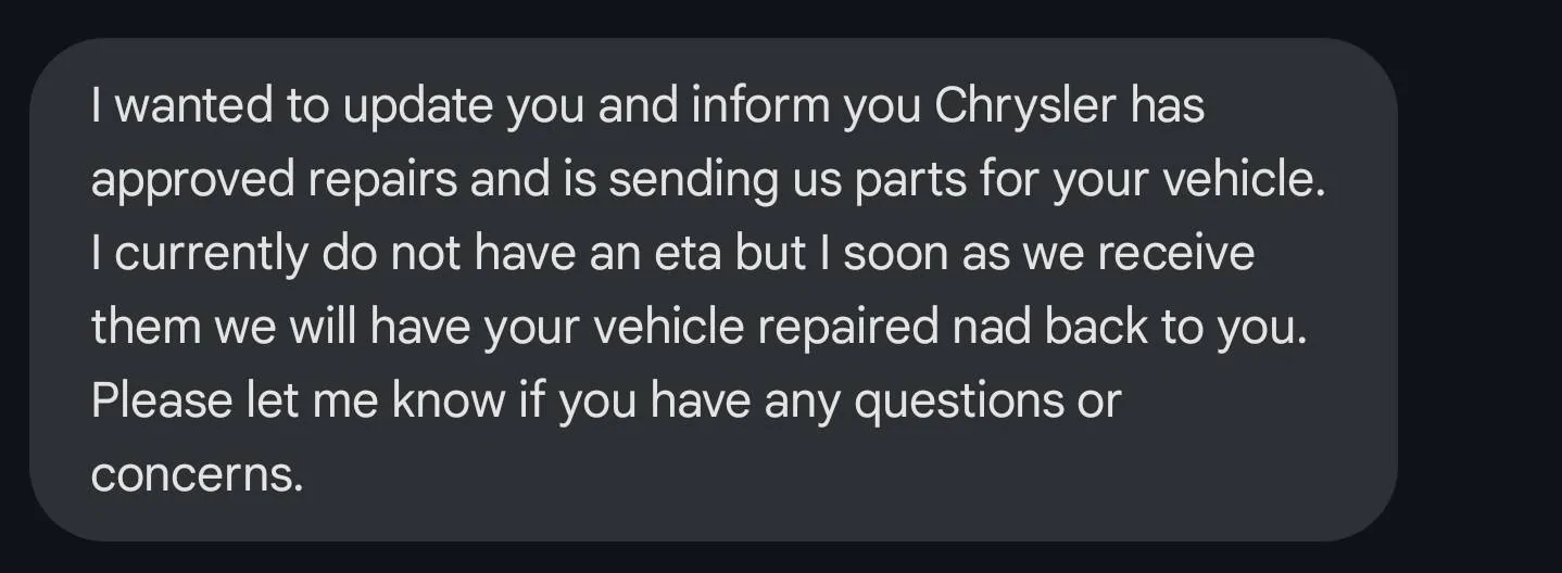

Just received a new update and it looks parts have been approved ? I wonder what is required for the battery system to be replaced?

According to my service advisor, Chrysler approved all my parts (battery), they will let me know once they come in. I'm assuming it's going to be about 1 month before I get it back. What do you think @alphawolff ?
I won't have it back for Jeep Beach Week ?
I'd estimate at least a month. STAR case takes a day or two to get the battery pack ordered, then the battery pack could easily take 1-3 weeks to show up. The job only takes a day but it requires a decent amount of logistics to get it done simply due to how big the damn thing is. I'd give them at least a few days after it shows up before it's completed. I think FCA policy is the part needs to be installed within 4 days of arrival on anything like this for proper rental authorization, so I'd say you should get it back 4 days after it shows up assuming nothing out of the ordinary happens.
