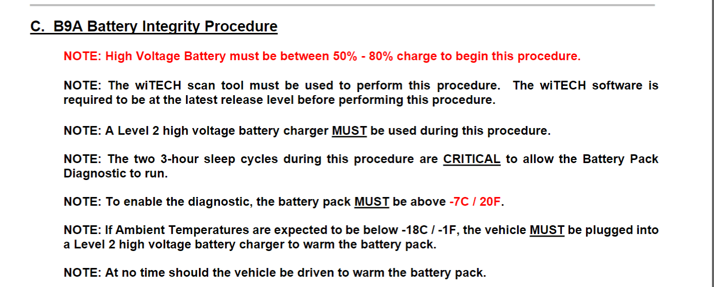

Hey everyone! I got my 4xe back today from the battery recall and it was given back with 38% battery. I drooped it with 40% when I questioned the service advisor why it wasn't at least 90 as per the instructions in the recall procedures he said oh i know exactly what your talking about. Yeah jeep updated the recall instructions after a bunch of pushback from dealerships about how long it takes to do and now the instructions say that there just needs to be "some" charge in the battery. Has anyone heard this? I have a sneaking suspicion this wasn't done right.

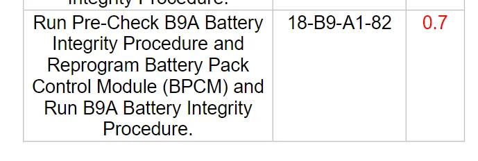

I decided to check.
Jeep Wrangler JL B9A recall is available! 1711585368657-d1
Looks like the recall has been updated to change the 90% charge requirement to 50-80%. The recall also pays an additional 0.1 hours now.
I asked another tech since he did one earlier. The procedure has been changed in witech. Now you have to have the SOC in the BPCM data between 50-80%, then it runs a 5 minute timer, then tells you to charge it over 90% SOC, then restart procedure.
The simple version is you should still be getting it back over 90%. If you brought it in at full charge they'd have to drive it until under 80% (or charge to 50% if under that), run a check, charge to over 90%, then run the first integrity test, 3 hour soak, another integrity test, final 3 hour soak, then the final integrity test.

I decided to check.
lol
If they changed it due to "pushback from dealers" then they're just fucking with us at this point.
So it sounds like they are missing interpreting the SOC requirements and not doing it correctly or just installing the software and calling it good.
