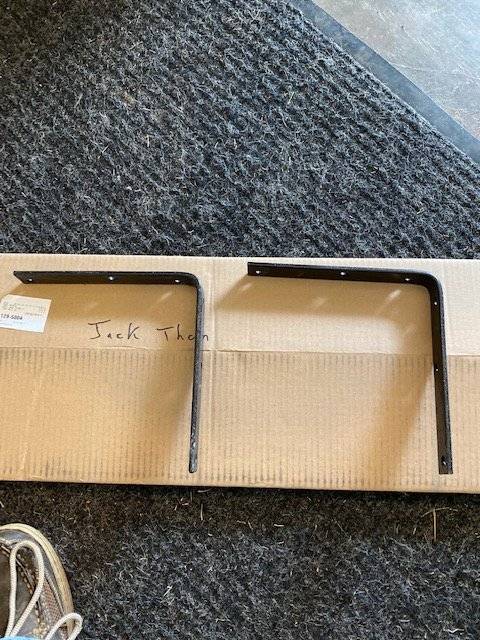

I bought 8" galvanized corner brackets from Home Depot for $6.95 each and painted them black. Had to drill a few holes in them to attach to bumper bracket bolts. I also cut out a few slots on the plastic piece between the bumper and grill to put the bracket through so the jeep looks original.
Jeep Wrangler JL Aux lights on standard bumper? 63631394196__665823AB-1C7F-4AED-BD83-A0F0259EA3A4
Jeep Wrangler JL Aux lights on standard bumper? 63631642613__BAF4B1EF-F425-44E3-B3EA-069BFFAC1D0A
Dope. How is this holding up? And do you remember how you fastened them to the frame rails?
