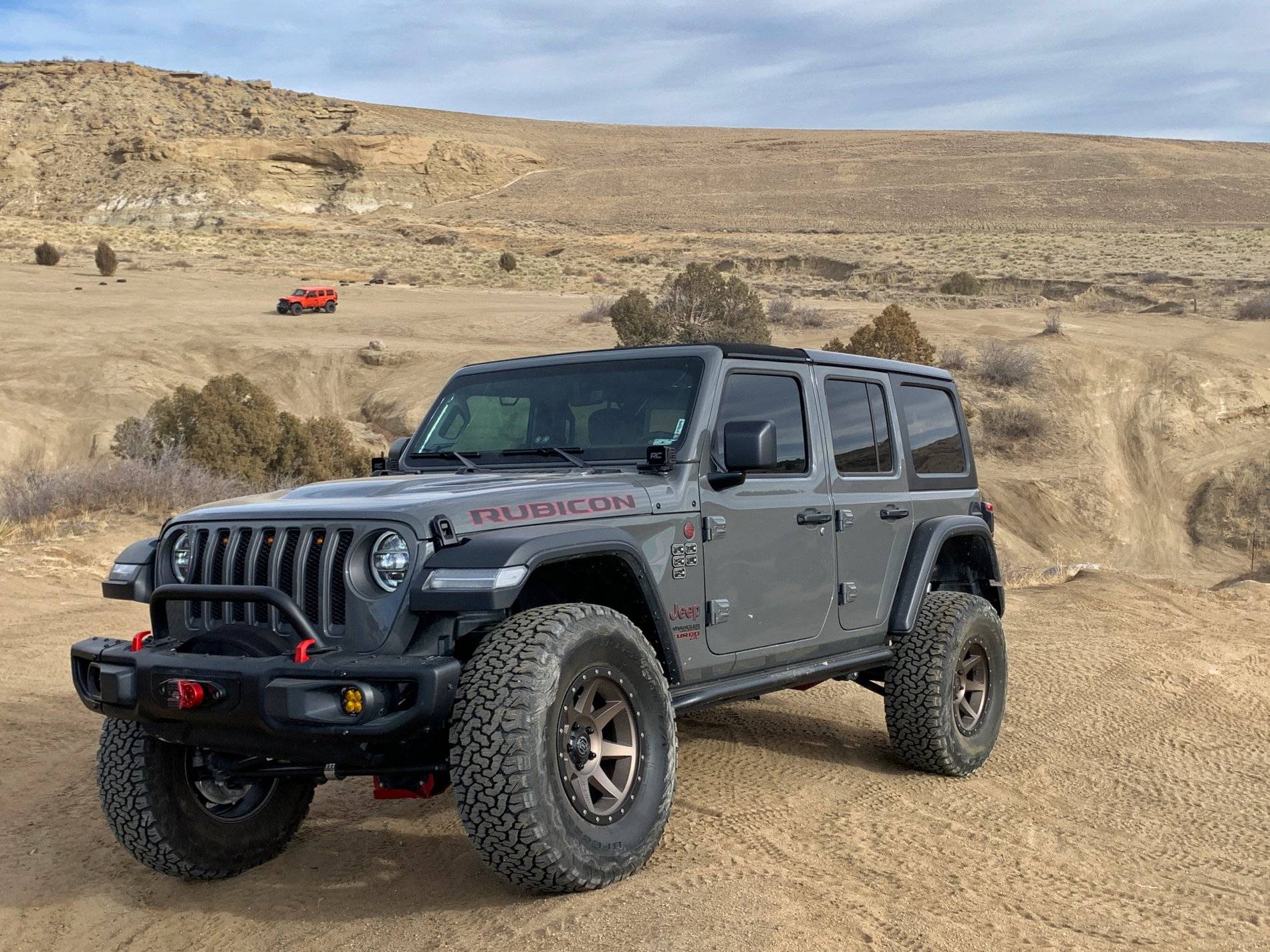

As others have said, you should be fine as long as you are below the max amperage for that aux switch. BTW, nice photo. Where was that taken?
Thank you that was at an off-road park down in the Springs.

Nice rig! Which bull bar is that on your steel bumper? It looks slightly higher (and better) than the smaller warn branded one.
Thanks, it’s.a medium Warn bar.
