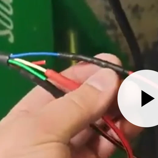

It's a little difficult to tell from the video, but it looks like you have the white trigger wire connected to the battery positive instead of the red power wire?
Jeep Wrangler JL Nacho grande lights or aux switch nonworking, help 1000005593
Also, you should have a fuse at the battery positive.
The "white" trigger wire was actually the red wire. It had an outer casing on it that came off. So this is in fact the red positive wire. Nothing in the directions, indicate I need a fuse anywhere.
It sure looks like there's an unattached red wire in that bundle.
In any case, always fuse accessories connected to the battery positive as close to the battery as possible.

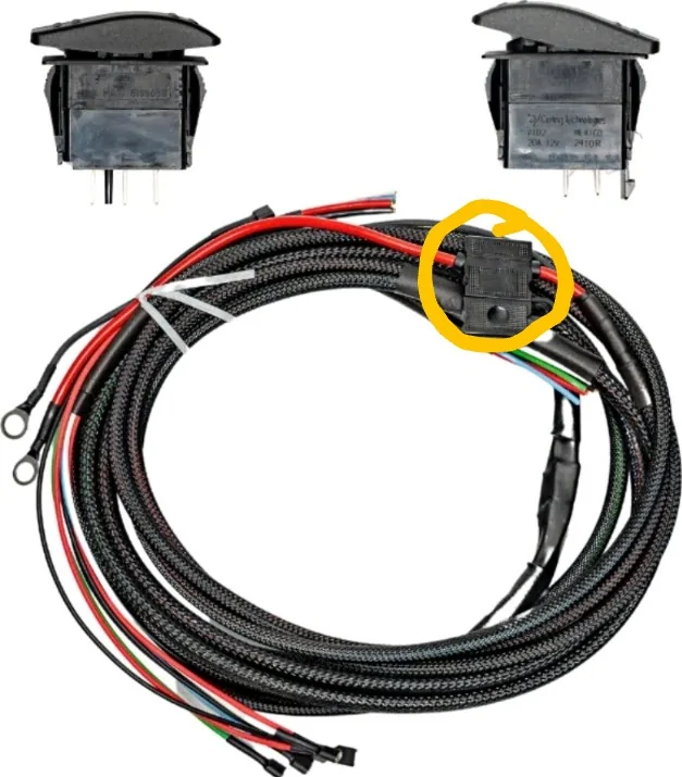

Note the Nacho accessory wiring harness has a fuse holder:
Jeep Wrangler JL Nacho grande lights or aux switch nonworking, help 1000005597
