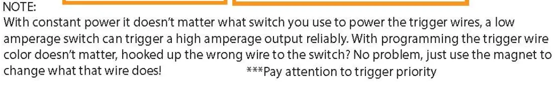

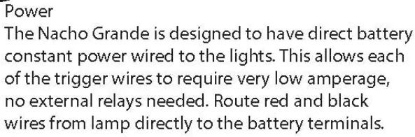

Looking for some help on wiring. I've read through some previous posts and just want to confirm that the infor I got from Naho/ARB is the best route.
1. I was told that both of the lights need the red wire to go to the battery - so 1 wire from each light, ring terminal to battery post.
2. Similar situation with the black wire - each light has a black wire, put a ring terminal on it and run it to the ground.
None of the wires above are being combined.

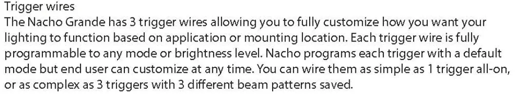

3. Pick any of the remaining wires - i choose green - combine the green from each light and then run one wire to the aux switch 15amp.
From Nacho:

I just installed a set of the Nacho Quatro Supreme80. They have the same wiring as the Grande. You are correct in your wiring description. Your Aux switches only trigger the light functions. You can also change the functions with the little magnetic wand provided with the lights. It is a slick, flexible system.
