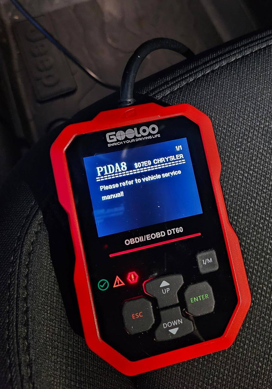

I had the reverse clunk and hard upshift from 3rd to 4th gear, then reverse wouldn't engage with message "shift to park then desired gear" on dash. Took '21 jlur with 23,000 miles to dealer and they got a code 1DA8-00 they inspected fluid for metal, none found. Then a TSB 21-009-25 Rev A, D clutch repair. They removed transmission, disassembled and replaced D clutch assembly, then a quick learn and adaptation. What a huge difference in transmission operation, just like new now... hope new parts have been improved to not fail again.

I'm having the same issue. 21 JLU with 80k miles. Began having this issue intermittently - mostly the "Shift to P then Desired Gear" issue when attempting to shift into reverse. Now it's happening nearly every time I drive it.
