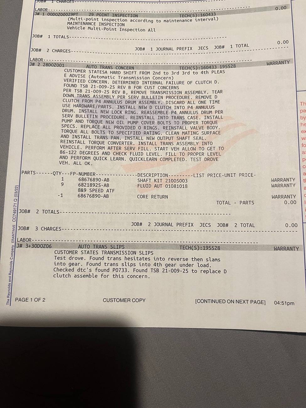

Thanks to Jeep Cares for the help. My Jeep has been repaired at the dealer. They replaced the D clutch, and so far, after three days of driving, the previous transmission shifting issue has not reoccurred. The photo is the dealer's report — I hope it can be helpful to others.
Jeep Wrangler JL Automatic Transmission Issue IMG_0346
