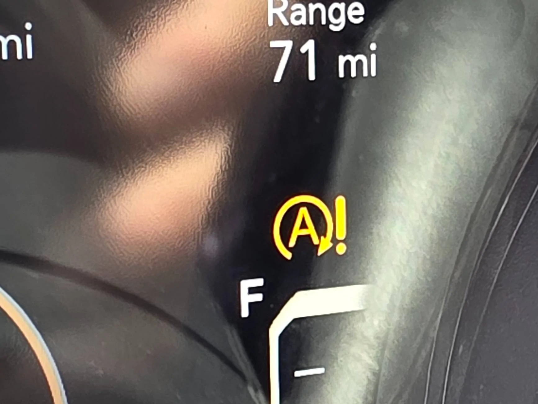

I brought my 2020 wrangler in for corrosion work and now this light is on when i got it back
Jeep Wrangler JL Automatic stop start warning light wont turn off 1000000909

wether you replace the auxiliary or bypass the auto stop/start, do it quick. Once the aux dies it will drain your main and leave you stranded.

I disconnected the start/stop switch under the hood and run 32psi in my tires instead of the 36psi Jeep requires. I have 2 warning lights that I simply ignore. I would rather enjoy a softer ride and reliable engine power for off roading
(nothing worse than having your engine shut off when your negotiating a tricky obstacle) or bouncing down the road with squirrely steering at higher tire pressure. Remember, if your tires start at 36psi, they will get to 40+ psi when on the highway.

There are an untold number of reasons for the ASS fault light to be on. Is the engine light on as well? Traction Control fault? Hood Switch broken? Scroll to the ESS page and see what it says. IF nothing helpful, pull DTC's.
