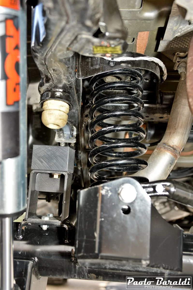

Ah OK you bought new springs, I was thinking takeoffs since that's what most XR swaps are and was like "How the fuck did you find takeoff 2 door XR springs" since they're such a rare option.
Anyway, since that'd get you like 1.5"ish out of those springs you'd get most of the 2" of up travel the bump extension would take back, just not all of it at that height. The thing with less than 2" of bump is I'm pretty sure you'd end up having to trim into the double wall section of the tub in the rear to accommodate full stuff (even moreso with the 0 offset wheel), which I'm interpreting as being counter to your desire to avoid getting into a complicated cut (pretty sure it wouldn't be full comp cut, but the tub structure starts getting funky back there once you get out of the flat parts of the pinch seam).
Do make sure you didn't miss Dusty's update though, bump extension pic and size update:
Been a bit, and I'm nowhere near it right now. It might have been 2", but that seems tall from my memory. I re-used the factory bump on top of some square bar tube.
*edit*
Looks like 2" after all.
