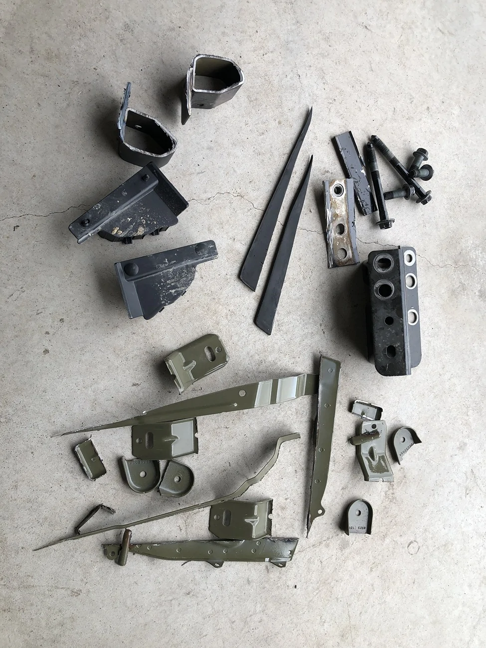

My goal with my Jeep is to keep it low while maintaining up travel. I was planning on running 37-39" tires, and I think my Jeep could handle 37s pretty much as-is, but I just recently got a good deal on some 39s. I am curious what others have done to run big tires while maintaining close to stock suspension compression height? Please post up shock, spring, and bump stop information, as well as what cutting or other mods you had to do to make it work. Everyone likes pictures too.
I am not interested in running any more than 2" of bump stop spacers, and ideally I want as little bump stop spacer as possible. I think I might be able to get away with just 1". I am not afraid of cutting, but I am not looking to tub the rear, or cut out the front core support. I would like to keep the ride height no taller than stock XR Rubicon height if possible.

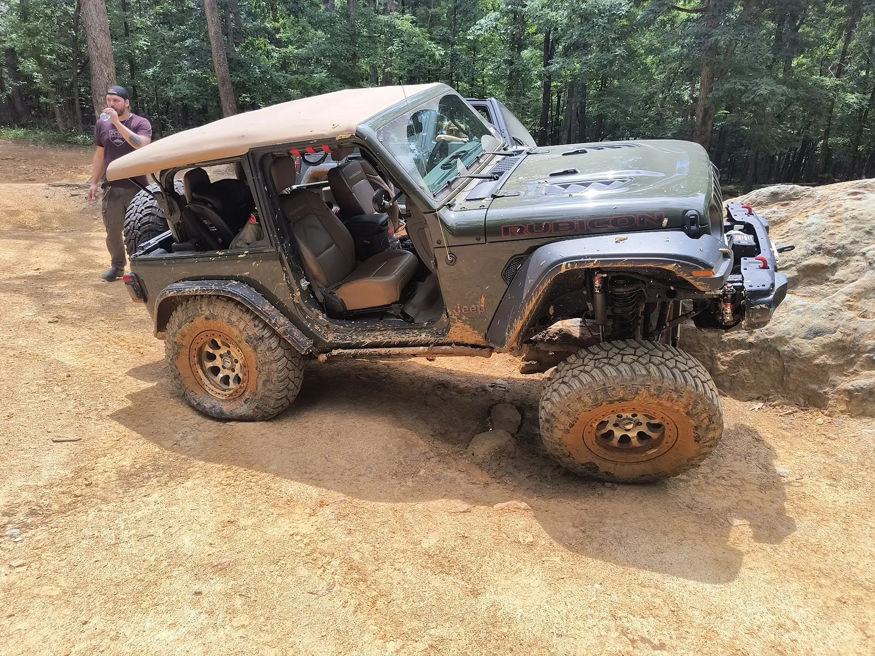

If you're avoiding lots of bump, you're also probably going to run a fairly short shock to maintain up travel (read: not extra long droop), just kind of the tradeoff there. I run 2.5" of bump in the rear with 37s and with 17x9 wheels with -12mm offset (like 4.6"ish backspace) I'm touching both sides of the inner wheel well in the rear:
Jeep Wrangler JL Assfrow, Yokramer, and Remorseless's Circle jerk thread 1780497049259-x5
My shocks are 18.4" collapsed and 30.3" extended in the rear and I still leave a little up travel on the table with just 2.5" of bump.

Like I mentioned, I'm not scared of a bit of cutting; the picture in my first post is what I have already cut off the Jeep. A little rubbing doesn't bother me; as long as the tires aren't catching hard on anything or damaging other components. If your tires aren't rubbing, you're not running big enough tires ;)
For whatever reason your pic isn't loading for me here, but I got bored at work and ran through your thread on Irate. You're pretty set up, probably just some pinch seam trimming in the rear. At roughly 2" of bump I'd wager 1-1.5" trim front/rear of the rear wheel well for a 39, judging by my setup at least, imagine yours would be hitting in similar spots if those 0 offset Methods are 8.5 wide which would put them roughly where my KMCs are at (0mm @ 8.5" should be roughly equivalent of my -12mm @ 9").
@3TV runs a 39 on his 2 door, but I'm not sure how much bump he's running, but he is lifted 3.5". I know he had to trim somewhere around that 1-1.5" off the rear pinch seam.

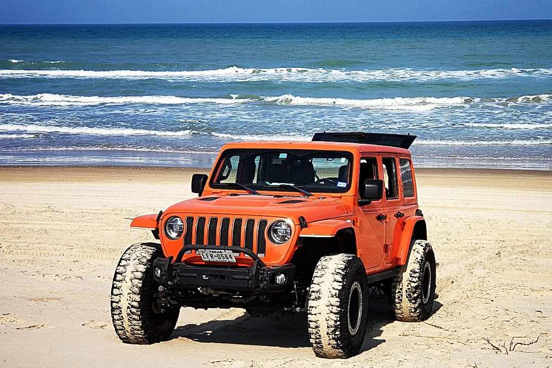

Jeep Wrangler JL Assfrow, Yokramer, and Remorseless's Circle jerk thread PSX_20220602_144230
38s on only 2" lift.
