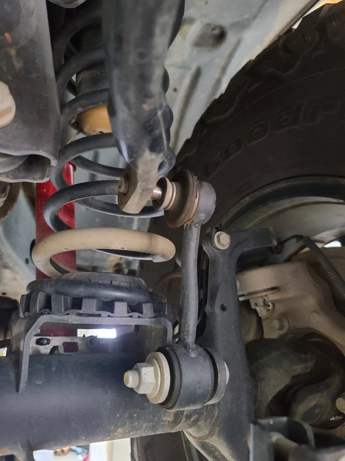

Just did a lift and same issue in mine. 21 jlurd, 27k miles. It had been gone for a while!
Yea, my story didn't end well lol
I kept putting it off until I took it into the dealer a couple months ago. I'd let it go so long that I had to replace my sway bar and end links... out of warranty at this point so it was 700 bucks. Expensive lesson.
