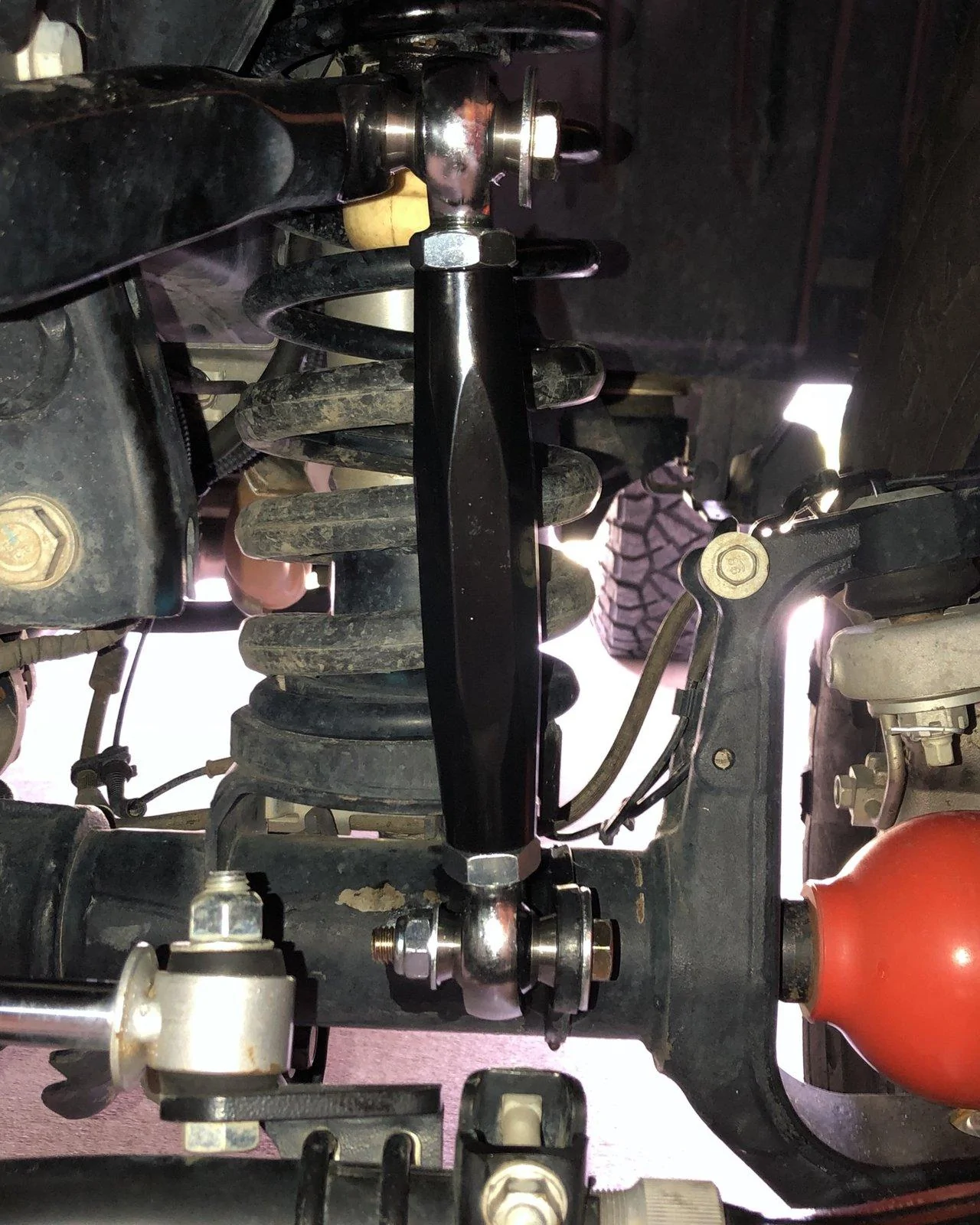

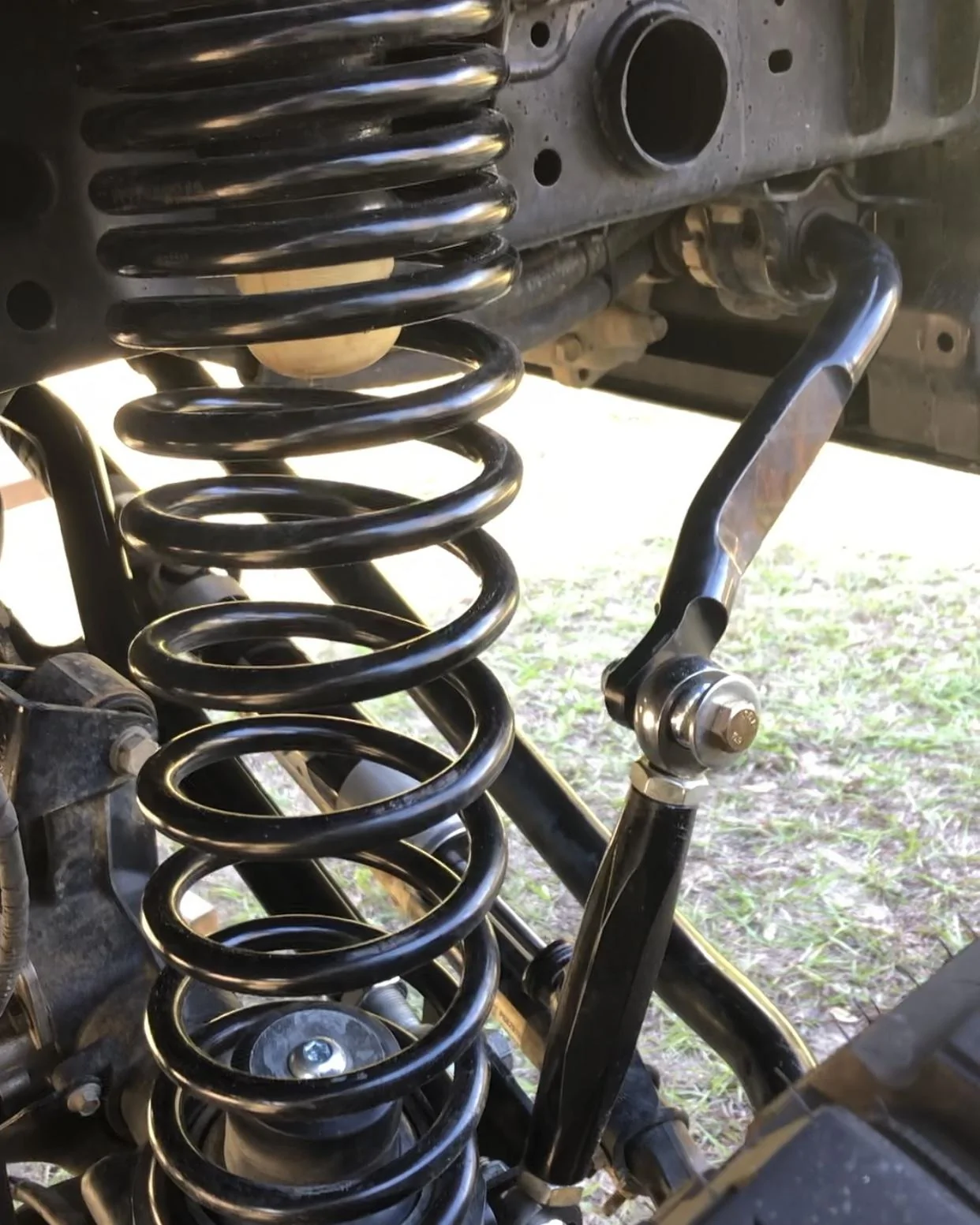

I got the rk no limits links, they’re made specifically for the rubicon elect disco. They work great.......
Jeep Wrangler JL sway bar link question... 3E8A7EE8-1AC1-4854-9E87-F258D4EA6C3E
Jeep Wrangler JL sway bar link question... 6B860BE7-B129-4CA1-9168-7DCF1C835BCB

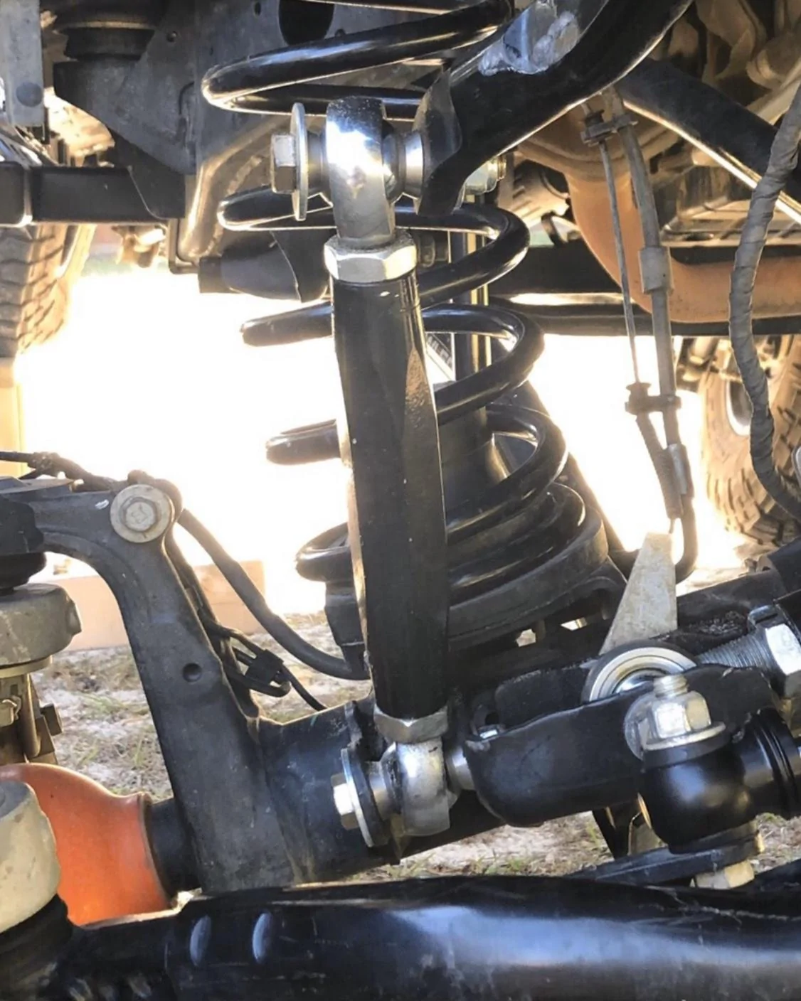

Here’s a better angle.......
Jeep Wrangler JL sway bar link question... 49A536A5-2A4E-4048-A31F-D8FFA15B0081
They allow 60 degrees of misalignment. Even though the bar is disconnected, it doesn’t move side to side so as the axle drops and you’re connected to it, the link needs to misaligned in order for you to get the full potential from being disconnected. Anyway ....just trying to help out a fellow Mountaineer, although I went to Marshall, lol, I like to give out as much information as I can. I know that I like all the details I can get when I’m looking at something, good or bad.
The only negative thing so far I’ve found is they are a little pricey, and apparently they look a little gimmicky...( no offense Zach )lol.
FWIW I got mine from Marcus @River City Offroad on here, he’s great to work with and gives a discount to forum members.....,:)
