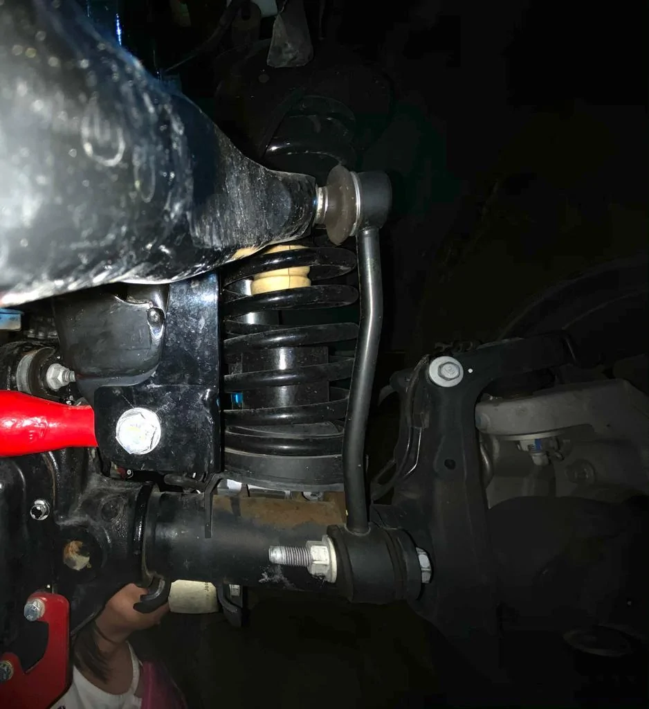

My Jeep just came back from the shop, and while I go over the suspension (EVO MFG Overland 2.5"), I think the Sway Bar Link isn't installed correctly. See picture (Driver side). I check the Installation PDF, and found this statement, but I don't understand what it means.
"Install FACTORY REAR swaybar link onto the front axle and front sway bar. Rubber bushing side on factory link goes inside the two tabs on the front passenger side axle and stud mount to outside of swaybar. Bend in link should jog upwards moving studded end toward tire."

That is correctly installed, including the orientation of the lower bolt, and the lack of a washer between the nut and the bushing. That’s how it comes from the factory.

Thank you!!!!
