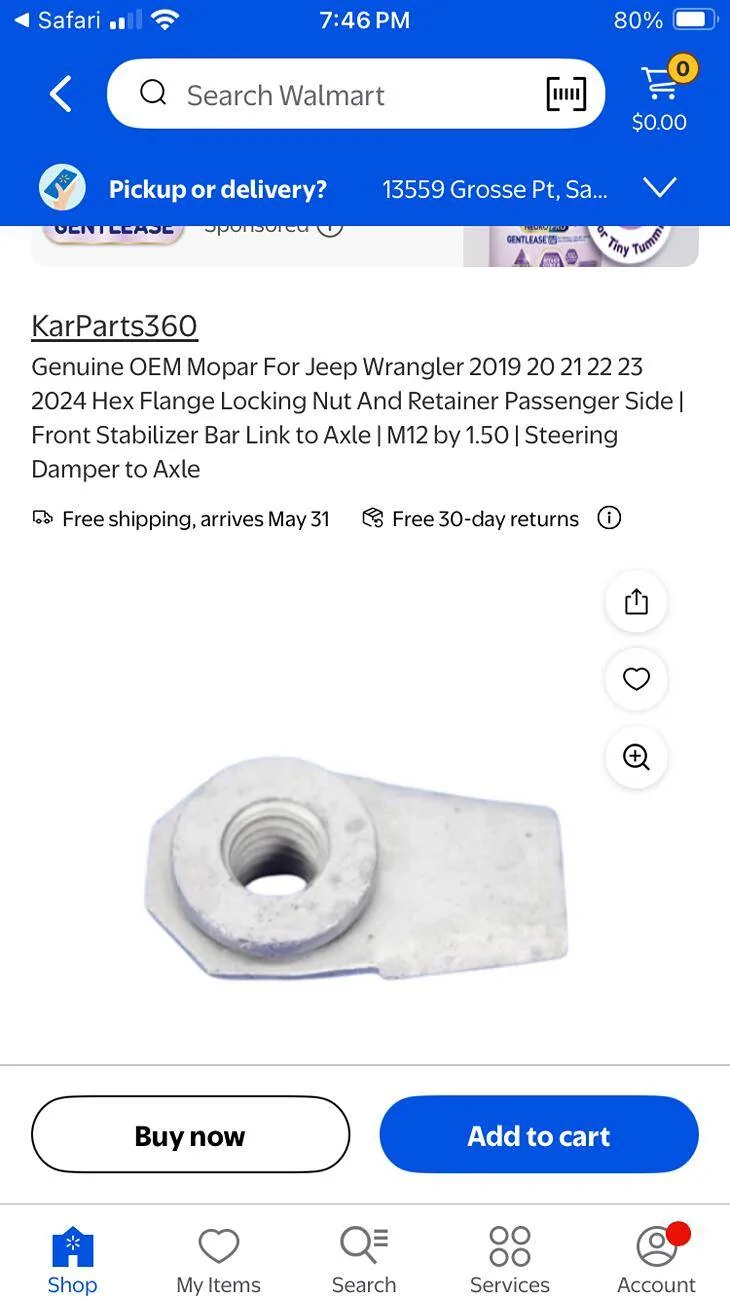

So I disconnected my sway bar today but forgot to grab the flag nut on the passenger side. Of course it was missing when I went to re-connect. Dooh! :facepalm: I can't seem to find this part anywhere? I suppose I could just get a flange bolt, but the flag one is so much easier to bolt back up. Has anybody sourced this? Thanks!
Need this!
Jeep Wrangler JL Sway bar end link flag nut? 1748399143271-k0

I've yet to find any that I like that work with stock height suspension. Some say need wheel spacers. Others need min 2" lift. More say cutting or grinding required. Only JKS seem to fit with my setup, but can't say I'm impressed with them.
Removing the stock one's really aren't that bad. Takes me 10min max. Sometimes finding level ground can be a challenge when reconnecting, but so far haven't had an issue until yesterday when I lost the nut. Buying a few of them now!
