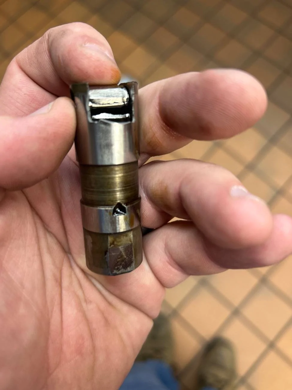

tell that to this 6.0L. 6.0’s don’t have AFM.
Some 6.0s had AFM. I had one with and one without. From the varnish on that lifter, it's likely the hydraulic piston got sticky and hammered that roller. Neglect, cheap oil, etc., could all be causes. I never saw varnish in any of the LS engines I had, but I ran M1 in all from day one.
The plastic basket actually broke on this one, the litter rotated sideways and the cam is in much better shape than your expect. Nobody takes neurotic care of their engines like forum people. It doesn’t make much difference.
