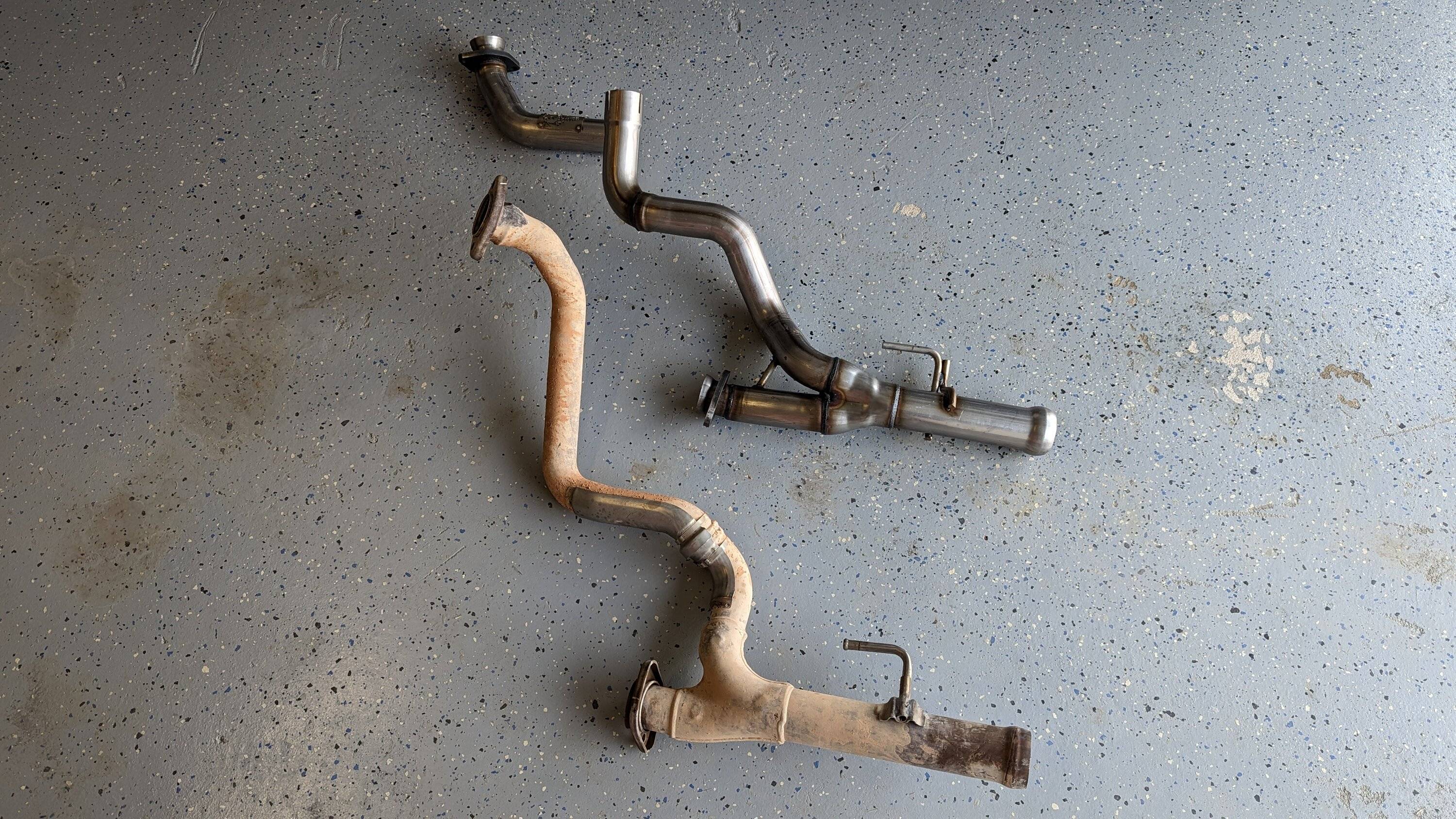

...and done! The install was very simple and straightforward; easy solo DIY job. I drove up on ramps just to have a little extra clearance, but it wasn't necessary. Basic hand tools are all that's required, but a flex-head ratchet and ratcheting wrenches are a bonus (you'll use 13, 15, 17, & 18mm).
No additional volume or obnoxious noises at idle or cruise, but a good deep tone under heavy throttle in the upper-RPM band! Very happy with the part. Fit & finish was perfect and slipped right into place.

Just curious, but what are you running for everything back, like cat, midpipe and muffler sections?

This was the first exhaust mod so the remainder is still stock. I will likely add aFe's midpipe w/resonator next since it is also a bolt-in affair.
