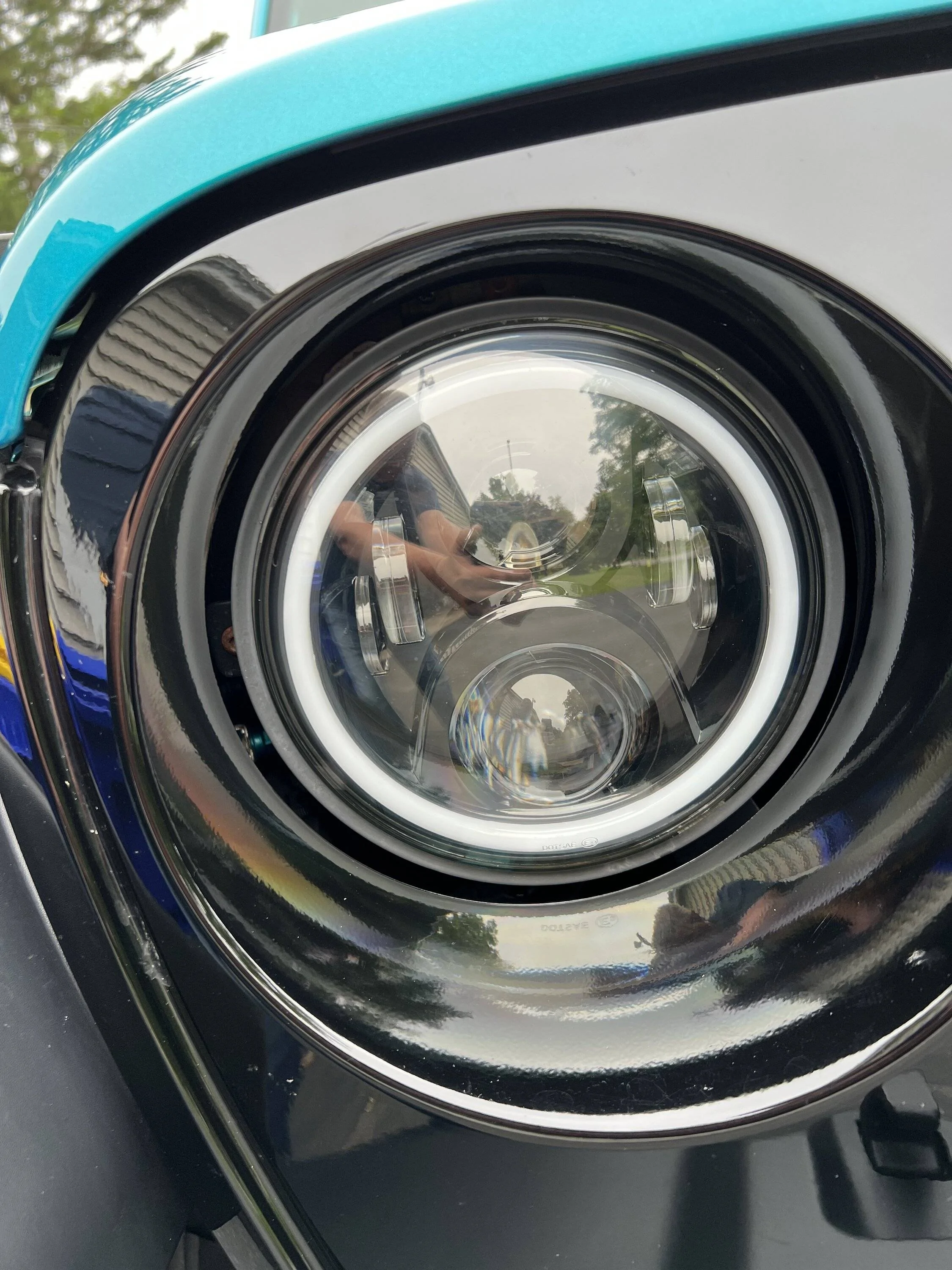

1) Headlights…. Seem to work very well and I know that by the brightness they must be LED lights as well as HALO lights. The HALO’s are pretty close to the color of the Jeep and that is pretty neat in itself.

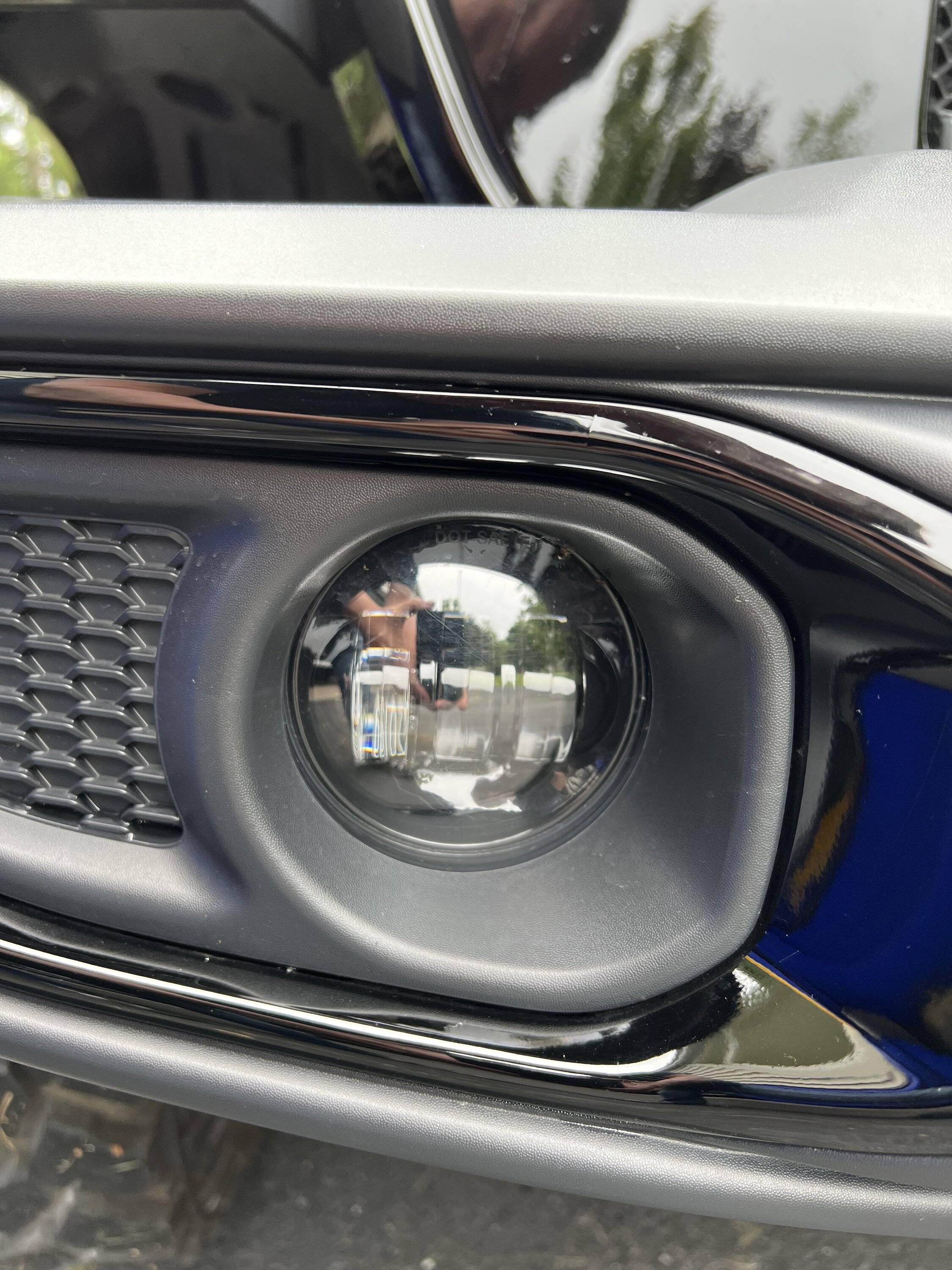

2) Foglights…. Great brightness and a nice white beam right where you need it. Seem to be a similar manufacture to the headlights and for sure LED. Have thought about adding some Yellow lens covers by Laminate-X.

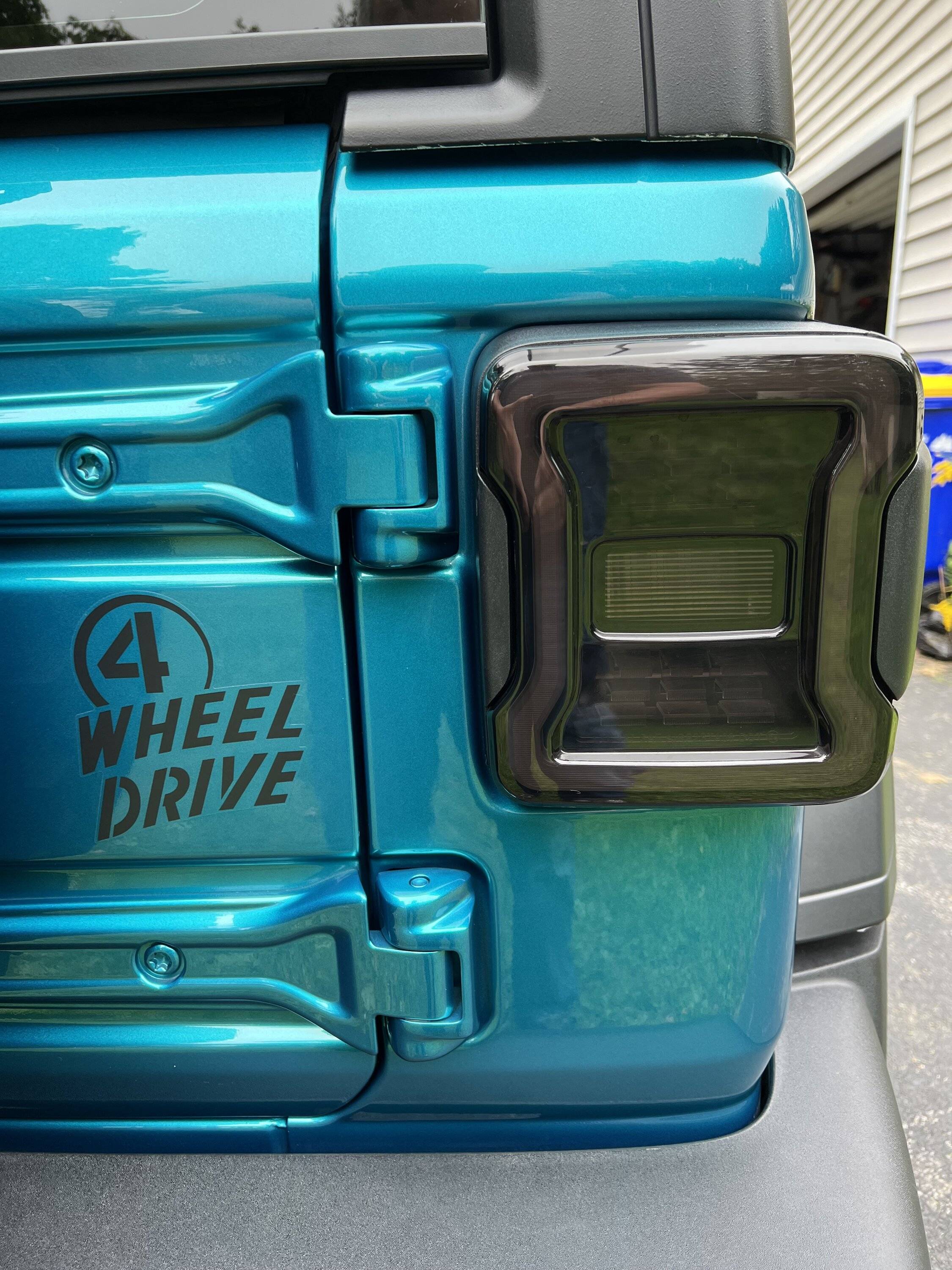

3) Smoked Taillights…. These seem to work fine. Not sure of the manufacture. Part of the old school me would sometimes like the stock ones.

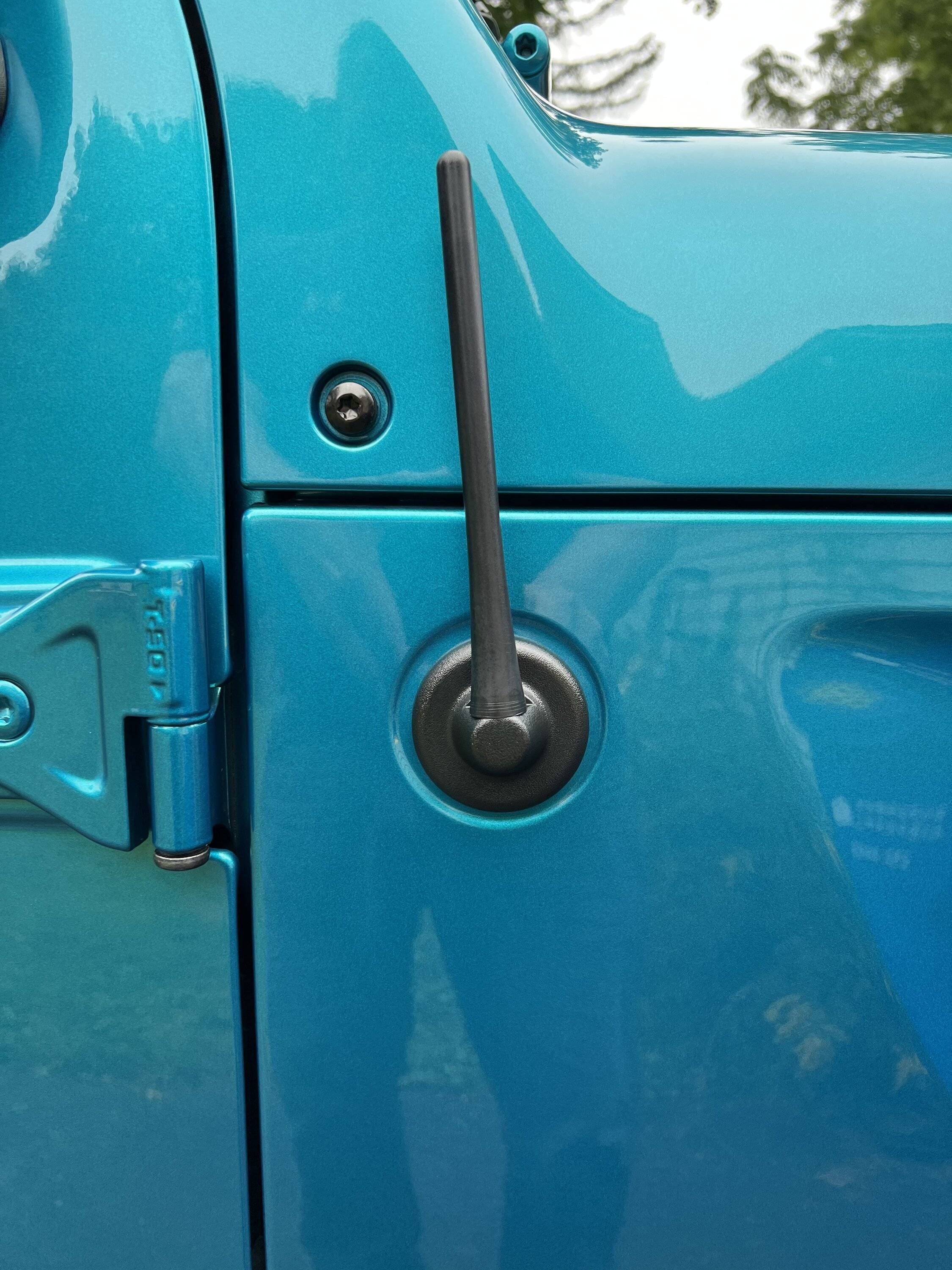

4) Stubby antenna…. Not sure of the manufacture but it seems to work well and I like the looks of this to be sure.

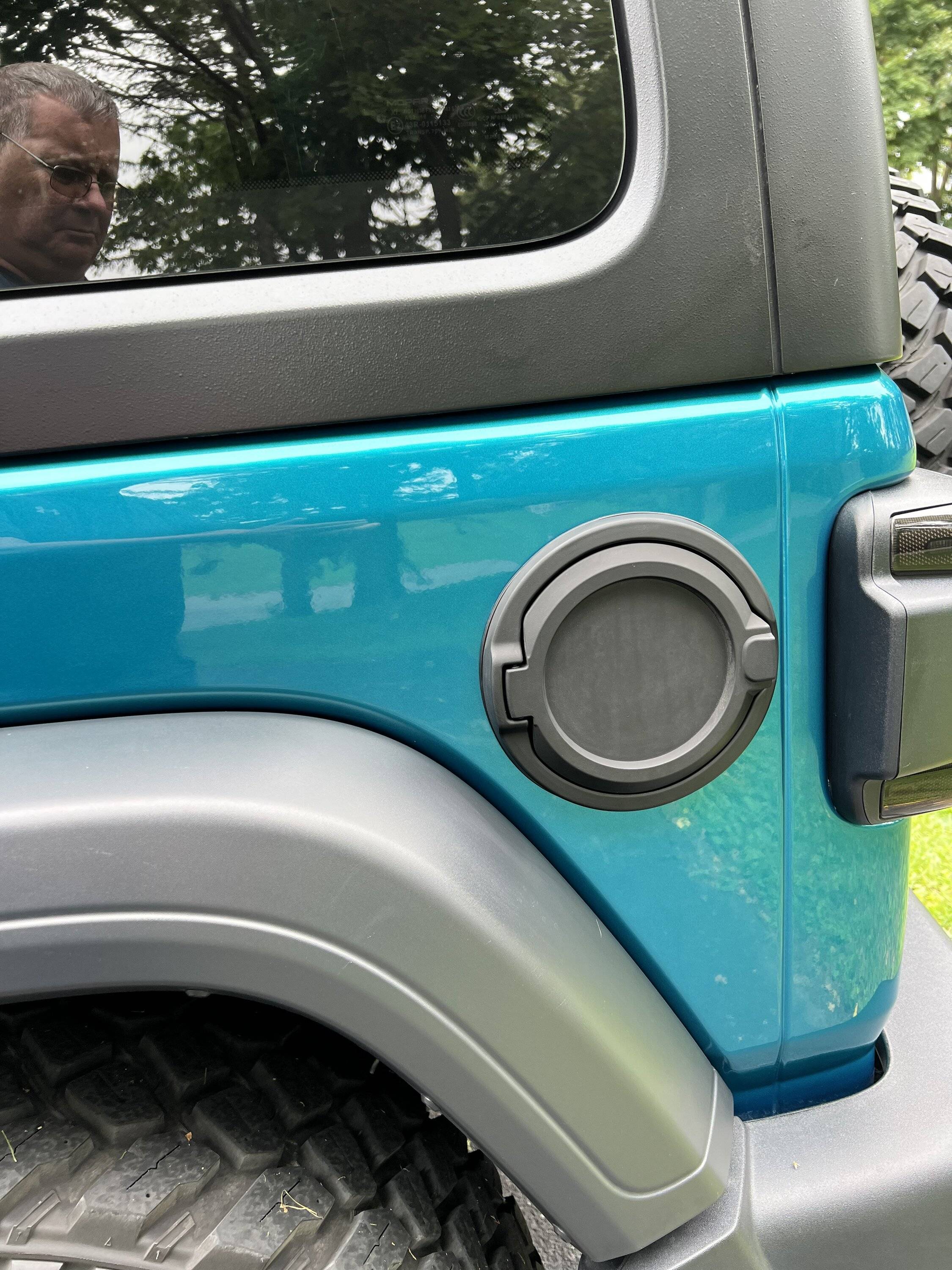

5) Fuel Filler door…. Not the MOPAR one but it’s there. Seems slightly exposed to the sunlight so it’s a shade or two lighter than new. For now it’s fine, but may have it powder coated or replaced by a Mopar one in the future.

The headlights on your JL are aftermarket fitments. Provided they're aimed correctly so that oncoming drivers' vision isn't compromised, and their down-road lighting is acceptable to you (in that order), there's probably no call to disturb them.
I do prefer yellow lighting for fog lights, and have upgraded my OEM bulbs to yellow LEDs accordingly. The Lamin-X film, which you seem to be aware of, is a lower cost and faster way to accomplish the same thing.
Tail lights: I don't like the aesthetic of smoked lenses, but that's a subjective preference. I've installed the Oracle flush mount LED tail lights in order to provide needed lighting when in Reverse. The expense was worth it to me. Just a thought.
Antenna: I've the popular 13" Ryondair antenna on my JLU. Reception sometimes suffers, depending on geography. This choice will depend on how frequently you listen to terrestrial radio. I do like the aesthetic of the shorter antenna, to be sure.
Fuel filler door: Again, a subjective choice. I also installed one on my Jeep. My OCD insisted that the gas cap not be exposed. ;)

I’m not huge on tinted tails and your radio reception may not be the best but overall the changes look mostly functional.

Good idea on the Oracle flush mount LED tail lights. I like to have very GOOD visibility for myself and others. These tail lights while functional, look slightly subdued to me. I’ll have to look into those for sure.
The Headlights and foglights seem to work better than halogen stock lights. I have the Laminate-X lenses on my 2020 Subaru Outback and they have worked very well.

The Oracles play nice with the Jeep's electronics only when replacing factory incandescent tail lights without the Blind Spot Monitoring option.
This thread describes the fixes for "Lights Out" dash warnings, and/or hyperflash, that may occur when the Oracle flush mounts are installed on a Jeep that was built at Toledo with LED lighting. Essentially, use of a Tazer or JScan is recommended. So, you may be in luck if your Willys had incandescent tail lights as original equipment.

If it was my jeep I would swap out the aftermarket headlights for something that fits more like OEM. I'm sure they work fine, but those appear to be 7" head lights vs the JL's 9" headlight. Im not a fan of the gap.

All those mods seem harmless and are personal preference. I've heard some complain that certain smoked out tailights aren't bright enough for others to see in certain conditions, but those ones you got are fine.

I like the look of your Jeep. 7” LEDs are probably 1/2 the price of 9” Oracles / DV8, etc and would I keep them if they work for you. Not sure of the stereo you have but look at Terra Acoustics Sound Stage for the front sound stage and maybe some Select Instrument pods for the Soundbar.

If you don’t like the smoked rears, you may be able to get a straight trade for stock ones in the forum.
Swap is quick and straight forward.

I have yellow Lamin-x fog light film and it works quite well. An installation tip, install them when it is warm outside. Much easier. As for the fuel door, I tried a few aftermarket ones with poor results. Ended up purchasing a Mopar door and it fits and operates perfectly. Enjoy your Wrangler!

The headlights look like Axials and the fogs look like DV8’s.
I had The axials but swapped them due to light bleed and being a 7”. If you like them and arent getting flashed, keep em. Just watch around the adapter bracket as they tend to rust really bad.
I still have the DV8 fogs as they work great.
