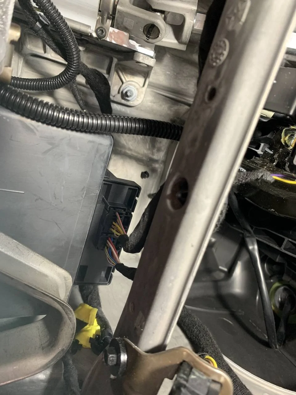

These are what I need to disconnect and connect my cables to, right?

Old Fart
This is what I need to disconnect and connect my cables too, right?
Yep. Good luck.
Should not be too bad. You don't have the premium sound system amp in your way. My 2018 was much easier to do than my current 2024 with all kinds of stuff jammed up in there.
Still worthwhile getting the SGW cable extenders from Z automotive.

Gotcha. My son’s JLUR has the premium system in it, so I’ll probably get the cables for his. Will keep you guys posted!
