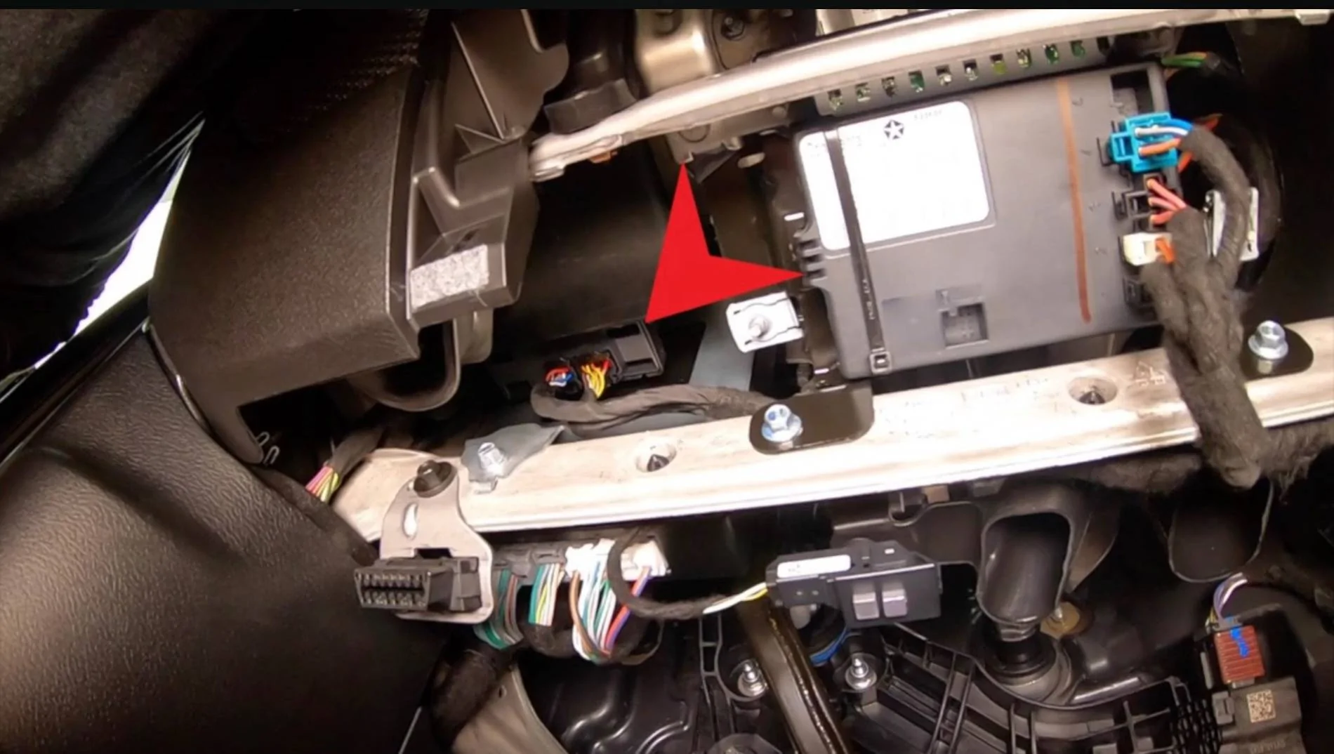

After seeing this image I understand why some of the threads said getting to the gateway was going to be a pain. I don't have that module behind the diagnostic connector or the amplifier (?) to the right of the SGW. Mine is a no-option Sport; it took me longer to get the camera to focus for the pic I posted of the connectors than to disconnect them.
Ran out of daylight so I didn't get to install the tires, but at least I know I can get to the SGW very easily in my JL.
Thanks again for all of the help and quick replies!

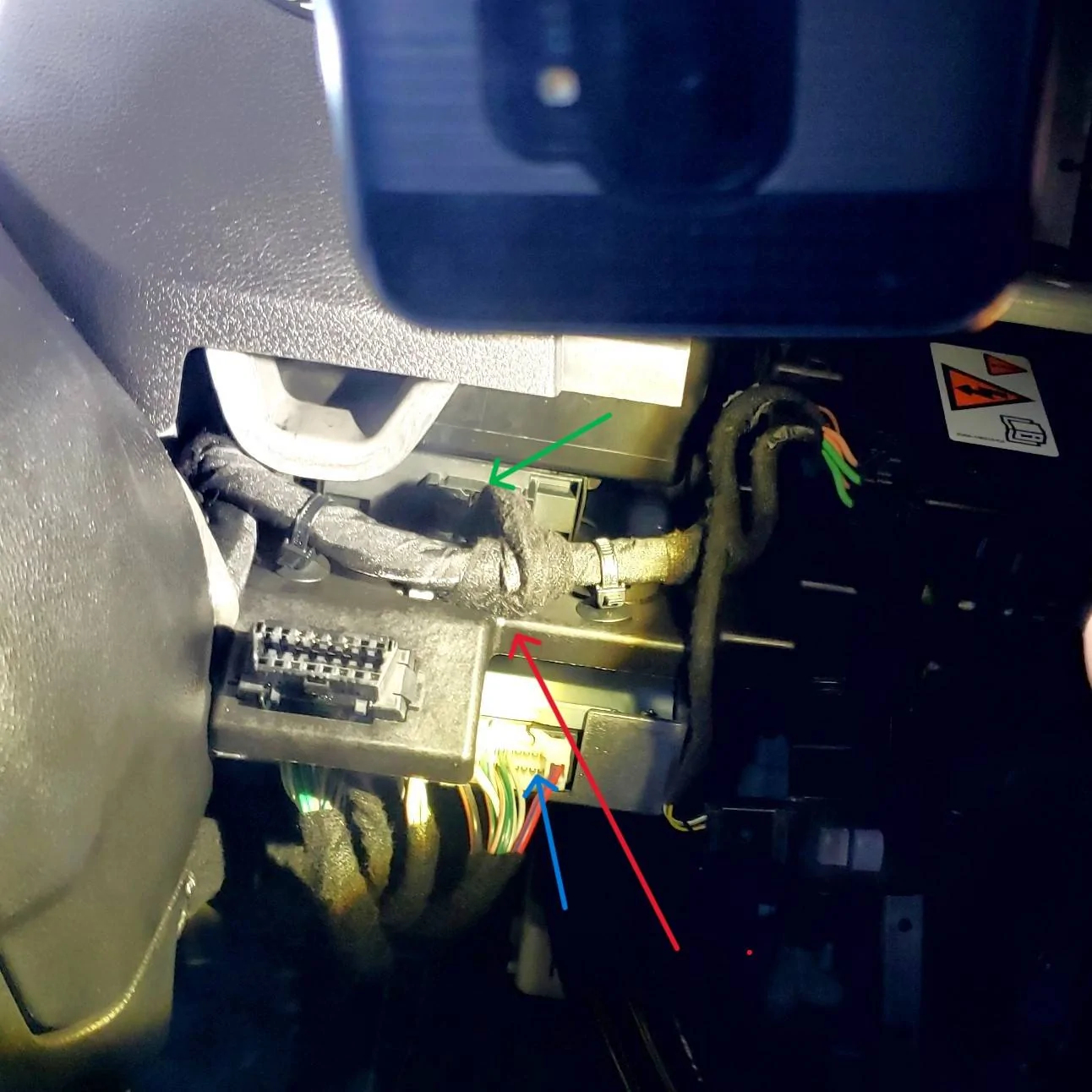

That pic is easy compared to the 2024 arrangement. Green arrow points to the SGW connectors, red arrow points at the black bar that seems new in 2024, blue arrow points to alpine premium system amp. That said, I managed to get them out, put in an extension cable, and never again.
