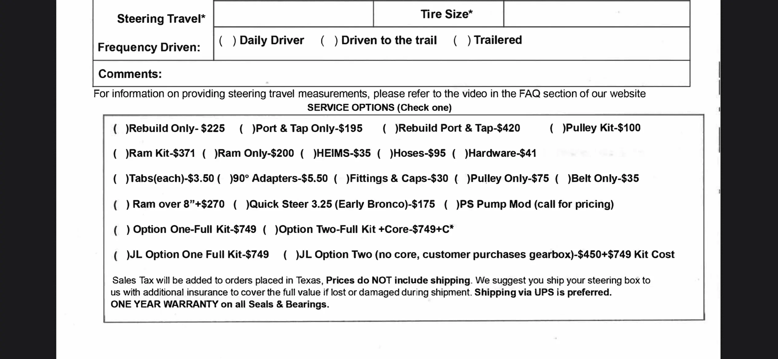

You ain’t nothing yet…wait till your first trip to Moab in your EV. Spend half of the day trying to do a 3.5 rated trail. Then the other half of the day trying to get out of the trail and back to the motel only to find all the chargers are full and your overnight charge will be all tomorrow!
I am on the road for about 3 weeks rolling heavy about 23,xxx lbs, my driving range on my OEM tank of diesel is about 450 mi at almost 10 mpg at 75 mph.
Filled up yesterday @ $3.99.9 gal
EV do that? Ya think?

Well since I started this thread I thought I would come full circle.
I installed the Redneck Ram set-up about a year ago. I had to ship my box back and forth to West Texas three time in order to get the hose fittings in a place that would function with the 2.0 since they had never done one. Ultimately they bought a new box and set it up. The ram size is critical so pay attention to that or it could leak, like mine did initially. I added a cooler "just because" even though they said I didn't need it.
So, in the last year put 12,000mi on the Jeep, did 21 BOH trails and wheeled from PA to Moab to Colorado to Big Bear. The hydro assist makes a massive difference. I rarely feel any resistance steering compared to the zero steerability without it on the rocks. Occasionally it will give a little resistance, but overall it was an awesome upgrade, especially for the price. The PSC stuff is very nice, but it wasn't available when I went down this rabbit hole and it's 3-4x the cost. FYI-running 37" beadlocks around 10psi off-road.
