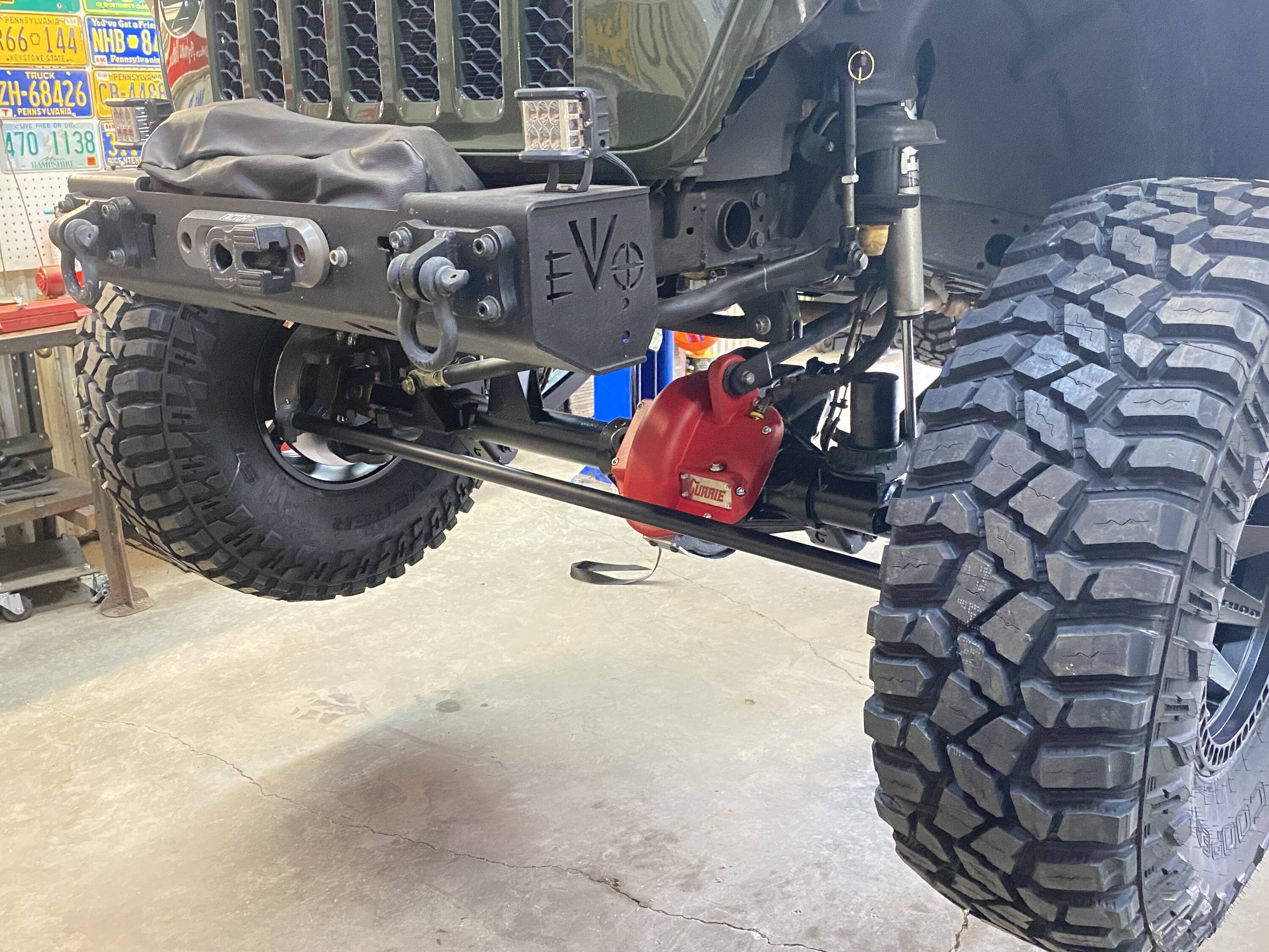

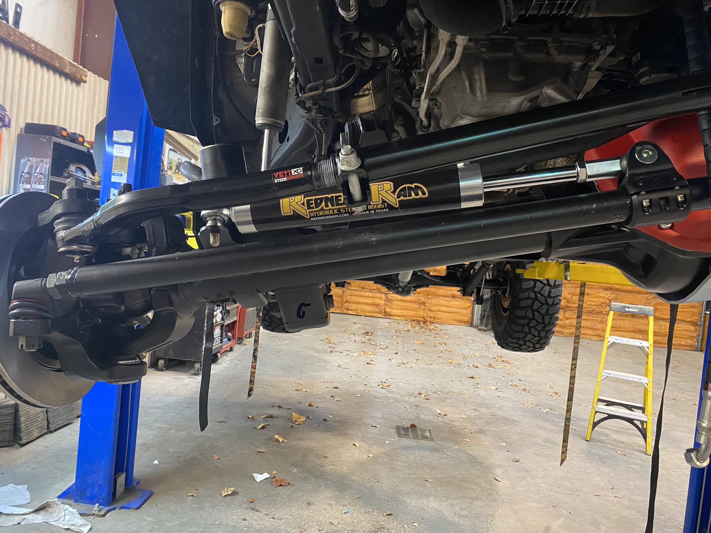

Can someone please tell me which end of the ram the hoses from the top and middle of the factory ported steering box go to?
My truck has been on the lift way too long and I just want to get it finished up tonight.
Just put a set of Currie extreme 60s in and am now trying to button it all up. The hydro is the last piece of the puzzle.
Yes, it’s a Gladiator, but the front half applies here ?

Drivers side of ram to bottom, Passenger side to top
Thank you very much. Just to verify, I should have stated that the ram is mounted in the normal orientation as would be on the factory Dana 44. Pushing from the passenger side.
