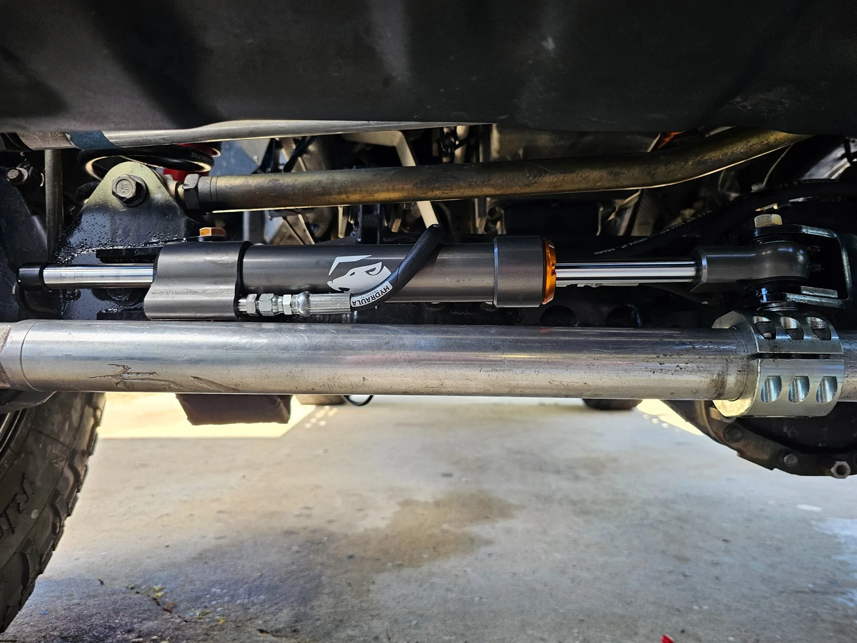

Just installed Apex Through Shaft Ram - High Mount
gonzoflick
Jul 20, 2023
47
359
449
St.Petersburg, FL
TBD
It was very intensive as I had to remove and reinstall steering box by myself in the driveway. Holy shit that thing is heavy. It kinda feels a little strange. Like I don't feel much of an improvement on road, but Im already running the Apex boost kit. Maybe I will feel it on the trail. I hope its working I can't actually tell. Like is fluid flowing like it should? I ported the box myself. I also feel some dead space in my wheel when I turn back and forth. I was coming froma Fox ATS stabalizer and steering was tight.

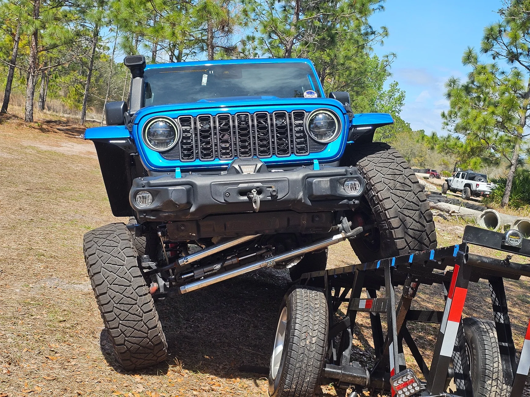

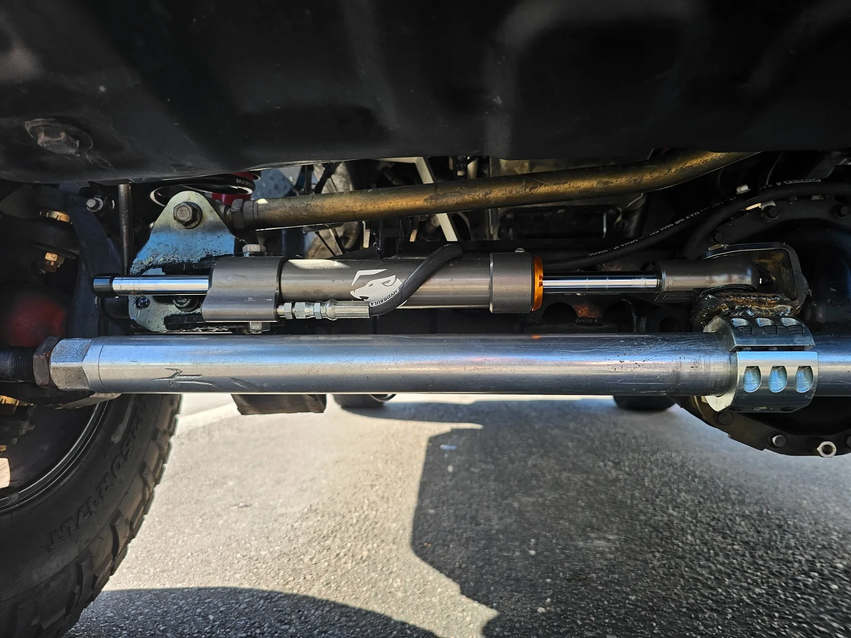

UPDATE: my issues were all around the drag link being lose and me not following instructions to weld the bracket to tie rod.
Jeep drives amazing now. Took it on some hardcore rocks this weekend. The TSR didnt bat an eye. I had full lock to lock steering on rocks aired down to 10psi and full lockers. This thing is a must consider if you are thinking hydro. It looks much better than PSC, operates the same even maybe better because of design. Way cheaper too. Do it!

Glad to hear you got the issues worked out. I have a built 4XE on 40s and this or the PSC kit is the next upgrade on my list. We have a trip planned out to Sand Hollow this september and I'll be doing one of those before that trip.
How is the on road/daily driving experience? Biggest thing I'm curious about is how the thru shaft ram is vs a standard ram. I had a hydro assist setup on the JK I used to have so I'm familiar with a standard ram setup so just curious how the thru shaft feels.

What was loose, the bolts, worn ends, etc.? What wasn't welded that you then welded? I looks like you still have a bolt on clamp on the tie rod.

Drives fantastic on road. Don't notice any difference between this and my Fox ATS. Offroad though this thing moves bulders.
