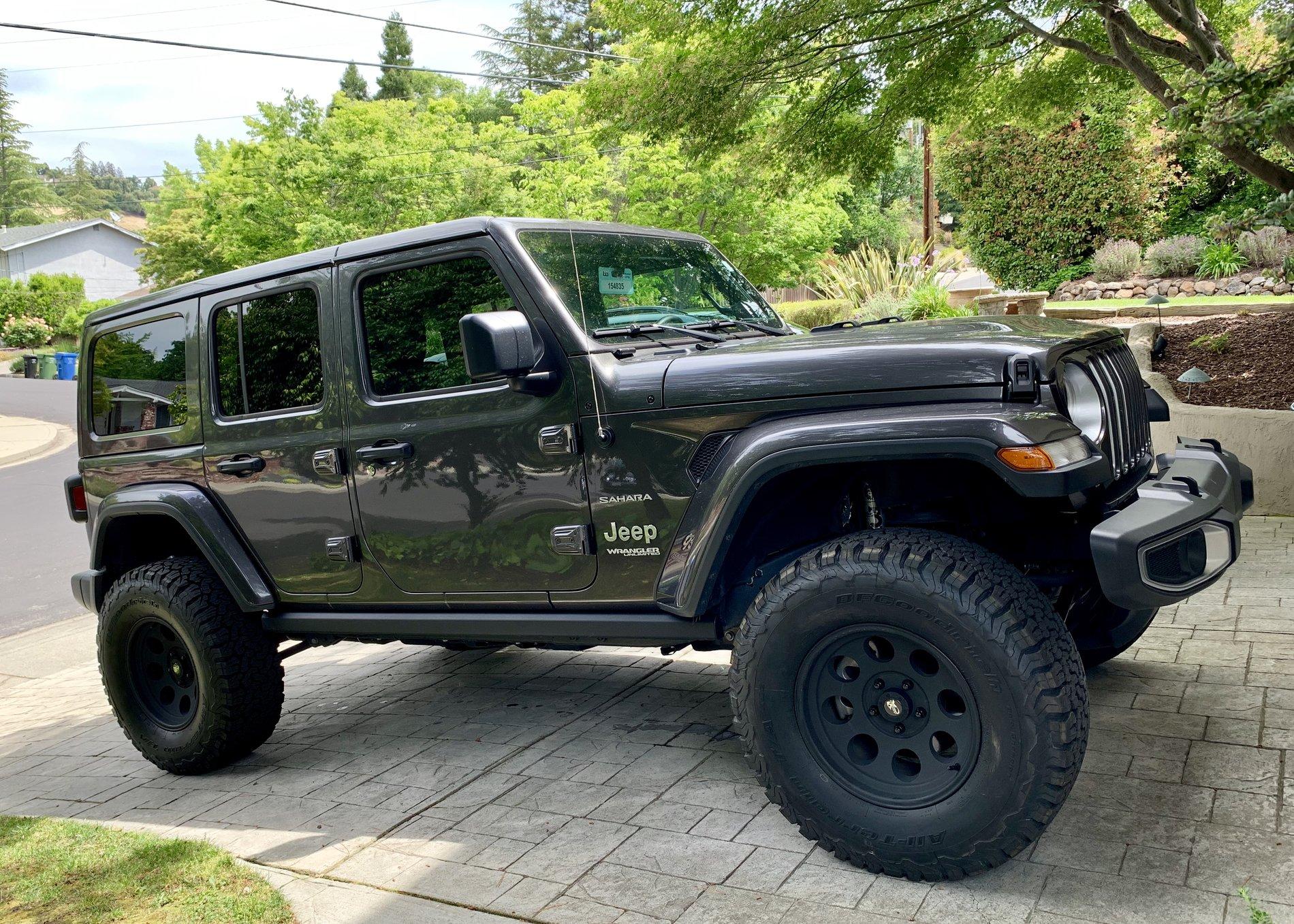

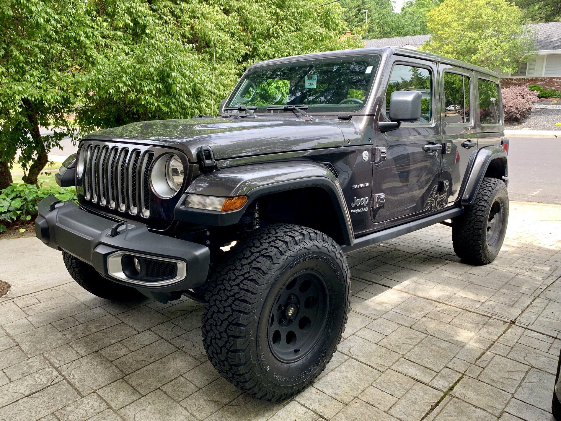

I just did the Mopar 2” also... gave me 3.5 of suspension lift and the 35’s an additional 1” from the 285/70/17 KO2’s I had. Both of which keep me below 6’6” for low garages in Northern CA. I went with the C ply KO2 and honestly my ride is both quite and soft. My one complaint is the brakes are a bit softer... but that is something I’ll address with heavy duty brakes (come on a Rubicon) as my stock Sahara brakes wear out.
Take a look at your window sticker, both the Sahara and Rubicon have the same heavy-duty brakes .

Yes, I did some research on this after I had posted that comment and learned that they each had the larger brakes. I took it in for a road test with my dealer and it felt solid. As I have grown used to it, I realize it is not so much that they are soft, but that it simply takes more pressure to stop the mass of the larger / wider bit of tire.
