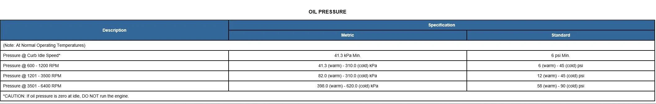

This isn’t your grandpas small block Chevy.
Are you saying this table from the FCA service manual is wrong? what data is correct? How do you know that?
It’s not “wrong” per se, but it’s not helpful or correct either. If you have a pentastar engine idling at 7 psi I can absolutely guarantee you that engine has significant internal damage and will be put in limp mode as soon as you attempt to accelerate.
The 3.6 is one of the only engines our shop will even bother to rebuild, and if we put one together that idles at less than 25 psi were pulling it back out to tear it down or replace it.

Sure, in a different engine. The 3.6 when new should idle at 29-31 and hit 75 within a few seconds when RPM exceeds 3500. There should be no noticeable difference in oil pressure from 1k-3499RPM. It is electronically regulated.
