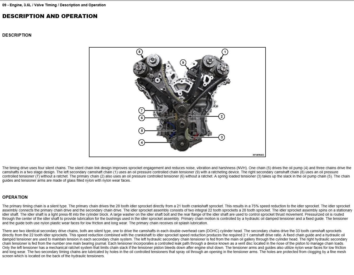

Another quirk about this engine is the 3 oil pressure driven chain tensioners. Until there is adequate pressure at these tensioners, some chain slack is possible. Although, 1 of them (for the driver side bank) has a ratchet mechanism to reduce the slack at shutdown/startup. However, the passenger side bank does not have the ratchet mechanism (at least on my 2018 per the manual) and therefore could have enough slack at startup to make some noise.
