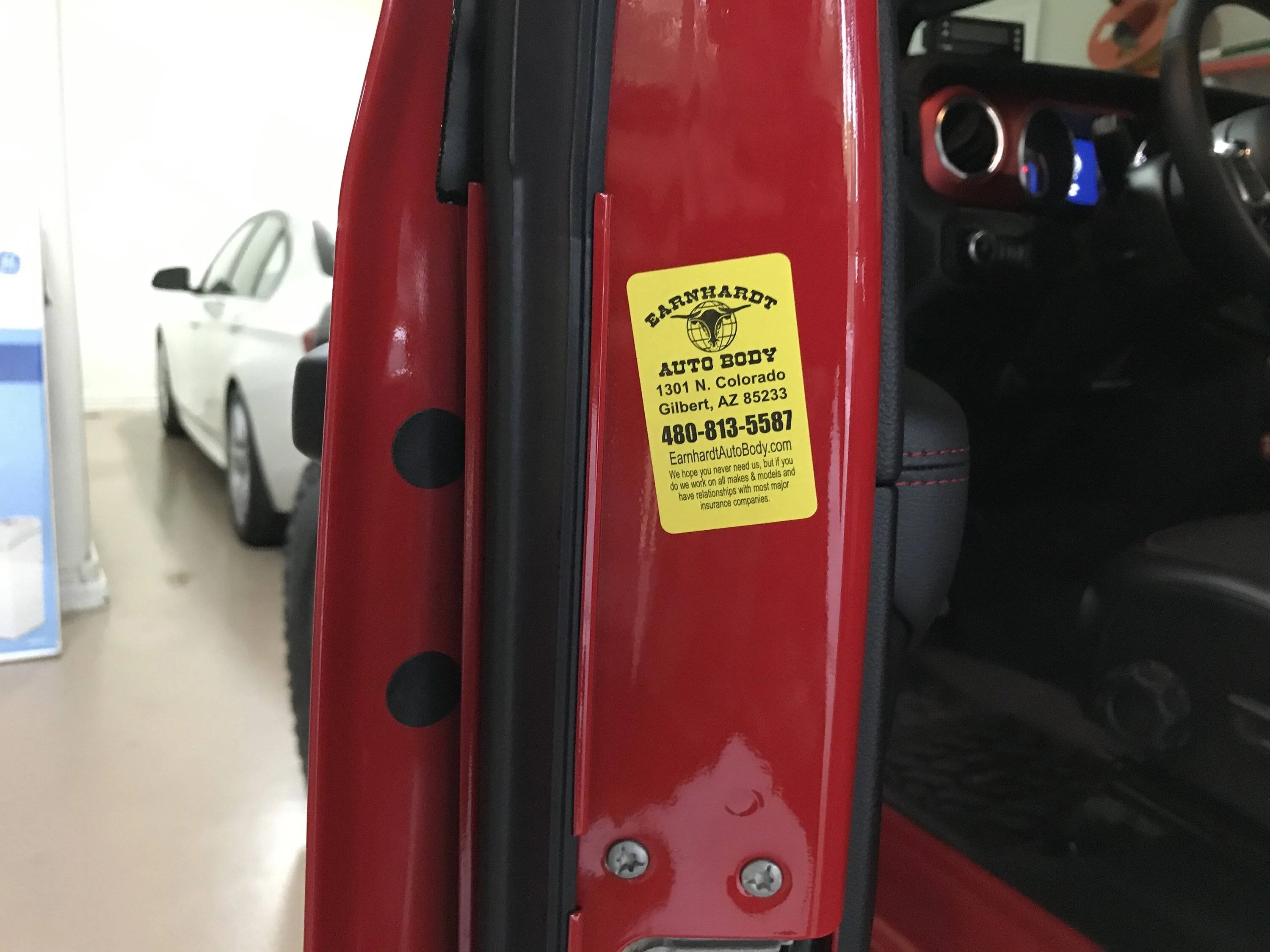

Mexico has been mentioned several times. Are you suggesting that Americans take more pride in their work? That may have been true a few generations ago, but not so much anymore.
Here's a small but telling example of the pride in workmanship at my (American) Jeep dealer:
