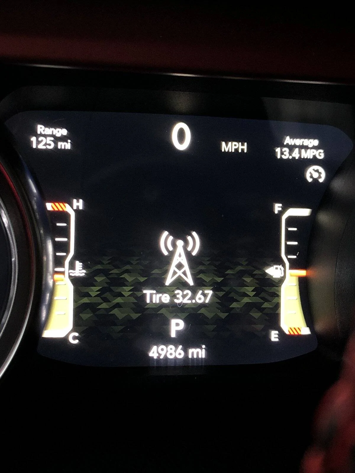

One can easily check what size the Jeep calibrates their tires with the tazer! As long as you haven’t changed the tire size, the default number will be the factory calibrated size. I happen to have a 2021 JLUR with the factory 33” BFGs and a tazer and I am now checking my tazer as I type this..
My tazer shows my stock tires as 32.67”
Yes, I too noticed a discrepancy between actual tire size and what my Tazer shows I need to enter in order to get an accurate speedometer reading.
For the speedometer to be spot-on, I had to enter a tad smaller size on the Tazer screen than I measured the actual tire to be.
