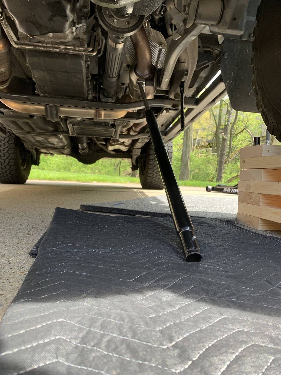

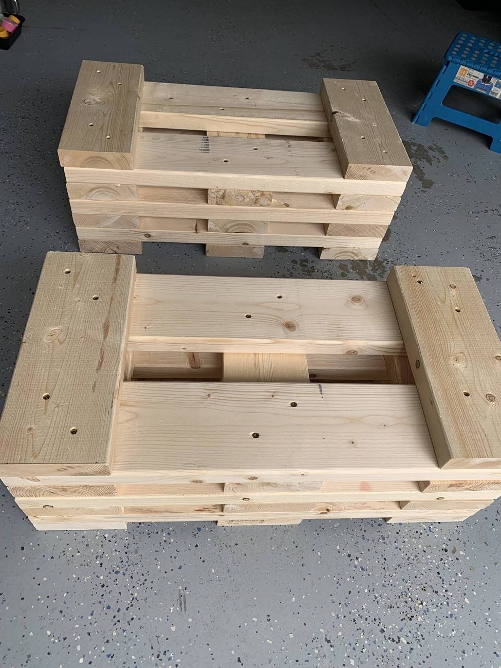

I didn’t use any power tool, built two wheel cribs for an extra 9” clearance, more leverage with the floor Jack handle, done.
