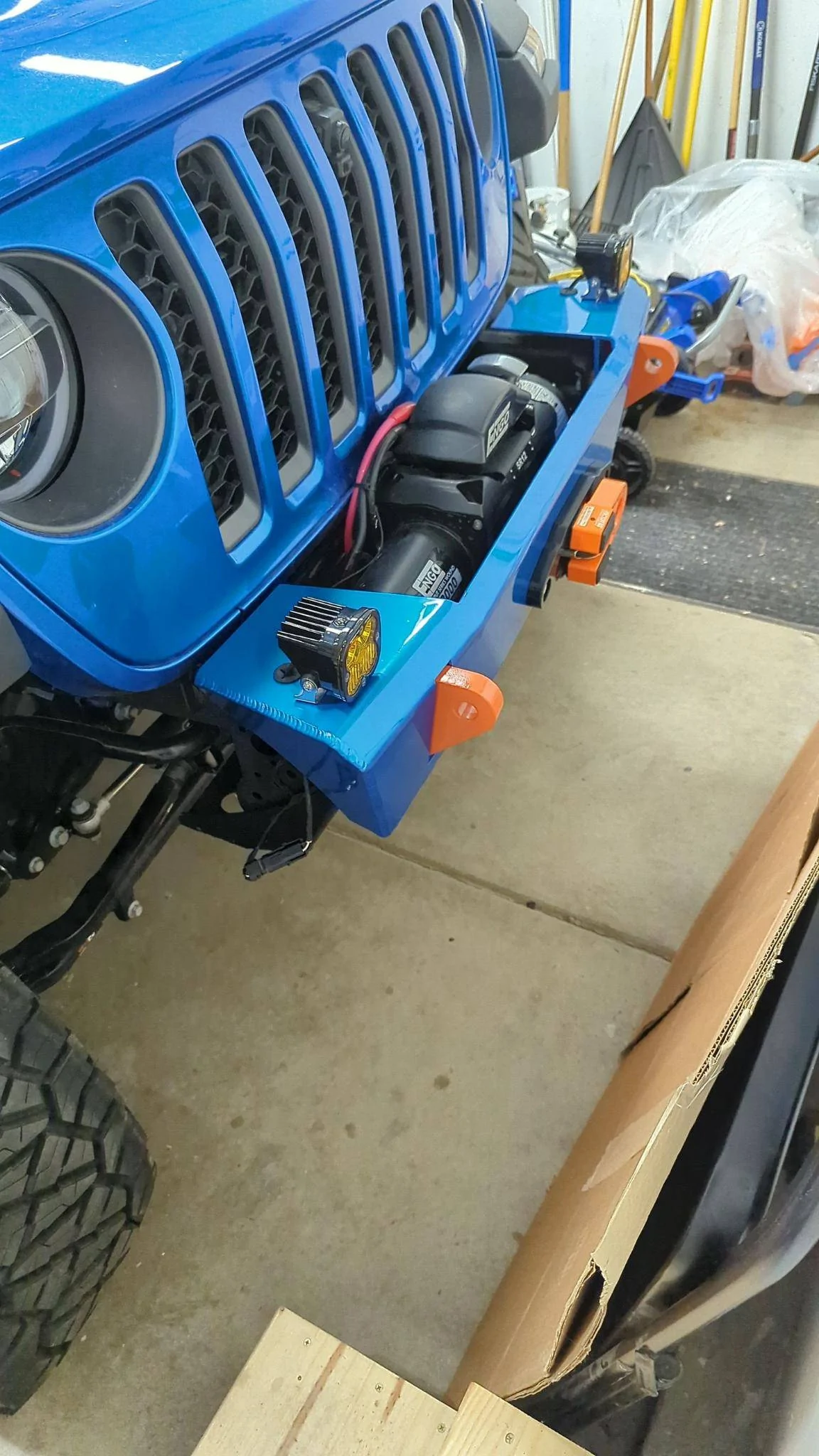

Next Venture Featherweight Bumper, color matched with Baja Squadrons and an Engo 12k winch.
I had to drill the holes to mount the Squadrons, but there's plenty of room under the bumper for them. My biggest complaint is the mounting system. It mounts directly to the frame horns and one of the 4 bolts on each side has such tight clearance that they ship you a bolt with a shaved head on it. I found it impossible to get that done so I'm actually running 3 on each side.

I'm pretty sure I have the redesigned version. I ordered it on your EJS sale last year and recieved it in May IIRC. I got the shaved bolt and there was a long slot to pop it through.
The issue I had was, once I had the bumper in place, there was enough play that the bolt could drop back and spin freely when I tried to thread the nut on. I couldn't get enough leverage on it to actually get the nut to tighten. The one idea I had was to get a couple tooth lock washers to keep the bolt where I needed it but at that point I had been fussing with it for a couple hours and decided to just pull them out and run three per side. I may go back and try to address it in the future, but I'm not terribly concerned about running it the way it is right now.

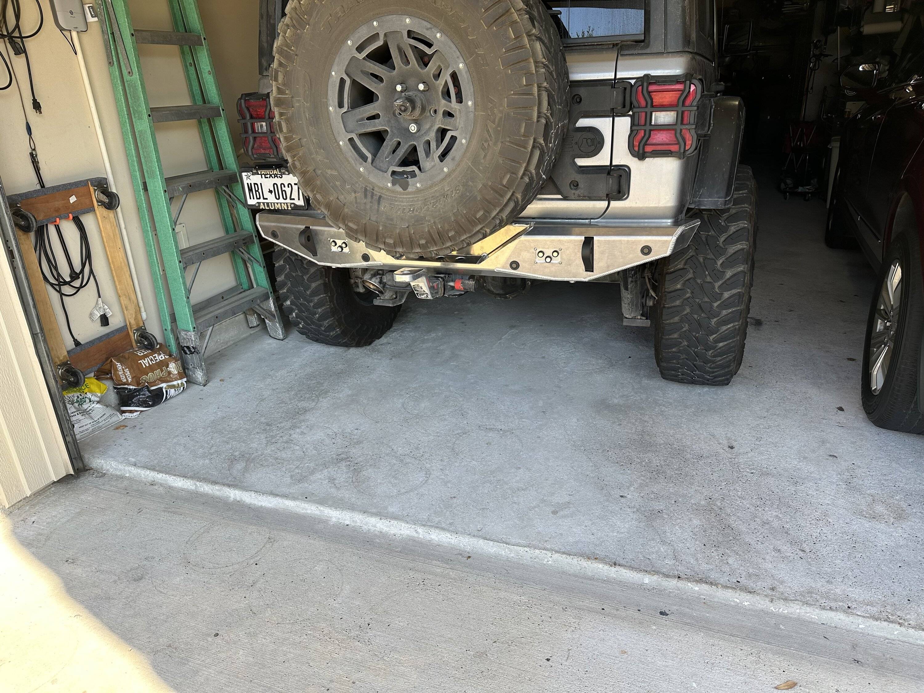

Did anyone just bolt their raw aluminum bumpers on? How are they holding up?
I have NVM featherweight bumpers coming and debating if I should put them on raw or…

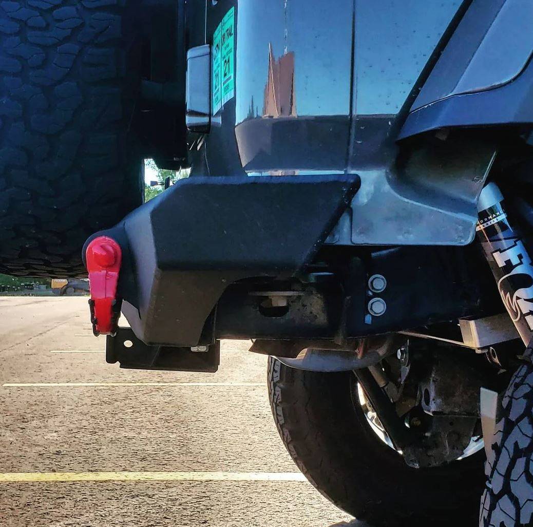

I just installed the NVM rear featherweight bumper. I left it raw, but don’t have any time yet to see how it does. I figure if it gets bad, I’ll polish it then and clear coat it.
IDK why, but I really like that one. Got a side shot by the rear fender by any chance?
Edit: Nevermind, I found one:
