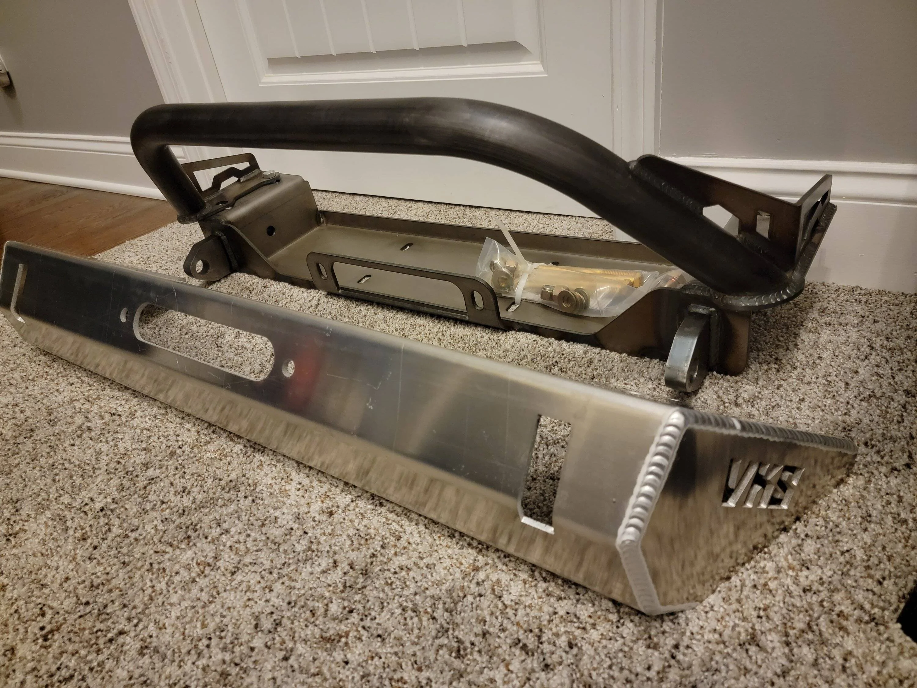

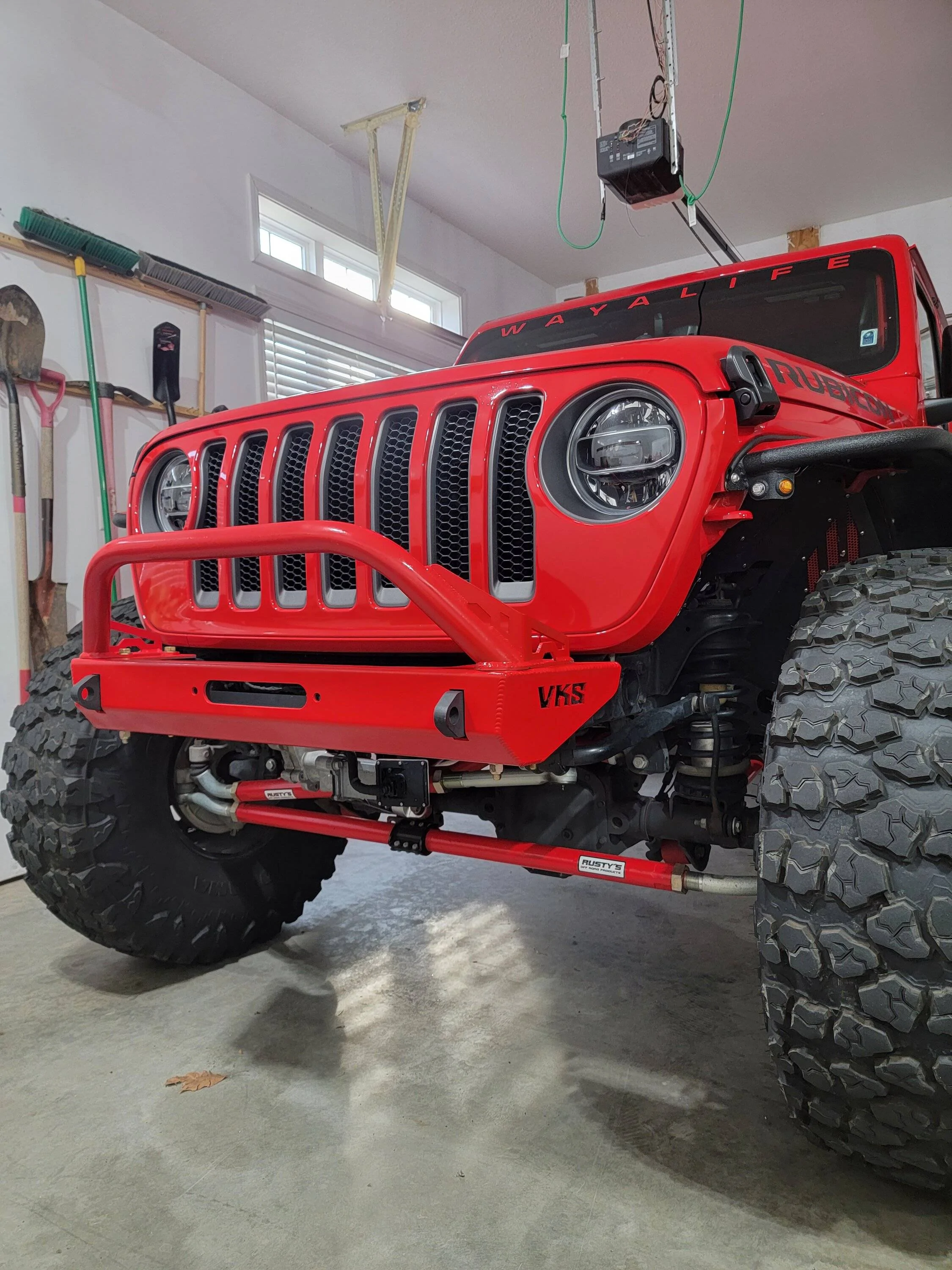

VKS aluminum frame chop shorty V3. 40lbs including winch plate (minus 10lbs of metal I removed on the frame chop, so net 30lbs).

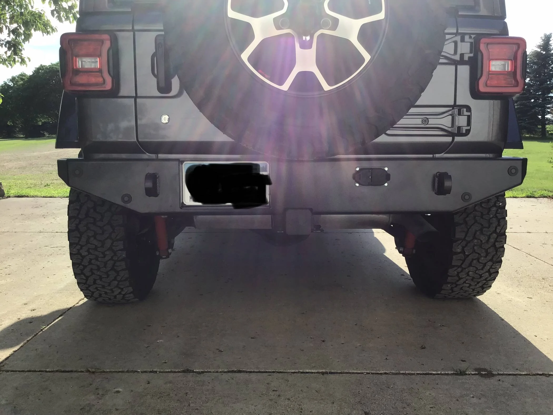

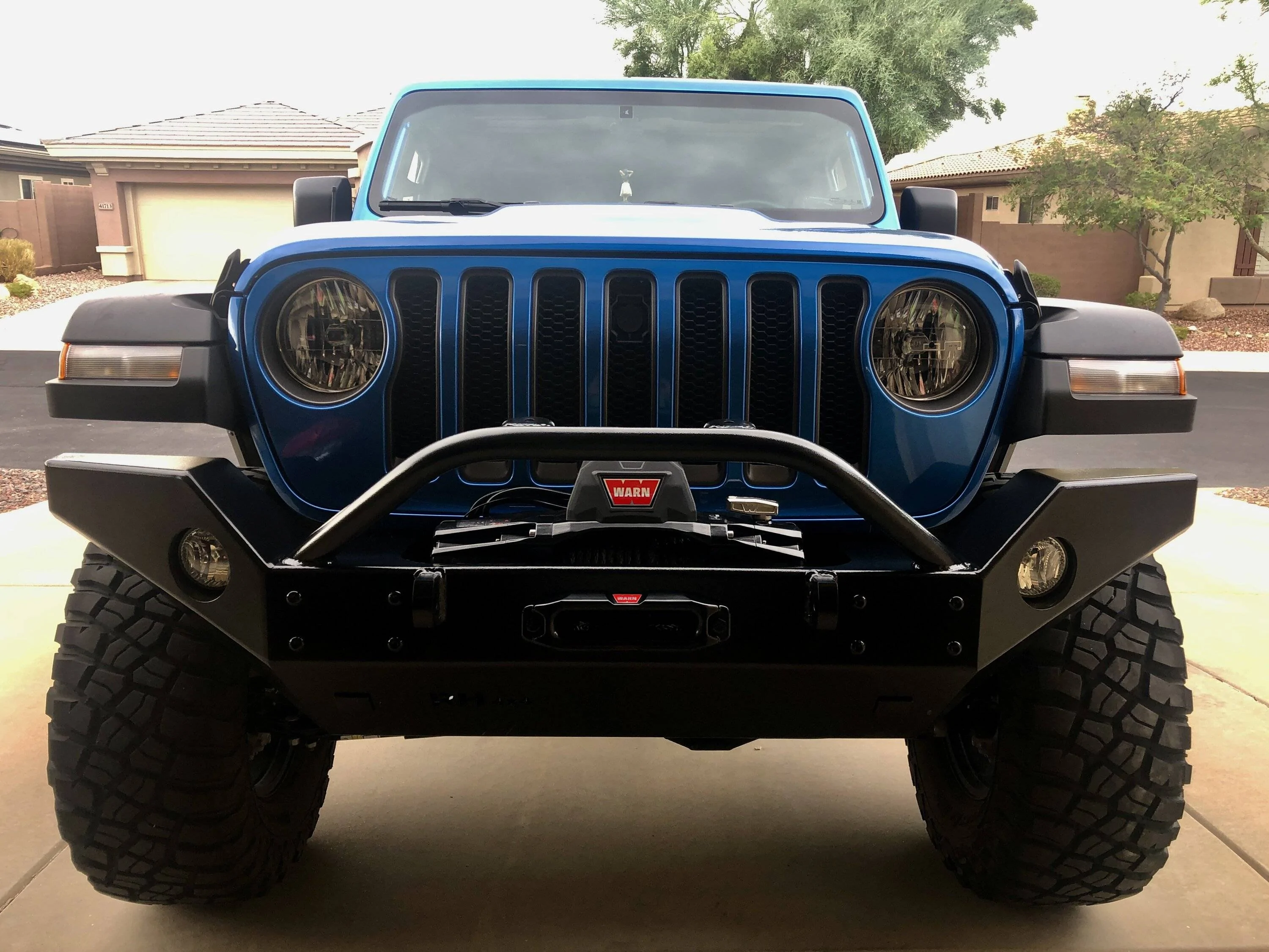

I decided to go with the Rock Hard front and rear aluminum bumpers, I’m towing my JL and not a hard core off roader so went with the full width front bumper with a lowered winch plate, I do plan on doing some off roading.
I will say that the fog lights are now a total waste in my opinion, I believe they are so deep in the bumper that the light pattern is not effective. Jmo

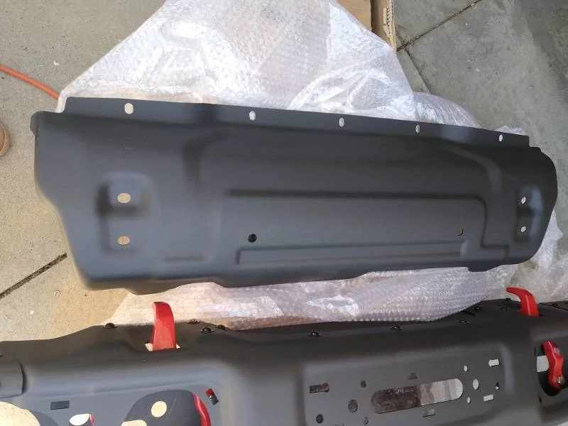

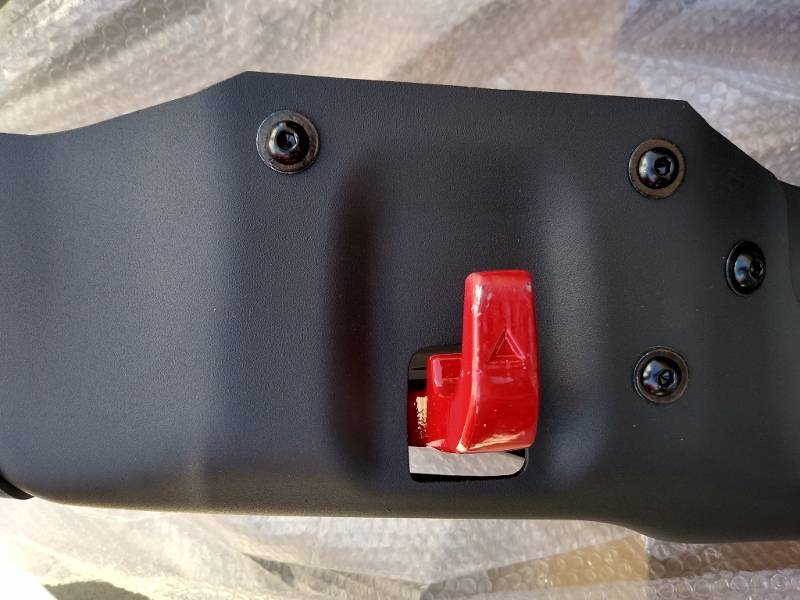

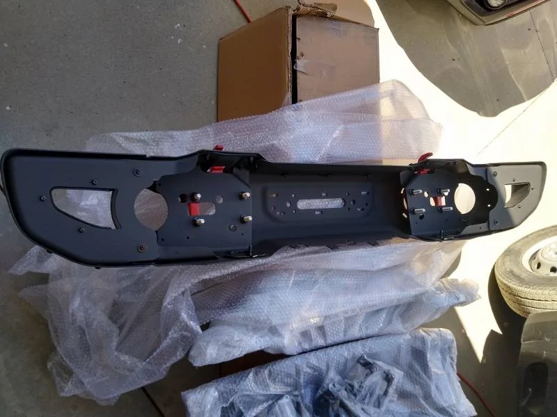

Got freight about lunch time today. Decided to go ahead and start working. MP Concepts bumper, Maximus-3 tow hooks, Barricade 9500 winch with synth rope.
The idea was, try to do a lighter bumper than the Venator we tried before, and a lighter winch. The MP Concepts SAYS it's 41 lbs. shipped. This is not true, the box weighed over 70 lbs. I weighed it in three pieces, the bumper, the skid will all the small parts on top of it, and the winch plate. Bumper was 33, winch plate was 23.2, skid and all the other brackets and bolts was 12.2. That's 68.4 lbs, and it will all mount on the front. The plastic bumper, with all the bolts and brackets removed is a bit over 40 lbs including the plastic skid plate, and the 4 frame tie brackets (replaced with Maximus on one side, and winch plate ties on the other). I'll weigh that when I have room to do it, I have stuff spread all over!
My bumper came with the skid and bumper painted black, not the charcoal/dark silver combo I've seen before. It looks just like the Rubicon bumper. Only shipping damage was one of the red tow hooks had paint rubbed off the tip from pushing a hole into the box. They could certainly do a better job of packing and isolating it, but at least all the pieces were bubble wrapped.
This is it coming out of the box.
This is the bumper unwrapped.
The one scuff on the tow hook.
And one of the bumper and skid plate showing the paint matches.
The install instructions, are not great. In fact, they suck. But there's enough there to give you somewhat of an overview.
The winch plate mostly fits, but it took some tweaking with a grinder, and then I had to cut a couple squares out of the bottom edge on both sides to clear the Maximus brackets.
This is not a simple install, I'm going to have to notch the bumper for those brackets also (same as a Rubicon steel bumper). Will also need to make short notches on the skid.
Fit to the frame horns is difficult. The bolt pattern was just a little narrow, center to center distance was just too small. I had to take the bumper ends apart, enlarge 2 holes on each side of the inner brackets (the outer two holes) where the tow hooks go through. Two holes are larger, and allow room for the bolts to float around, the other two holes are tight, and hold the brackets rigidly. Pain in the ass, takes a bunch of time to take this thing apart and modify things.
But, it all eventually fits, it just wasn't a bolt-on. More of a project. Good news is, it looks decent, and it's lighter than the other bumper we tried.
FYI, the Venator bumper, no matter what they have listed (I think it's 70 lbs) is way heavier. Fedex shipping said 104 lbs total. It's a solid 99 out of the boxes, I weighed all the pieces of that one also. So this is 30 lbs lighter. The Apex Badland, winch only, was 59.5 lbs. With all the other parts in the box, it pushes 70 installed. The Barricade 9500 is 43.4 for the winch, and the other bits (control unit, cables, hook) get it to about 50, so that's another 20 lost. Hoping it drives better with 75 lbs more on the nose, versus the 125 with the last setup (net). I was hoping for less, but the MP bumper is NOT 41 lbs complete. It's MAYBE 41 ish with no winch plate, no winch plate brackets, and no mounting bolts for the brackets.
I'm beginning to think that companies are listing bumper weights with no winch plate or winch plate install parts, even though they include one.
Interesting point on the fog lights. I've had them turned on before while driving, but don't think I've actually needed them to see since switching from stock to the Rock Hard.

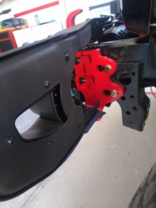

Finished up the whole project today.
This took a lot longer than I thought it would. I had to cut notches in both the bumper, and the skid plate, then dress up the edges and touch them up a little. The Maximus-3 tow hooks added a bit of time to the install.
Jeep Wrangler JL ALUMINUM bumpers ONLY. Let's see them! 002 (600x800)

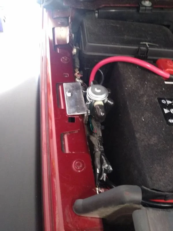

I also installed a Warn solenoid in line, made a little bracket for it. It's bolted into a riv-nut that I had previously installed on the RH side (there's a hex hole for it). Used a spacer under the bracket to level with the fender. There's an extra ground lug for a large cable, and another for small ring terminals right near it (to the rear of the solenoid) and there's an extra lug on the positive terminal at the battery. I pulled the blue wire out of the accessory wire bundle (accessory 4) and wired it to the solenoid control, and ran a ground wire from the fender ground to the other side. I have it set up in the settings menu to be constant on, ignition power, doesn't recall last setting (reset with ignition off).
Jeep Wrangler JL ALUMINUM bumpers ONLY. Let's see them! 005 (600x800)
And, a pic of the whole thing installed. Lot of glare today, hard to get a clear pic. We'd already test driven it at this point, so killed a bunch more grasshoppers with it on a short drive. We are inundated with those things this year. Will have to get another pic when we're out and about.
Jeep Wrangler JL ALUMINUM bumpers ONLY. Let's see them! 004 (800x600)
When it was all done, I hooked a tree strap to one of our trees, drove out in our field and ran the winch cable out to where there was 10 laps on it, set the parking brake partly, and then rewound the winch under load. Should be all set to go now. Works great.
The final tally for weight, was 68.4 lbs for the whole set of parts from the box initially, minus 2.4 lbs of spare brackets and hardware that wasn't used, net bumper weight 66 lbs installed.
The winch was about 50 lbs including the control box, wiring and the solenoid (winch was 43.4, the rest was the other bits).
Maximus-3 brackets were ~10 lbs.
Total installed weight ~126 lbs.
I weighed all the removed bumper parts including the plastic bumper and metal inner, skid plate, top trim piece, bolts and fasteners, plus the 4 frame ties and bolts for those. 43.5 lbs for the whole shebang. I weighed the bumper at 38 lbs last time I did this, the rest is all the extra bits.
So, 126-43.5=82.5 lbs net gain. That's not bad for a bumper and winch, about 43-44 lbs lighter than the Venator full width and Apex Badland setup we tried before. It was 125-126 ish net. I was hoping for a 50+ lb loss, but forgot the extra 10 lbs of Maximus brackets. It's lost 1/4" in the front after driving it and letting it settle, versus the plastic bumper.
It drove fine on the test drive, better than it did with the other combo, so I think we have our final setup here. Better be, that was a whole lot more work getting it all to fit together than I originally thought. We're back to having an insurance policy for running by ourselves again.

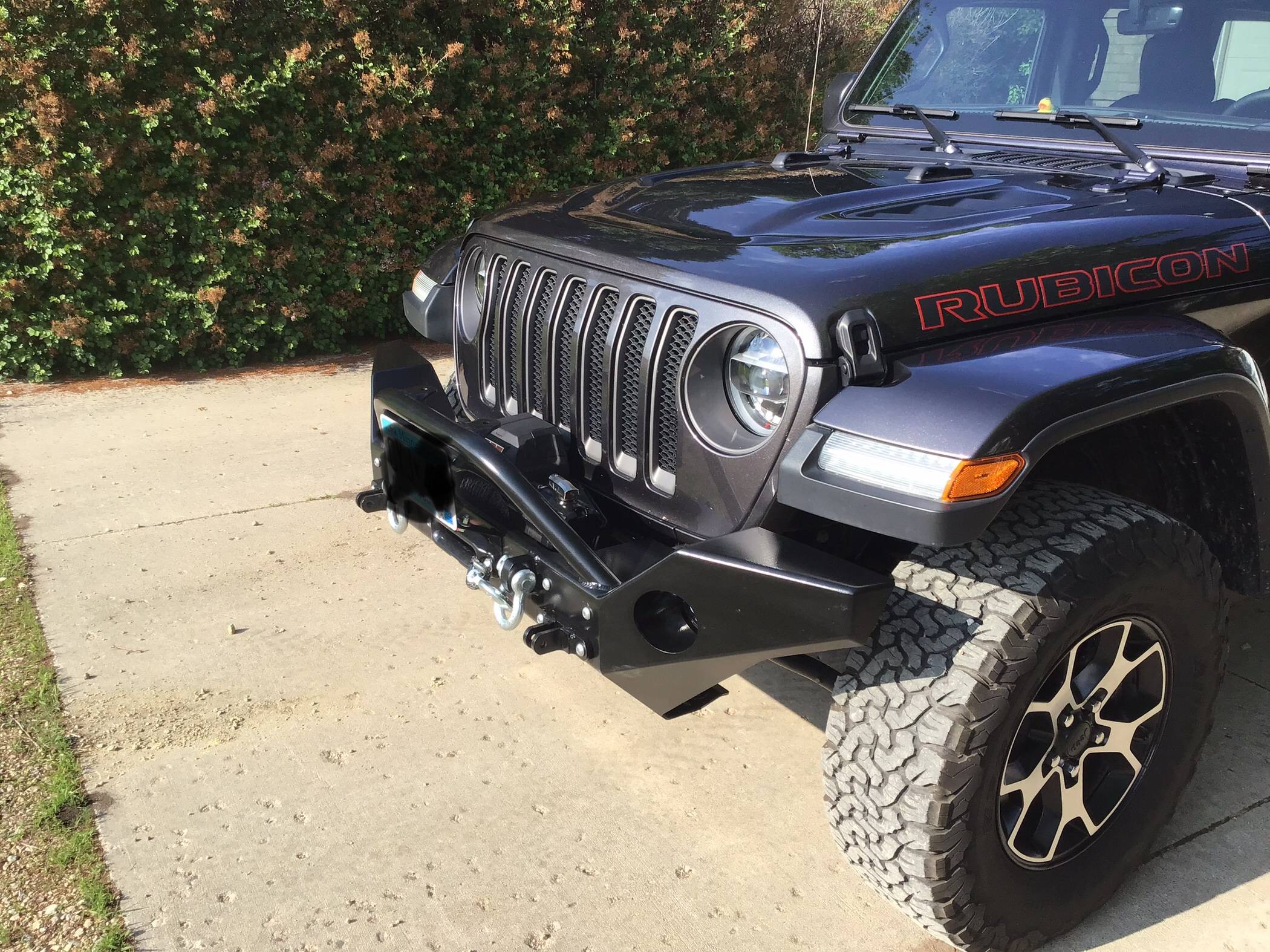

Next Venture Motorsport Feather Weight front bumper (42 lbs including winch plate).
Little bit of grinding needed on the winch plate to get it to fit.
Warn Zeon 10s fits like a glove.
Jeep Wrangler JL ALUMINUM bumpers ONLY. Let's see them! IMG_8784
rubiRI77
rubiRI77
Feb 3, 2021
367
791
scituate, ri
21 Rubicon two door. 2.0 Turbo.
Very Nice!:like: This one was high on my list of possibilities. Very slick looking. The natural finish looks awesome against the granite crystal.
