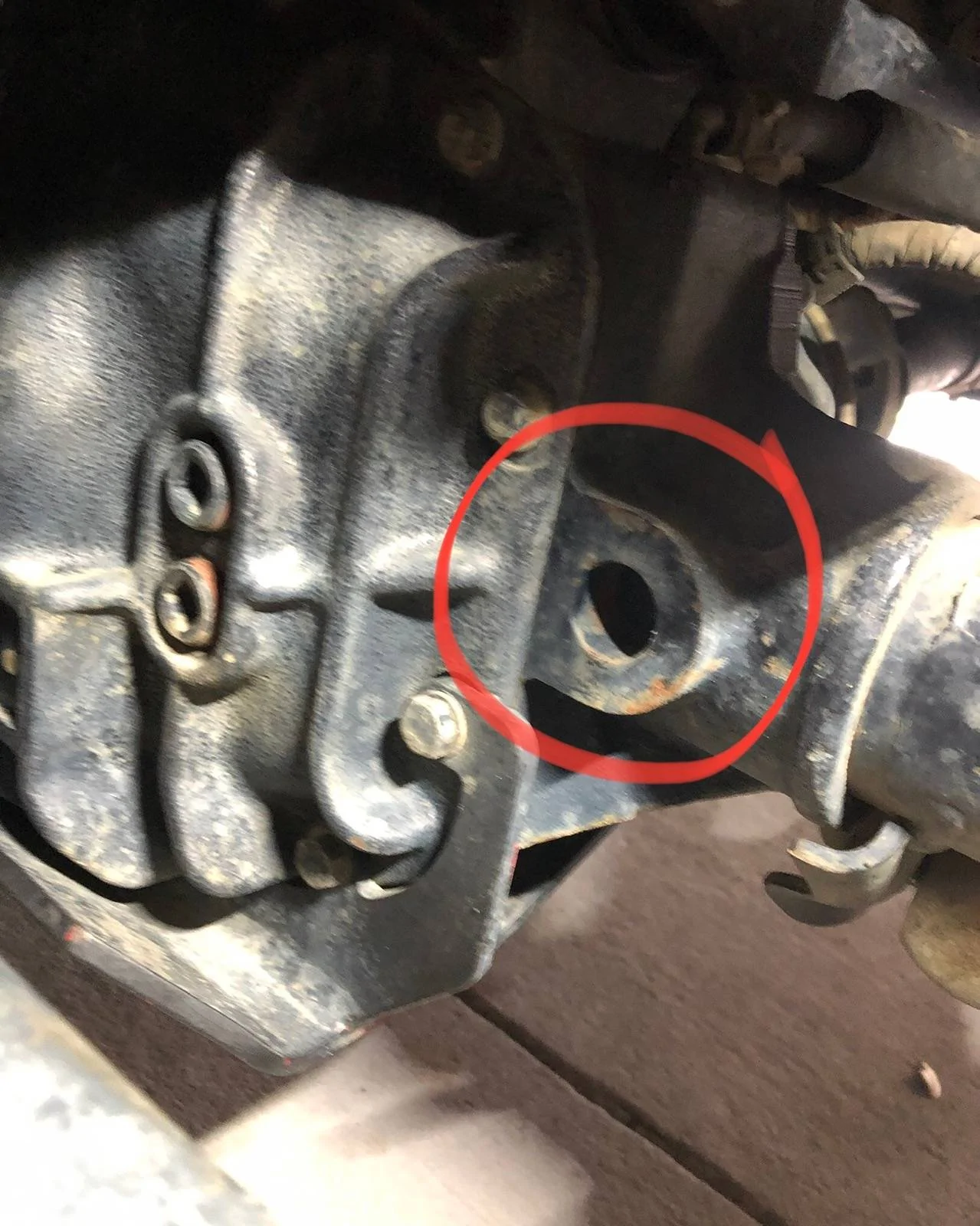

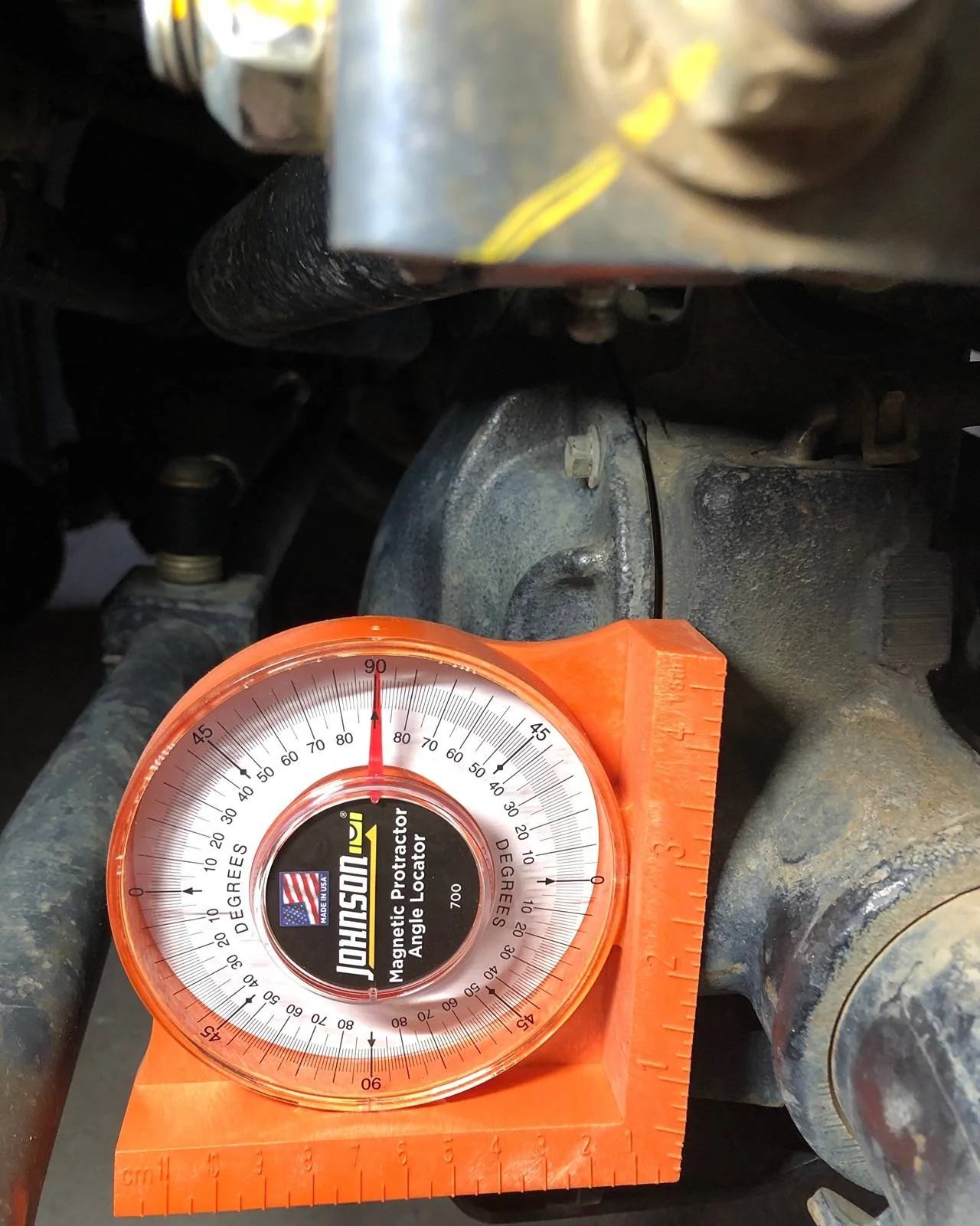

No alignment necessary…… if you want to increase your caster all you have to do is shorten the upper adjustable control arms…. You can check your caster with an angle finder like in pic……( analog or digital )
Jeep Wrangler JL Alignment, or not to alignment. IMG_8363
Jeep Wrangler JL Alignment, or not to alignment. IMG_8361
( make sure your Jeep is on level ground) 90 degrees is 6 degrees of caster….. depending on which side of 90 the needle is determines if you have more or less than 6……..or if you come across a tire shop that gives free alignment checks…. Hate to see you spend 100.00 ish just to see your caster number….✌
Awesome, I will get one of those angle finders, because it sounds like I went the wrong way with the upper control arms.
