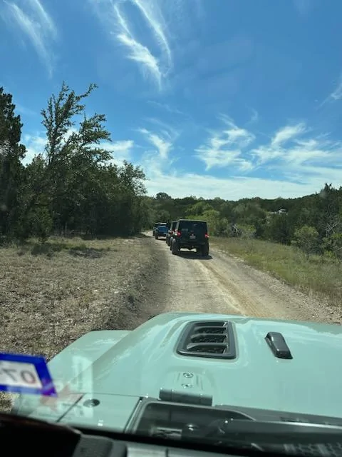

Staun deflators and run the 35 KO2S on stock wheels at 15 when offroading.
We are on an offroading trip right now and I forgot the Stauns so having to air down 1 tire at a time, with the ARB guage, like a peasant.
