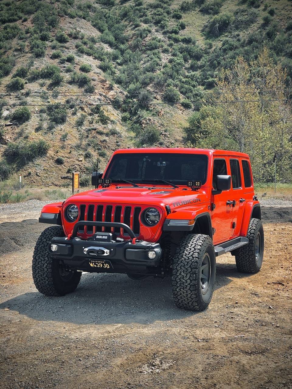

Any increase in ride height on all models will cause the front axle to shift further towards the driver side and the rear axle towards the passenger side. You can clearly see that shift on the red Jeep above, and I'm on my phone not a larger computer or television screen.

It’s needed. You can see the misalignment of David’s axles pretty clearly above.
