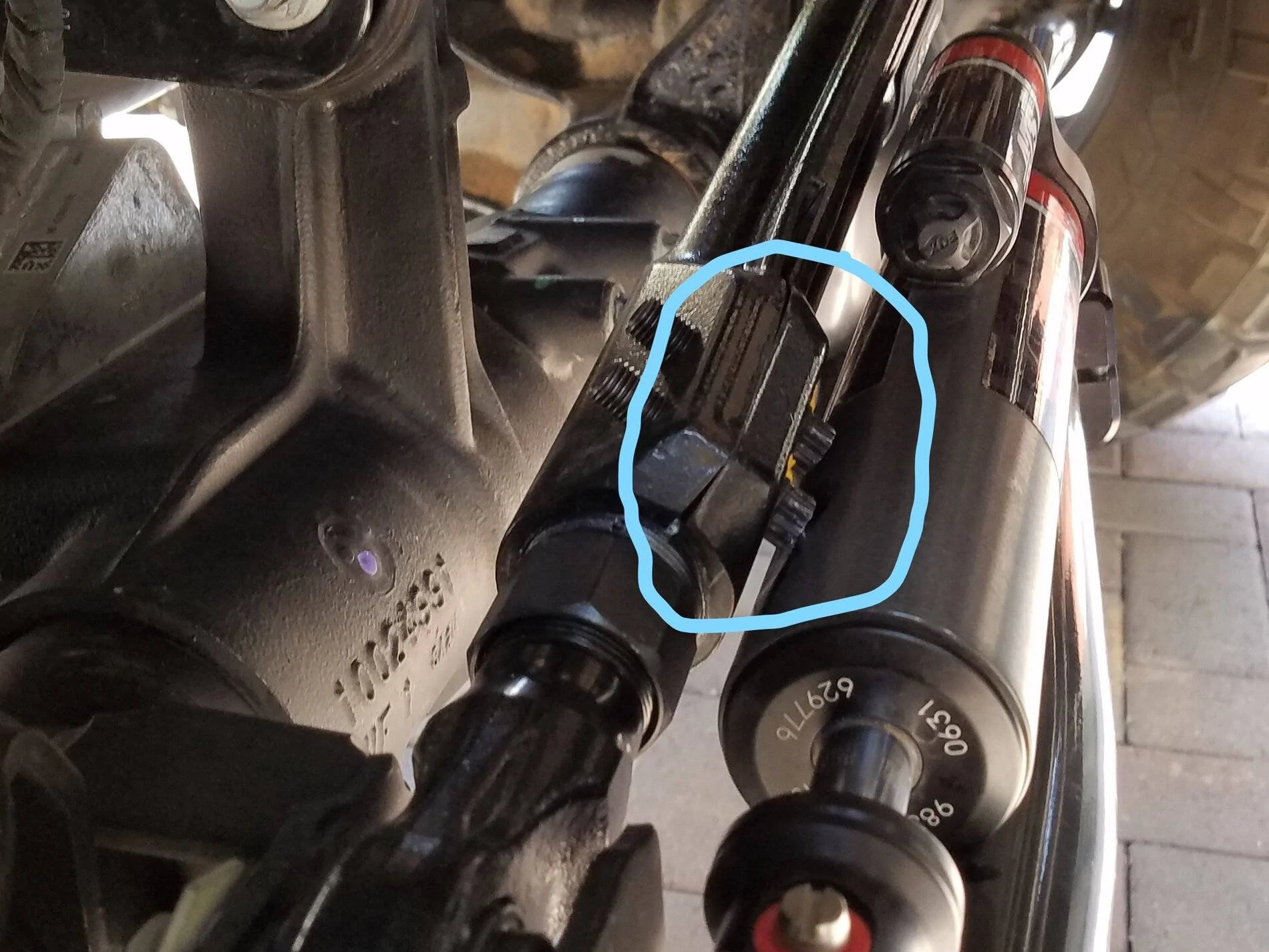

What front adjustable track bar are you running on a JL with a Fox Race Series 2.0 ATS steering stabilizer mounted on the tie rod ? I currently have a Teraflex HD and it is hitting the stabilizer at full passenger turn
Jeep Wrangler JL Which Adjustable Track Bar? Track Bar_LI
. Treaflex's solution is to install their JL / JT Front Track Bar Axle Bracket Kit (2.2-3.5" Lift). And they stated they cannot guarantee you won't have any issues with the Fox stabilizer as we do not test with other manufactures product. Any input would be greatly appreciated.
I can’t see the mounting bracket on the end with adjuster. Can you expand the pic to include it.

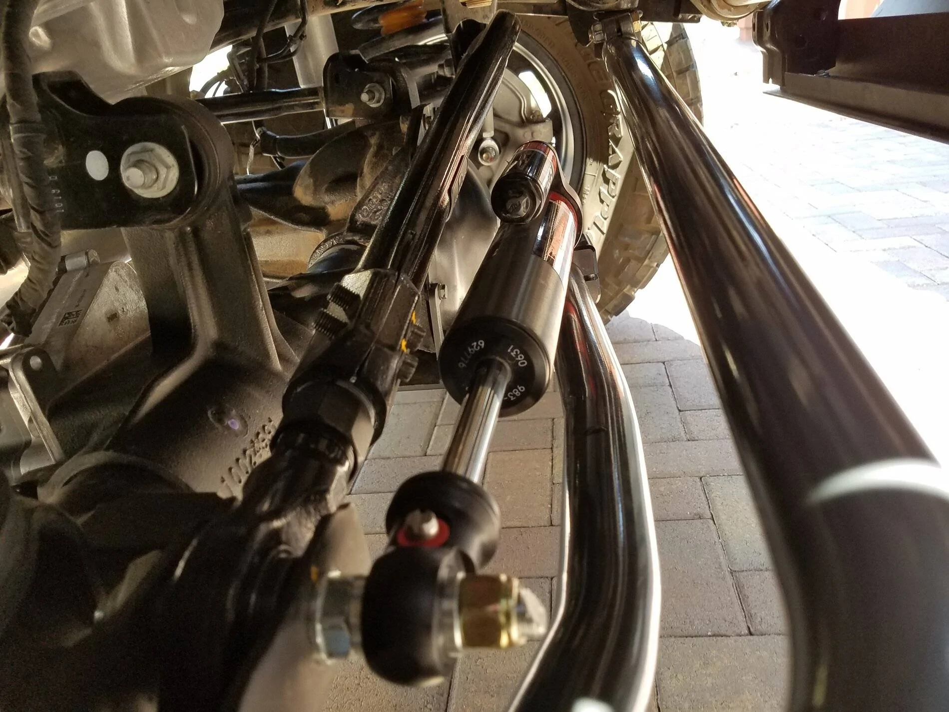

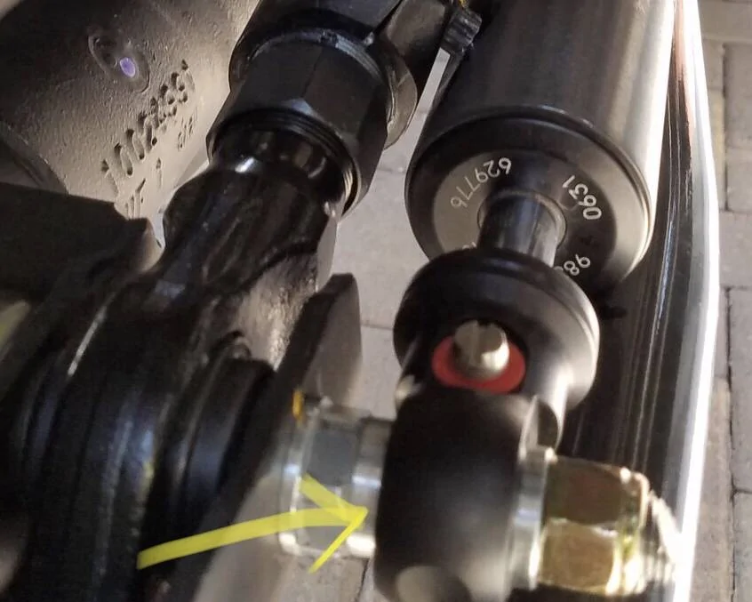

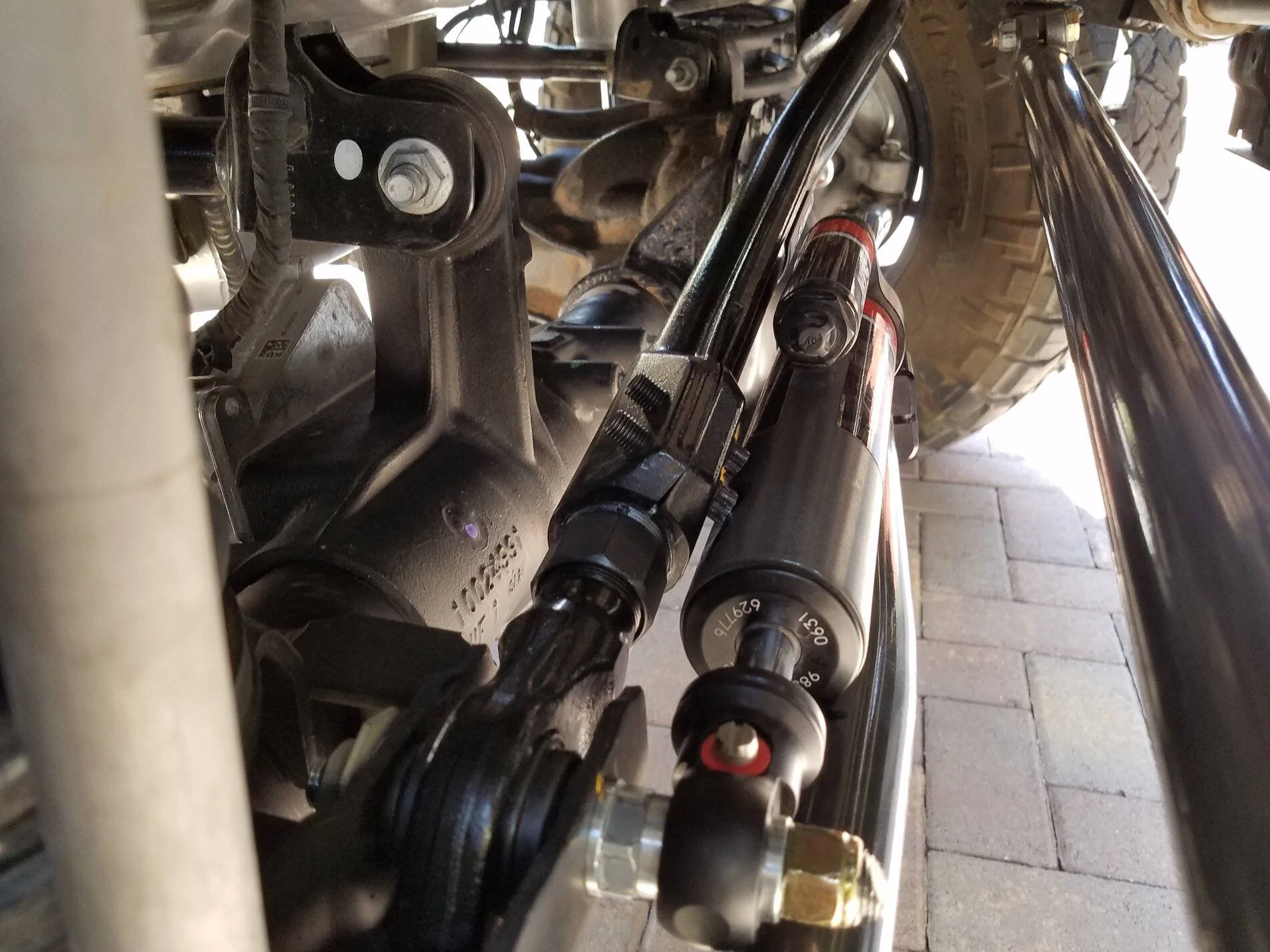

Hope these will work
Yeah, better. Looks like you have enough room on the trackbar bolt to put a couple of washers behind the the shock eyelet and will probably give you some clearance, it’s a cheaper solution, if it’s enough. Also you can adjust your turn stop out a little, that’ll will help too.

Thanks I will give this a go. Bump stops out by 3-washers both sides..
Copy that..... also if you need a little more room, you can swap that nyloc nut out with a regular nut, and use some orange loctite.

Sounds like a plan
Thanks for your help, really appreciate it.
