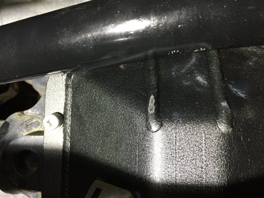

I have metalcloak front and rear and Fox SS, which didn't seem to make a ton of difference outside of the day one placebo. I get a little bump steer wobble on certain road and certain speeds but overall minor with the Mopar lift and 37s. I'd say messing with the caster might be the winning solution but I haven't gotten the interest to buy adjustable LCAs yet.
Jeep Wrangler JL Adjustable track bar for JLU yet? IMG_20180719_114422

I need a new front track-bar too. I have the Rock Krawler 2" x-factor lift which came with an adjustable front track bar but it doesn't clear my Next Venture diff cover :(
We have changed the bend profile on the front track bar since the original design, When we first came out with the track bar, there weren't any aftermarket diff covers to go off of so we went off the measurements of the stock diff cover plus some to account for the size we anticipated for diff covers. Give us a call at the shop and we will take care of you.
