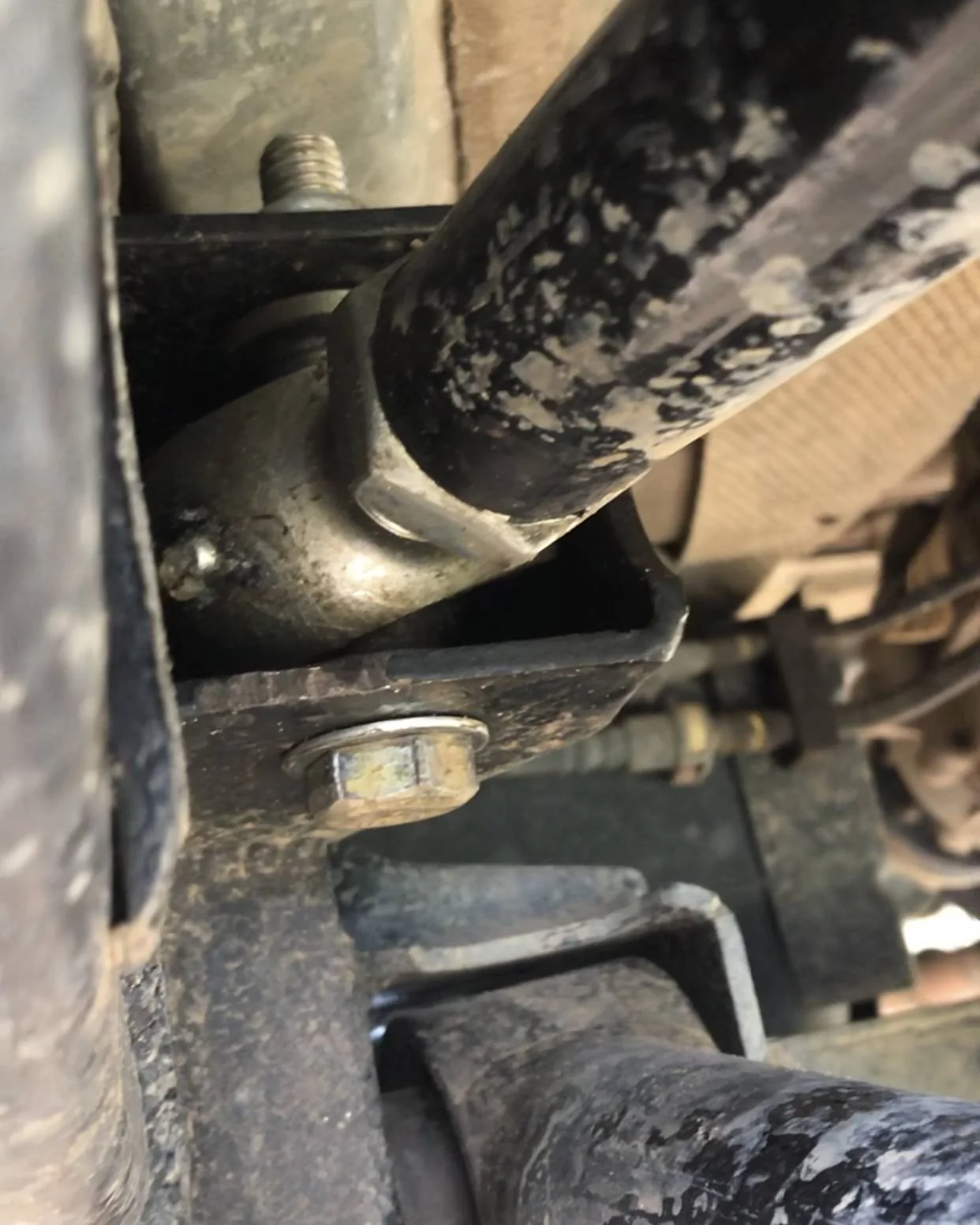

The front upper arms are still oem, Mopar lift only supplies front lowers….. with the amount of articulation that you have with that kit, there’s very little, almost no misalignment in them.
If you’re running long travel shocks however, the uppers misalign quite a bit…..for example, here’s my upper arm at full droop….
Jeep Wrangler JL Adding adjustable upper front control arms worth it? IMG_7876
So unless the frame side bushings are bad, ( axle side bushings aren’t in the arms) or you want to manipulate the axle ( increase wheel base, with maintaining good caster) then you really don’t have to replace them…….I would if it was me, only because that would drive me nuts…….lol.
