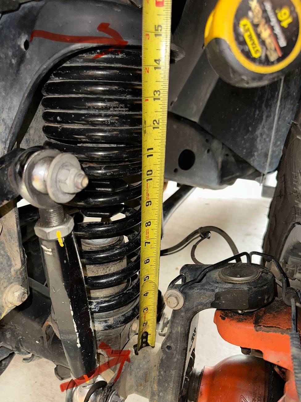

I would definitely do the Mopar lift lcas, but the track bar will be ok providing you only get 2” of lift…. The higher you go the farther the axles will shift…measure between the top of axle tube to lip of top coil housing, or center to center of shock connecting bolts, before and after lift, that will tell you how much lift you actually get…….

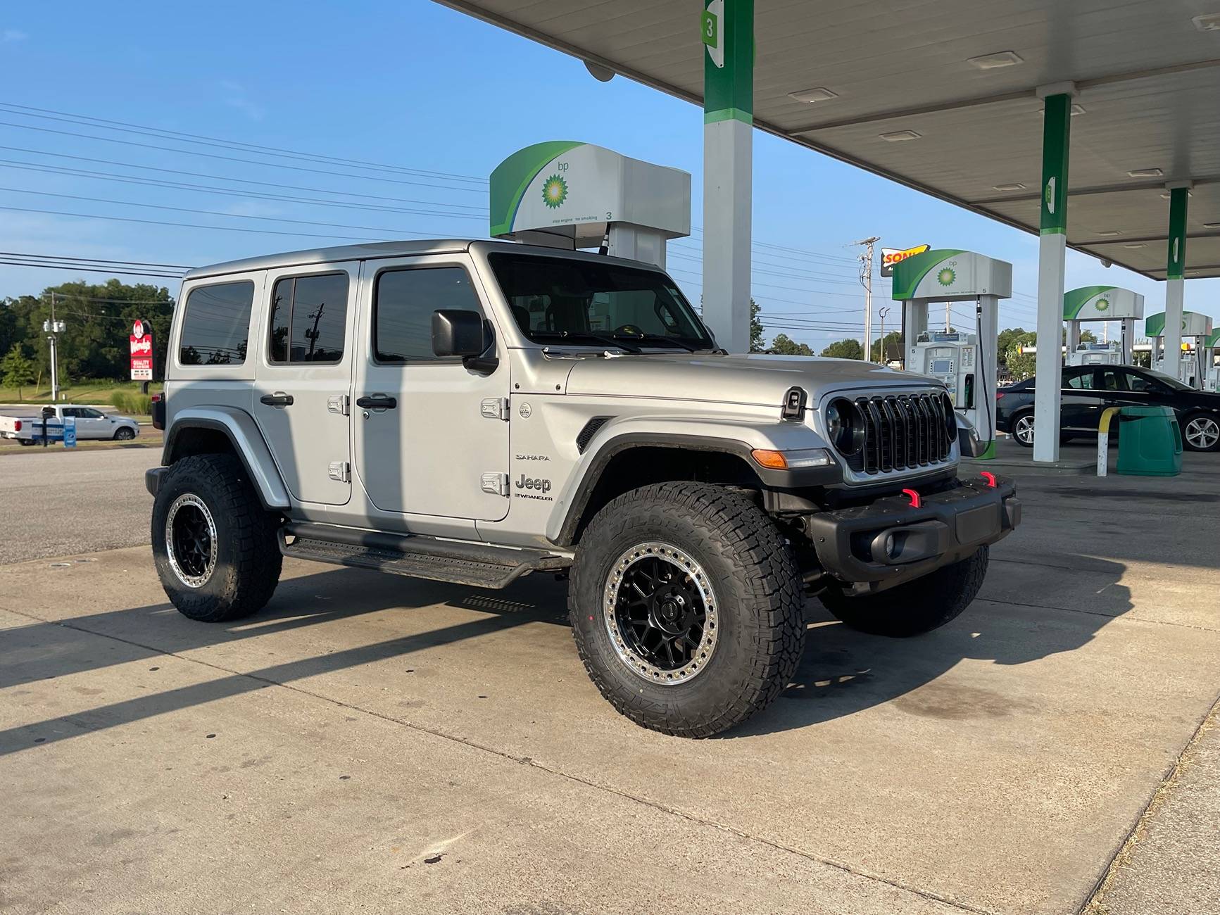

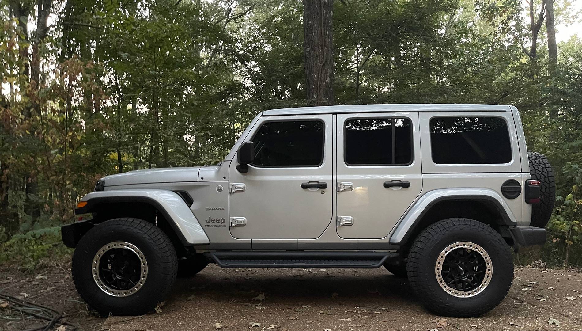

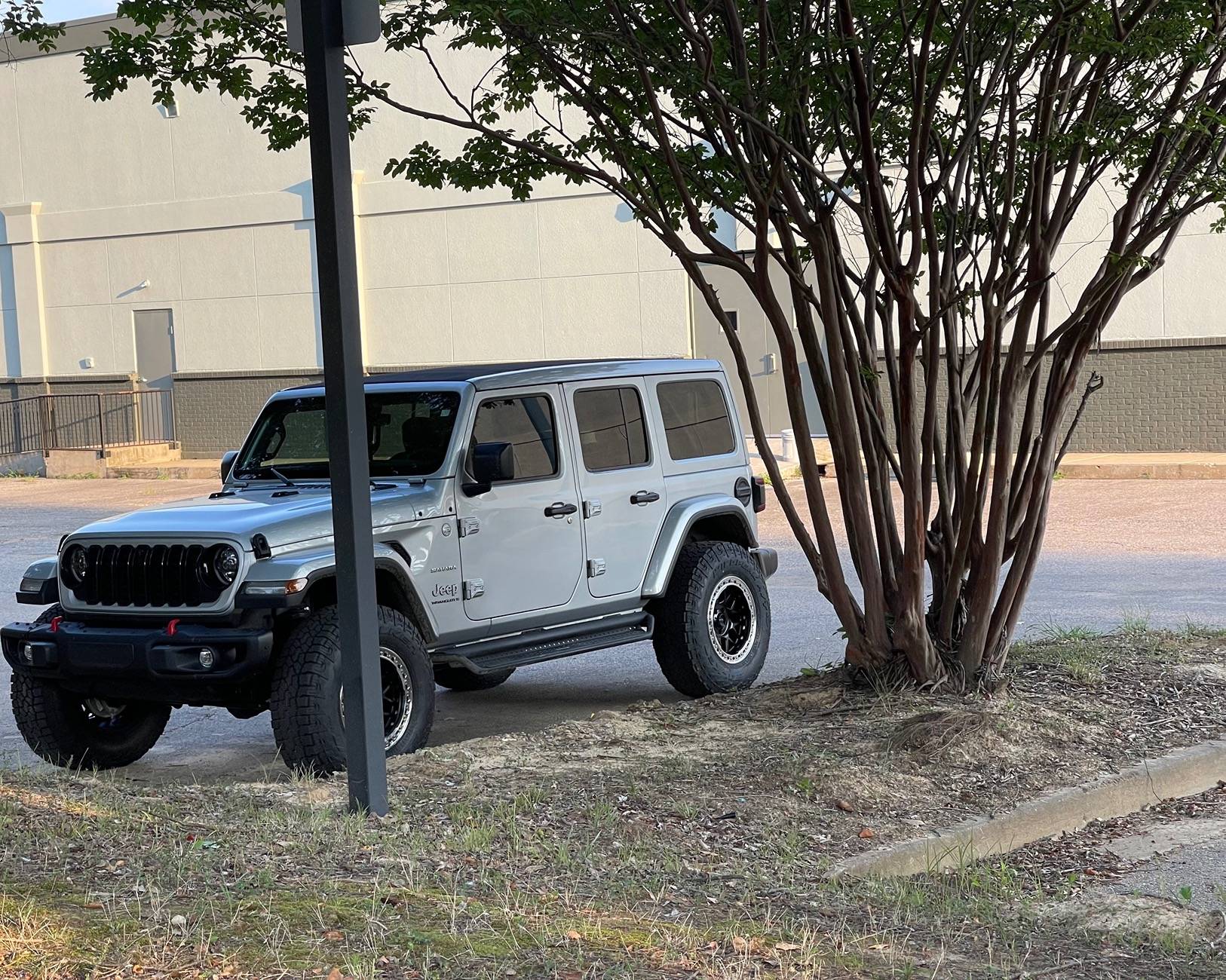

35s with KMC wheels on 2” Dynatrac
- AT4W Falken
- MC trackbar
- Fox steering stablizer
- Fox shocks
- Mopar LCAs

Nice build! Do you like the way it rides? Did you notice a difference after adding lower control arms and track net, or did you do them same time as the aprons and shocks?

Love the feel of it over stock. I once asked that question in this thread and all the Jeep heads told me to get Mopar LCAs and trackbar. Let me tell you they were right. So when I got my lift the LCAs weren’t in yet to be installed so I still had stick to stock. My jeep felt loose idk it was a weird feeling. After the shop installed the trackbar and LCAs everything felt in control again. So I would suggest getting them. It makes steering so much better.
